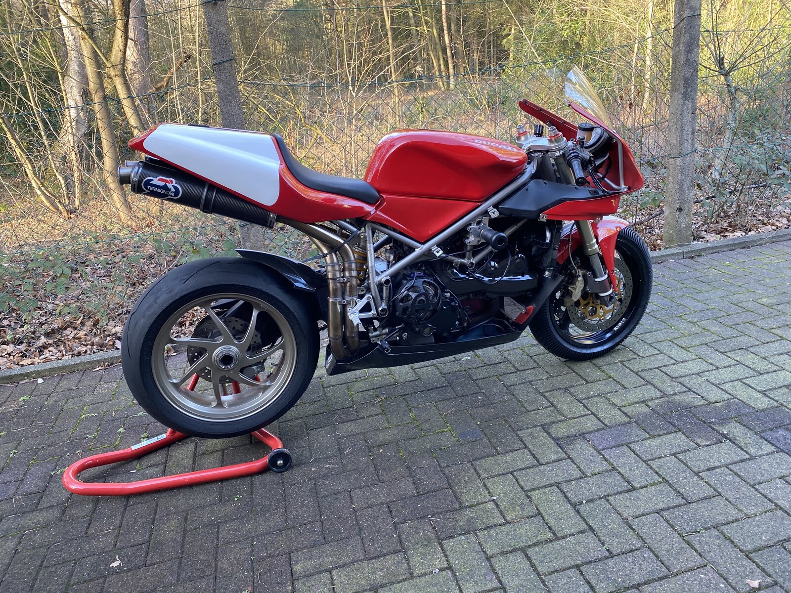

    996 with 1098 conversion

  4. oh yeah... So finally got to master the Microtec ecu amazing bit of kit...we are now up to 166hp and 92 torques...but more importantly the AFR is correct and appropriate.
    If ever you wanted to see just what a difference things make well
    Balancing throttle bodies top of my list first.
    watching the AFR from 12.3 ie rich altered to 13.2 instant horsepower at that point.
    I recon if i had put a treaded tyre on it it would be up to 170...
    yes i understand its just numbers...
  5. With a knobbly tyre would it be over 200 :bucktooth::D
  6. nah...:) but with a slick it overheats on a dyno and then drags the roller back....
    on my other bike i had the opportunity to do a back to back slick v treaded...4hp i shit you not!

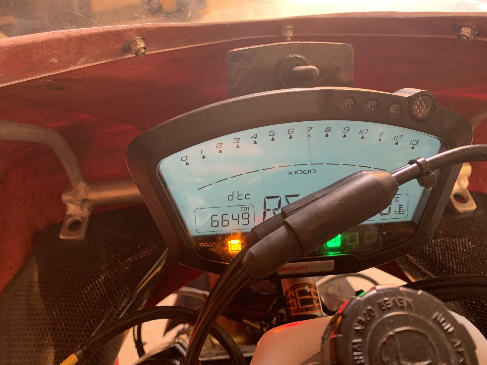

  10. Got bored again.. so had a search around and added DTC to the shitter...
  11. This is just the std 1198 dtc as it was in the loom I used and the dash

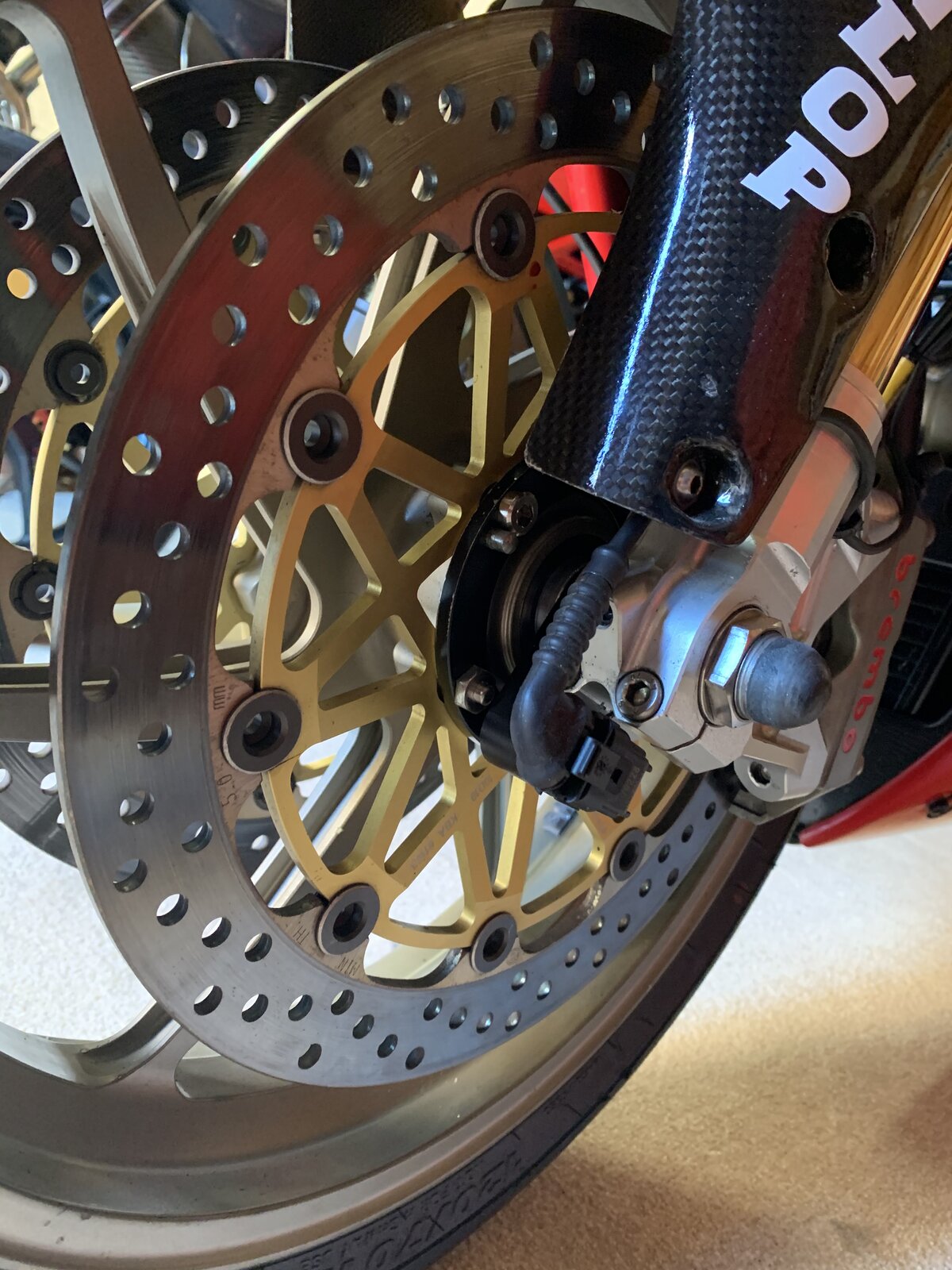

    The main area of faff is the fact the front speed pick up is 6 point off he disc and we were using rt discs so Andy turned a spacer with 6 points and we added tHis in the same way the nemesis system is fitted with a hall sensor pick up the bottom of the left fork bits available from Bikesportdevelopments developments

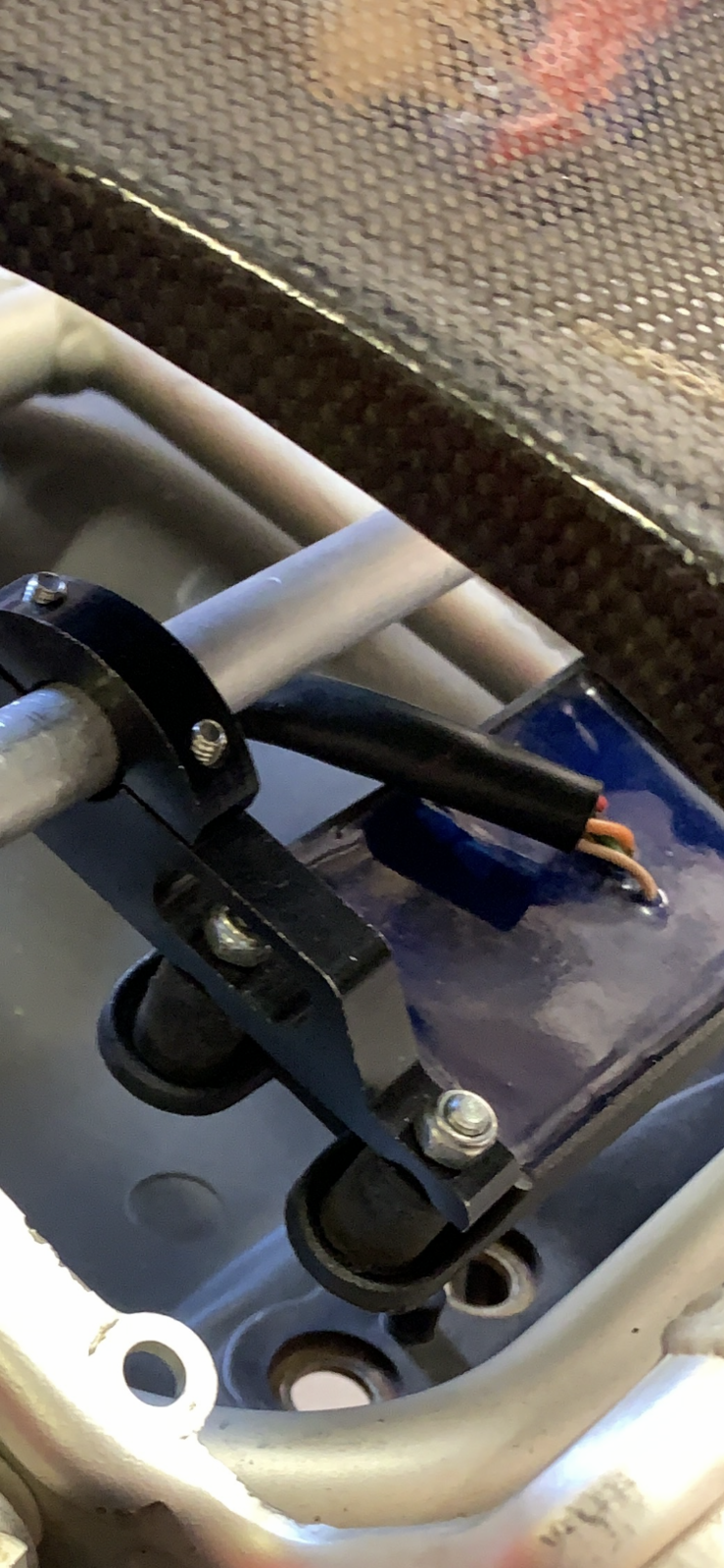

    The dtc gubbins is mounted under the back of the seat

  13. This has an adjustment to get its orientation correct
  14. Because I run the bike On a microtec ecu this works with the dtc but gives me the opportunity to alter the rear wheel measurements because as I’m sure you know dtc is all about accurate wheel speed comparison and in the std 1198 1098r set up means you can’t change the rear tyre size

  18. Can you alter the amount of pickups on the m197, so it can use the 5 disc bolts?
  19. No ....not for the front..6
