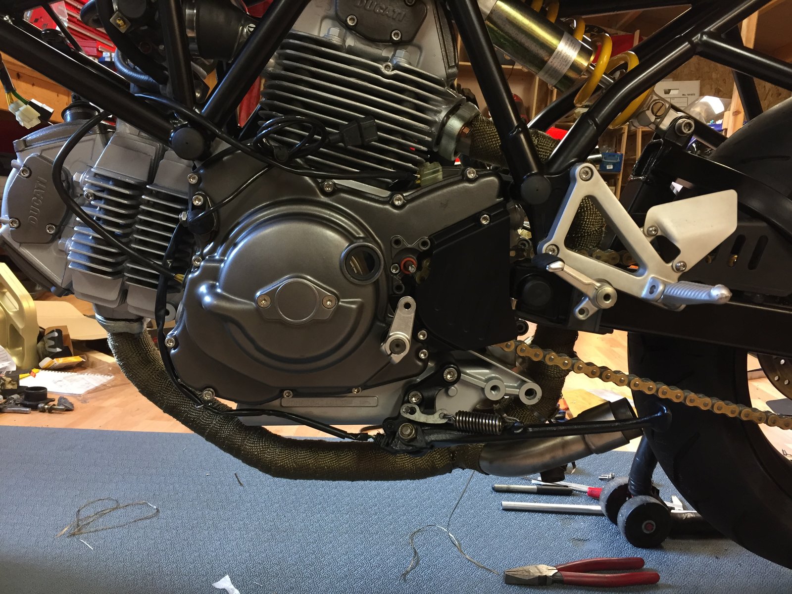

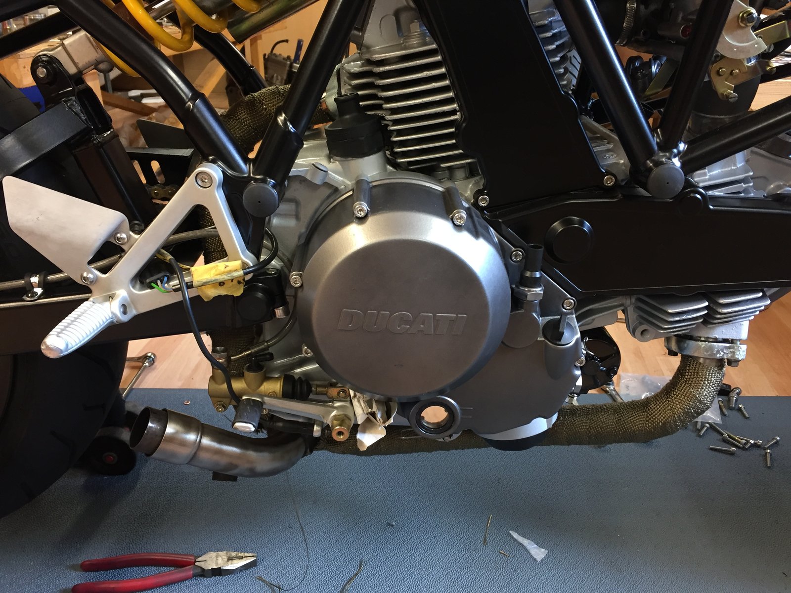

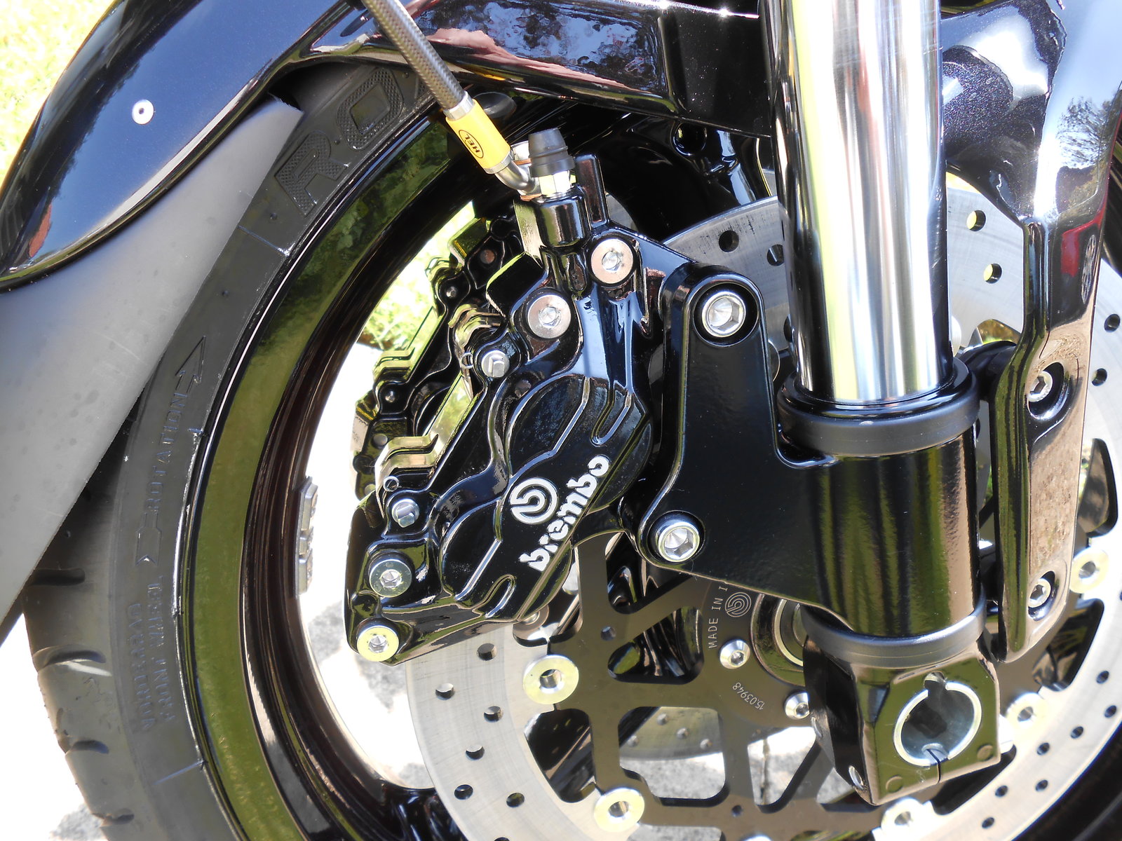

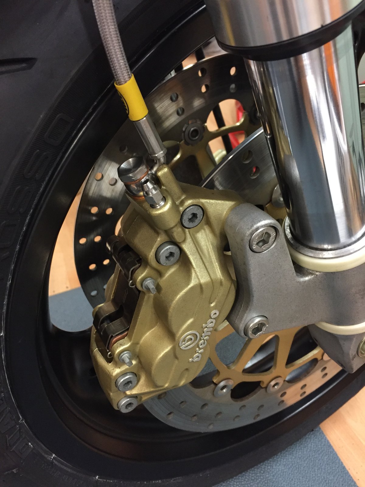

  1. That's both calipers finished now with the new HEL lines, bleed nipples etc. I'm not liking these white plastic front mudguard clips, anyone seen black ones as they wont paint well?
    Gone down the route of this nice exhaust wrap to get that racer look but it isn't easy to wrap it and keep the stuff fixed, will fix the headers with lock wire and hope it stays on but it does have a tendency to shrink back after a bit use causing it to come loose. Next job is to fit the clutch slave cylinder and fit the gear linkage as a reverse change as my race bikes are all this way and too confusing otherwise.

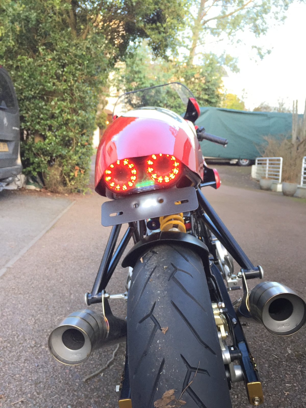

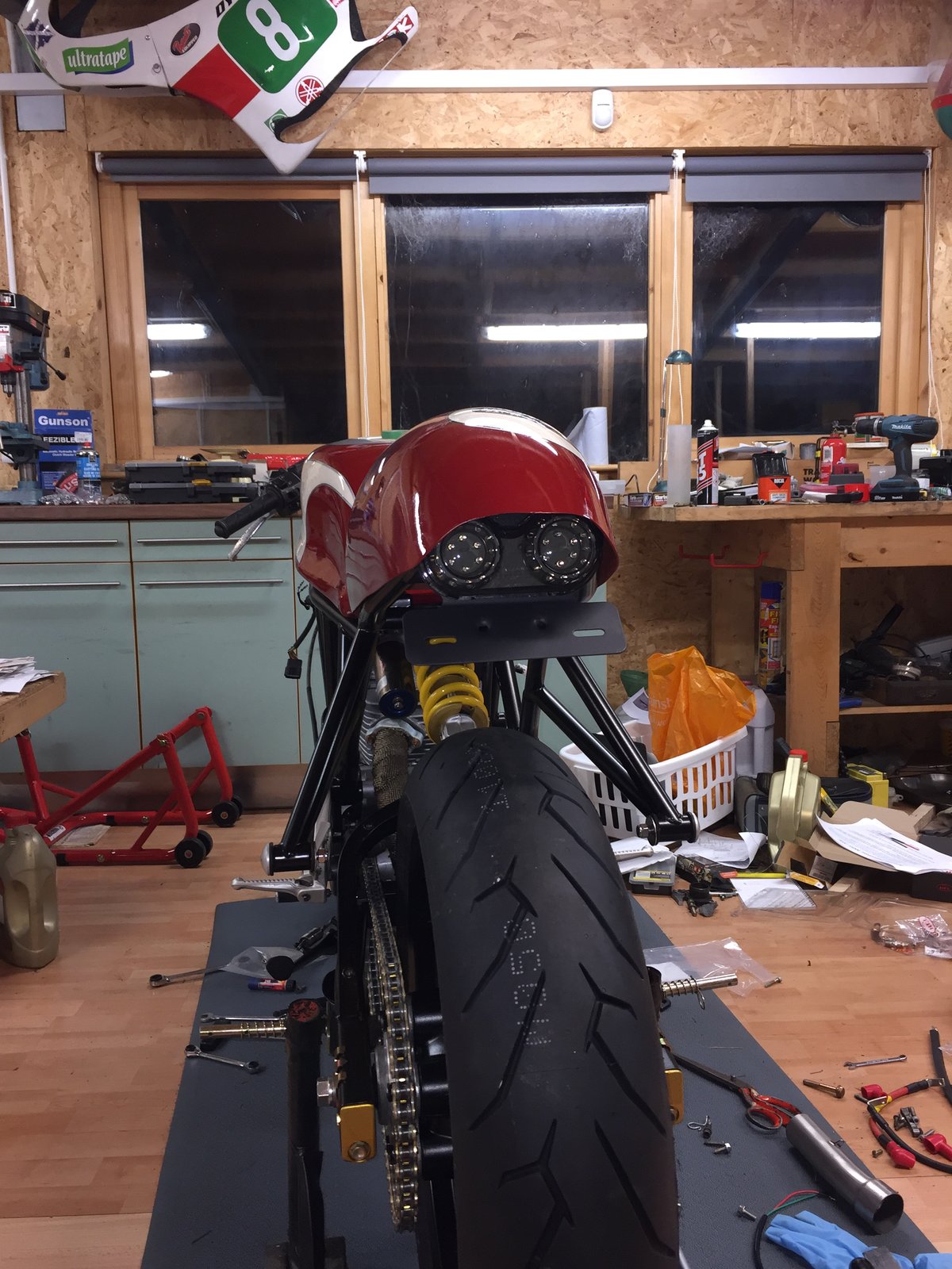

  3. Another couple of hours in the shed this time fitting a rear light. I hope it looks okay as I’ve tried to keep it legal for the mot but hide it at the same time. Having to raise the seat by 10mm which is a pain as lots of other things need to be altered now! Number plates get in the way too. I wonder how small I can get a plate made and is it worth chancing a black plate?
    Reverse linkage fitted now then onto the clutch to finish off all the hydraulics.

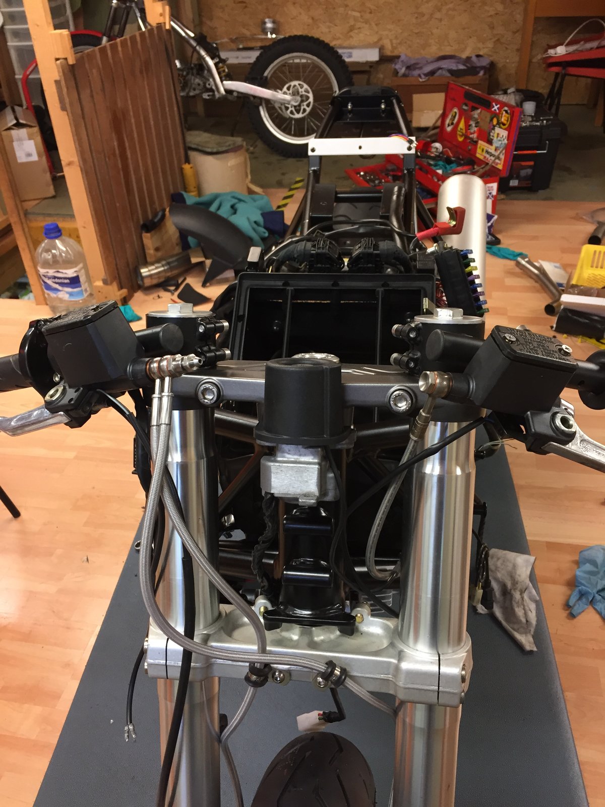

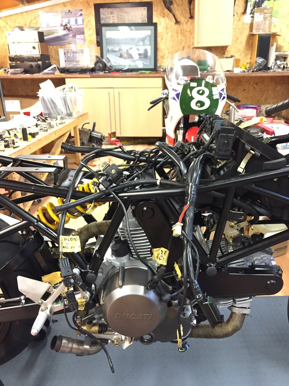

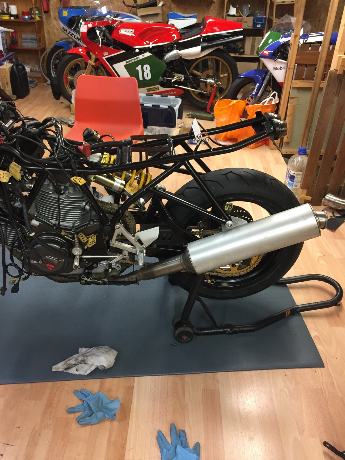

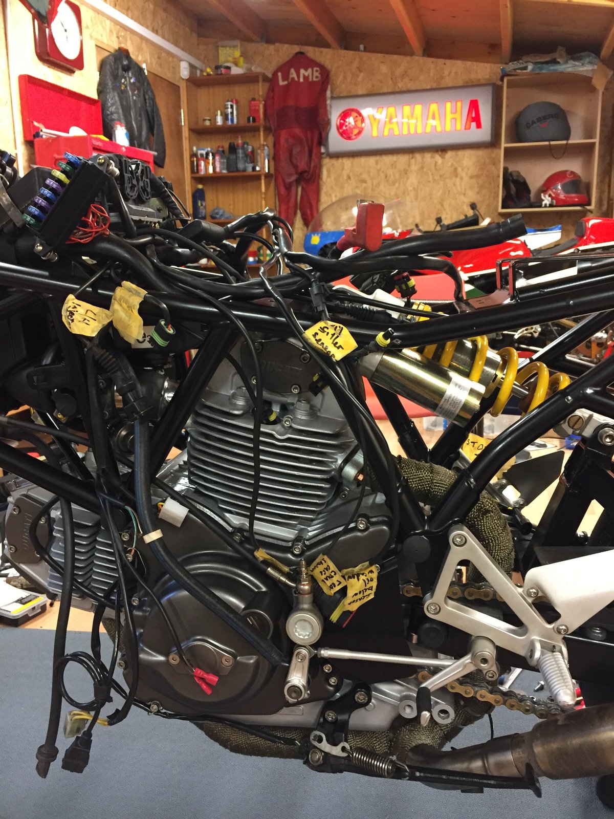

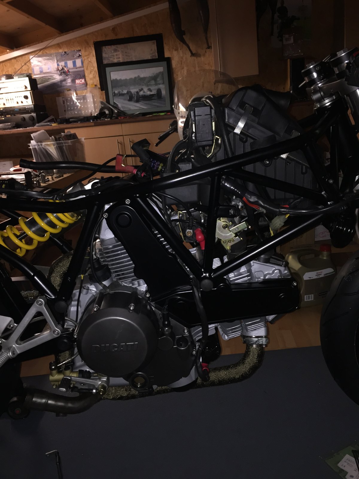

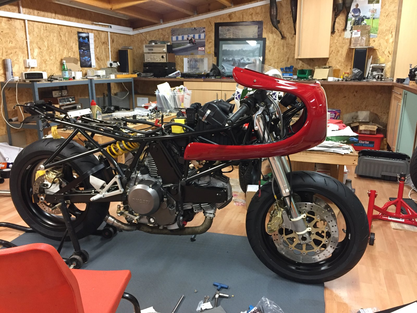

  6. Frustrating day in the shed but I’m cool as beer in hand happyish with my few hours work today. Air box in now so on to the wiring and Stu’s starter cables(they’d better work!)
    All brakes clutch lines now on too. Damned L/h bar switch has broken so anyone have a spare for sale? 19B4529B-1F28-400E-9DA4-1E3B3C3F0337.jpeg C5452B79-1331-4B58-B971-A3A605672901.jpeg 2CC19687-01BE-4FA2-8BB6-5EE1CEC2025B.jpeg 9998E99F-FF15-4E1E-882A-18AE2FE6C798.jpeg

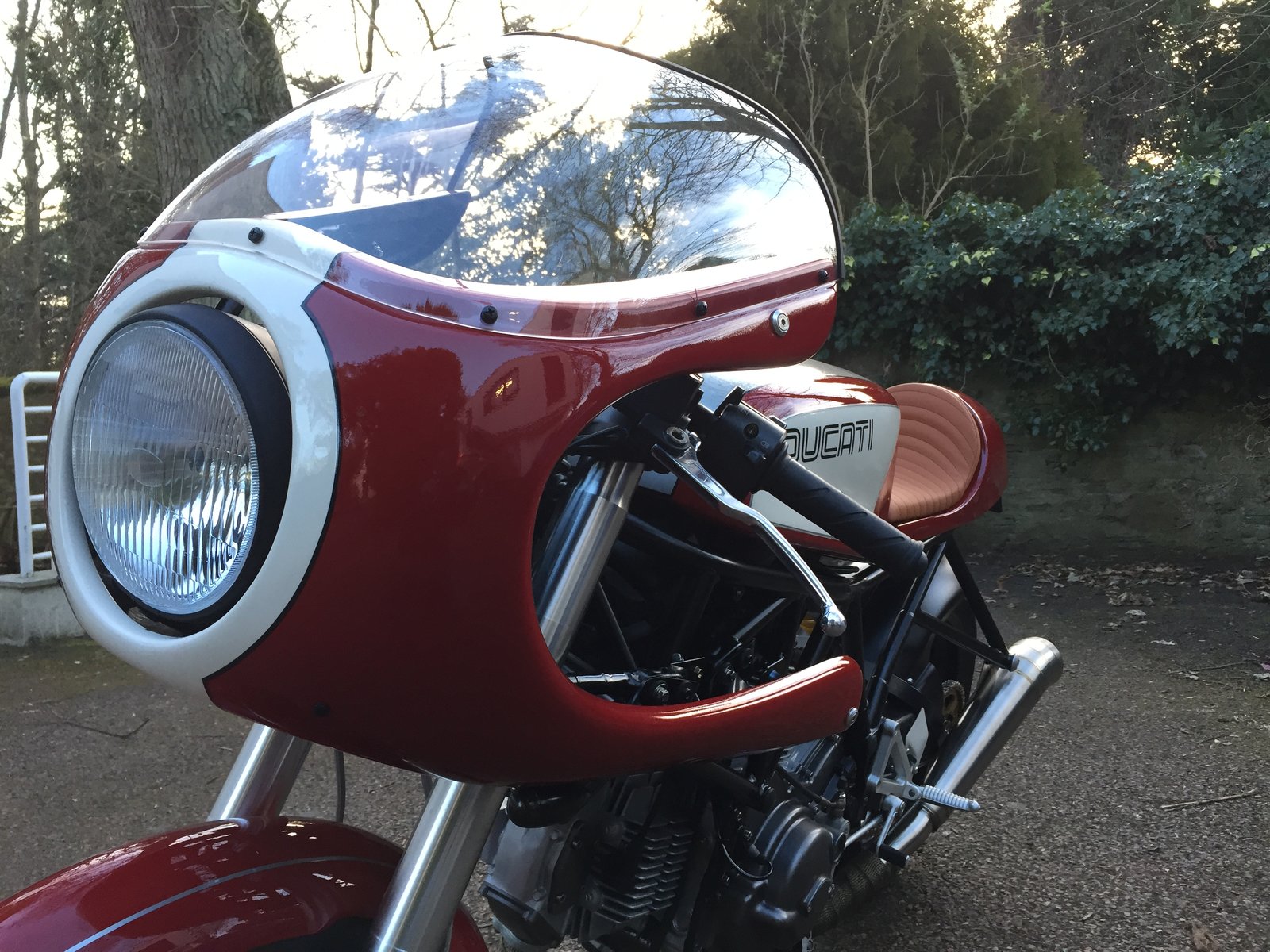

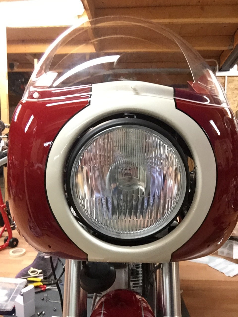

  11. 856CA1AE-9965-4B46-8648-84F1D4688C55.jpeg Got fed up with details so stuck the fairing on to give myself a treat! Wish it was that easy but still a lot of work to fit it properly with the lights etc.

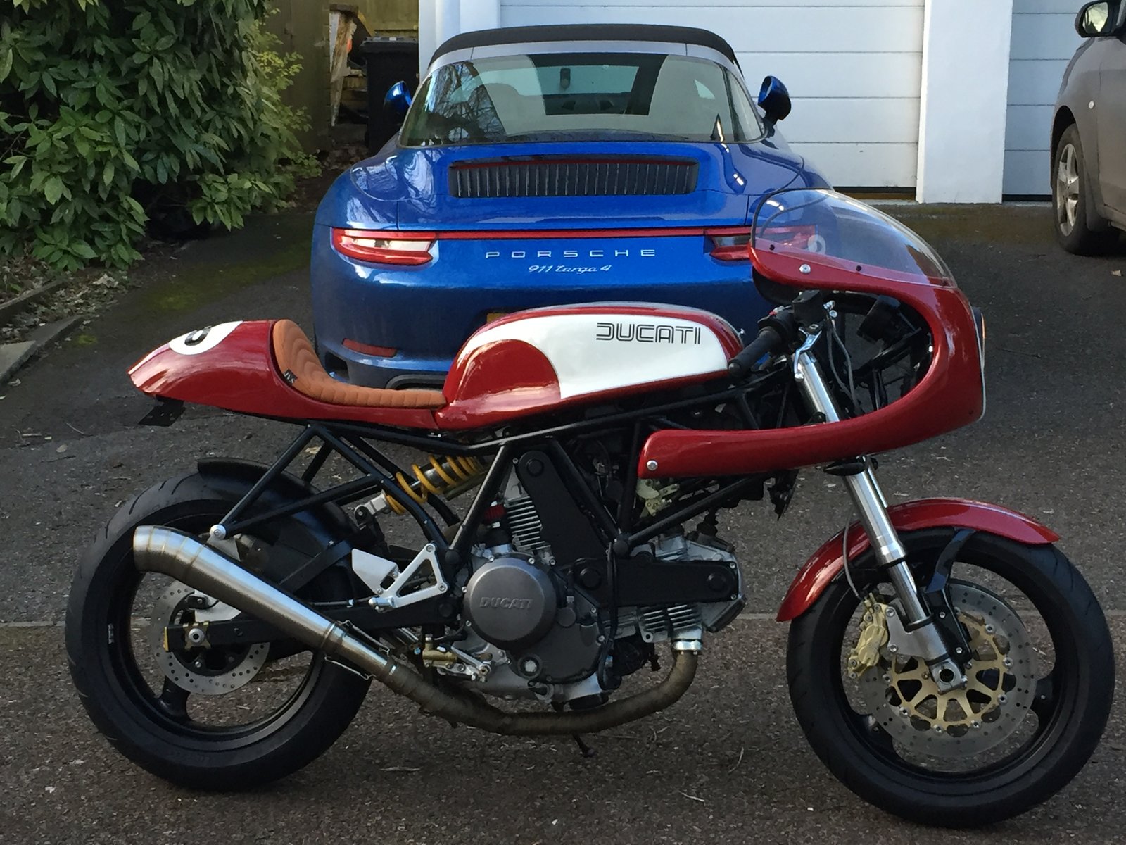

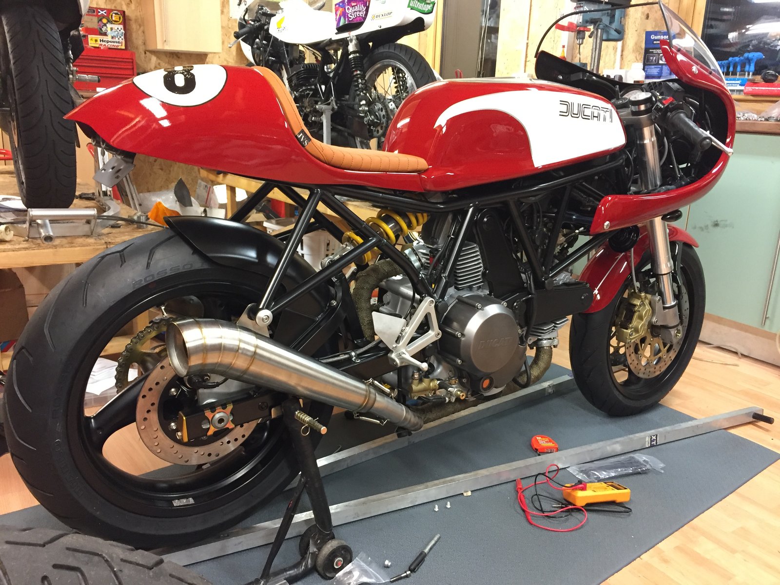

  18. I cant believe it's March now! I finished the bike end of Feb ready for the Scottish bike show but it was cancelled due to snow so hoping to get it there 7/8th April for the new show date. Anyway sorry to break the thread,nothing took that long , but waiting for exhaust parts light etc all takes ages but really happy with the end result. Had a few issues with the running so it's in Ducati Glasgow just now getting a wee tickle. I'm riding it to my wedding end of the month but I'll need to make sure my tackle is well out the way as wearing my kilt!!!

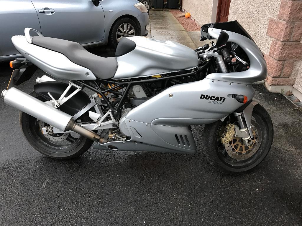

  19. Some more and the original bike, roll on some nice weather!
