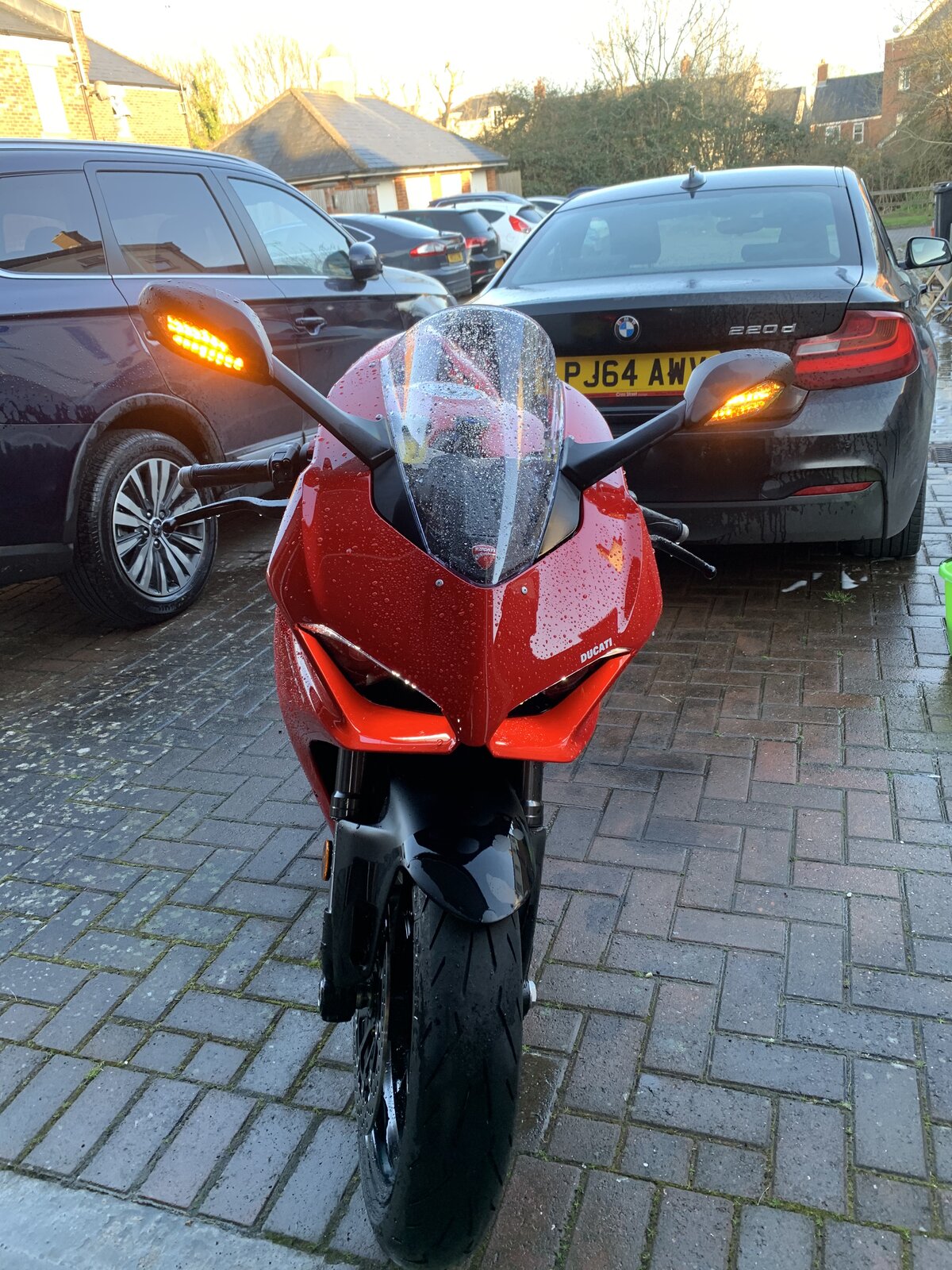

  1. Thanks to both of you for all your help so far, just to be clear when you say they introduced the indicator flash as part of euro5 protocol do you mean the fact that they come on and stay on to indicate a fault? As that’s what happens but this time without ignition on (I realise the can bus will also stay live) and they flashed at random intervals before staying on. Previously they would all come on together at a very specific time after ignition switch on, and go off with the ignition. So the behaviour is now different
  2. So much for the supplying dealer not being able to replicate the fault then :joy::sob: Andy
  3. this is my thinking, if Euro5 really has added a load of standardisation and protocol stuff then surely they will have been able to check it. If they even looked at it....
  4. No. It’s not new to Euro 5....it’s been around for a while now. Pre euro 4 in some cases that employ a full, proper CanBus arrangement.

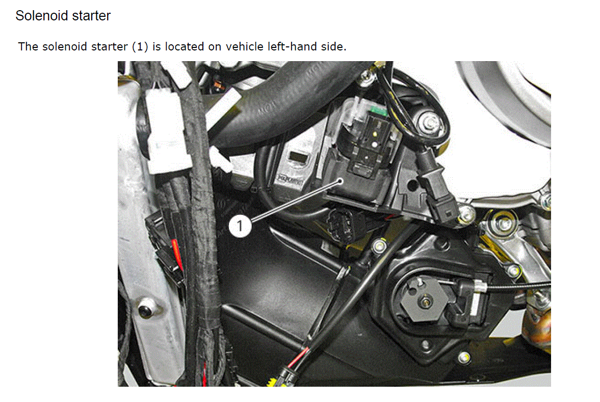

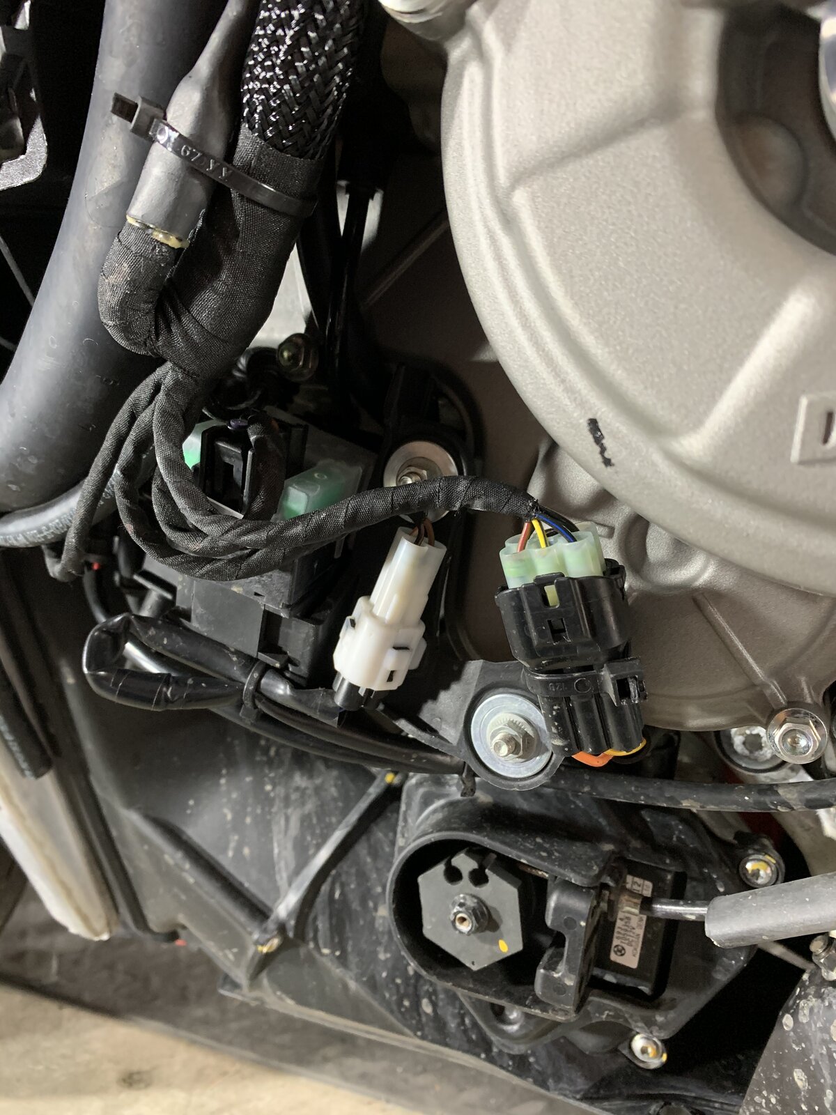

  11. What’s this guys? Is it the main starter solenoid?
  12. The little box looking thing with the green fuses? That looks it to me mate.
    (Taken from a 959 Workshop Manual)
  13. That's it, thought it might be the starter solenoid due to the size of the feeds and shielding etc.

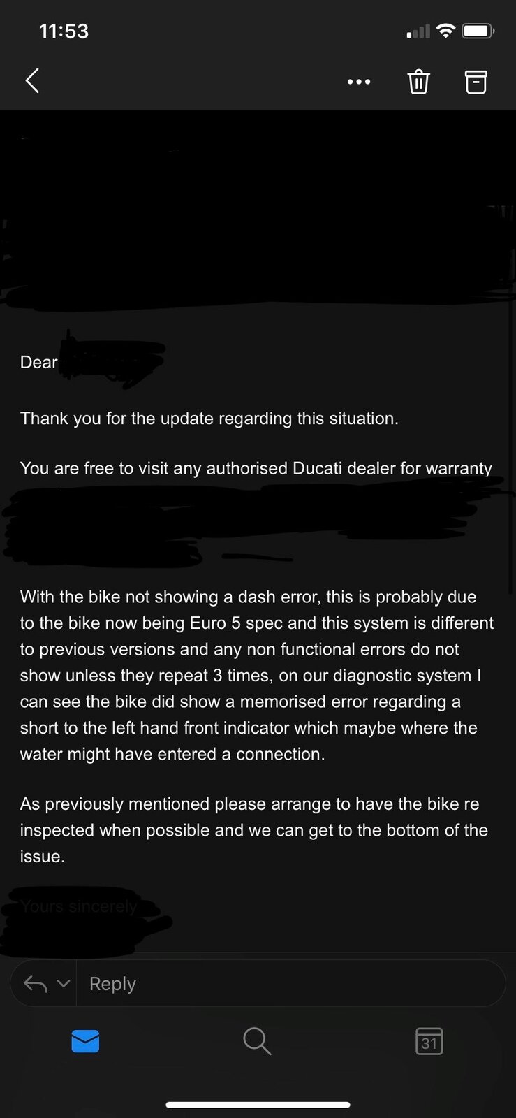

  14. So here is the latest reply from Ducati, it looks like the bike did record an issue with the left hand front indicator, which begs the question why did the dealer not strip this down and investigate it?
    Also, I disconnected the front left indicator, and the right one, and the rear all independently to see if one of them was shorting and causing the issue but they all stayed on when I did this. I guess I'll have to get it to a dealer and at least there is 'some' record of the fault existing and I'm not just totally trying to convince Ducati there is a problem that they can't see.
    Would appreciate your thoughts. @nelly and @Mr. Faffington you really have been incredible and I really appreciate it! I love Ducati's, I'm a passionate owner and not naive to the fact I bought something with more temperament than a Jap bike but just want to get to the bottom of the issue.
  15. The info you have is correct in that there is now a counter system with in Euro 5 whereby unless an error repeats it won’t indicate on the dash. It can be read out with diagnostics though. If there is an issue with an indicator, this could be further confusing things with regards to it being a can issue as previously discussed? Also, by disconnecting components you could be generating more errors, that would only compound the issue when trying to diagnose......
    You’re not going to get to the bottom of it until you can the bike into a workshop and read out tbh.

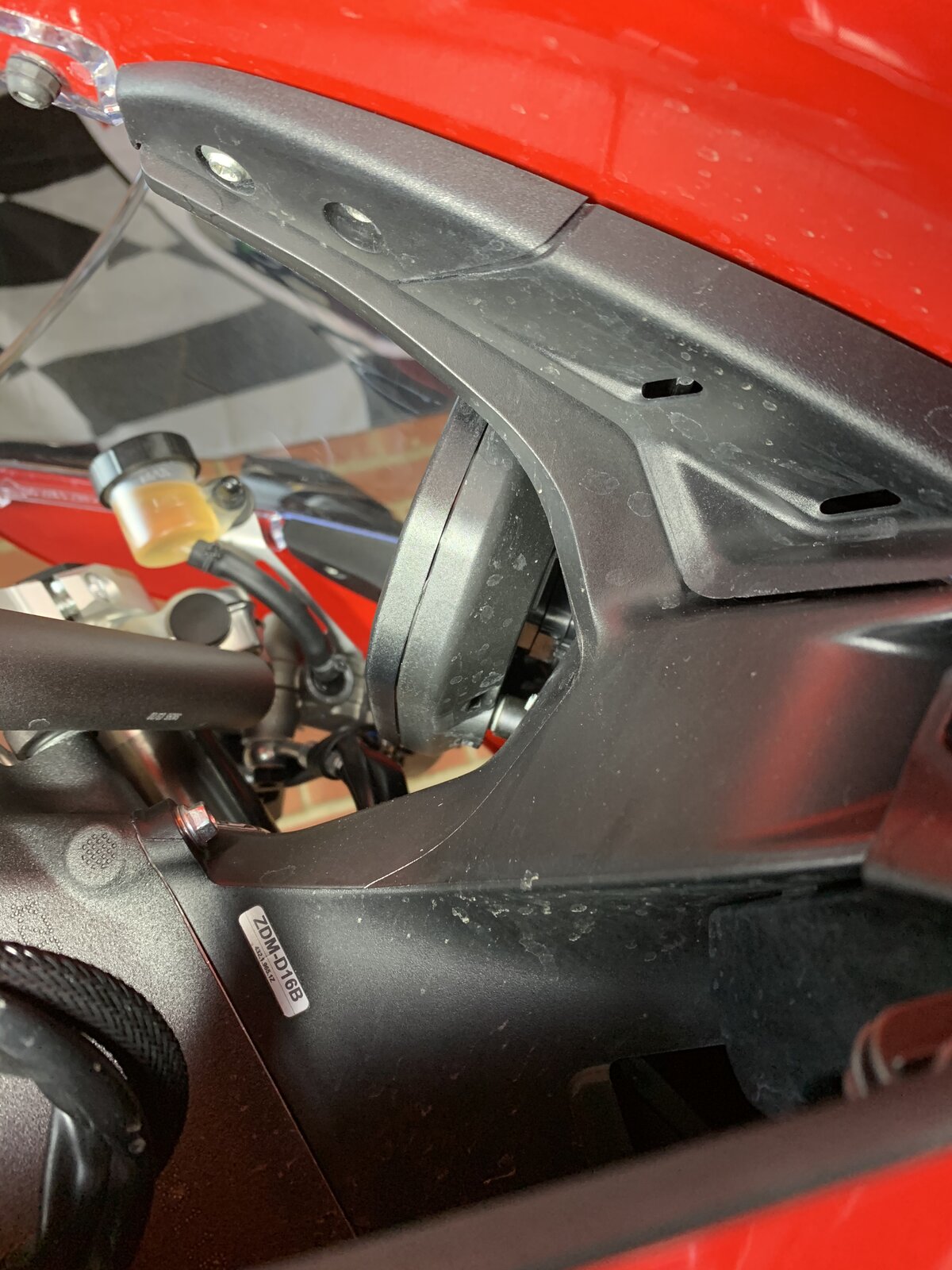

    I checked the indicators again just for pinched or damaged wires, they look fine, the only thing that’s playing on my mind is that the dash connector just doesn’t look pushed all the way home. It could well be but I’m not sure why they would leave that much exposed Male connector? Sorry you have to zoom in, and I’m really clutching at straws here!
  17. Looks ok. Easy to check with fairing off if you’ve got 20 minutes to kill ;)
  18. I somehow doubt it's the dash connector as the plug on the loom has a tab on it that locks/clicks into place when inserted and has to be depressed to release the connector block from the back of the instrument panel, so it's hard to see how it could have backed out without you losing feed to the unit, which would be immediately obvious. There is also a peripheral rubber seal on the connector plug to add an element of weatherproofing, further preventing any issues. It does sound as if you have potentially some water ingress issues or another short in the wiring. Have you checked the LH switchgear for any residual moisture?
