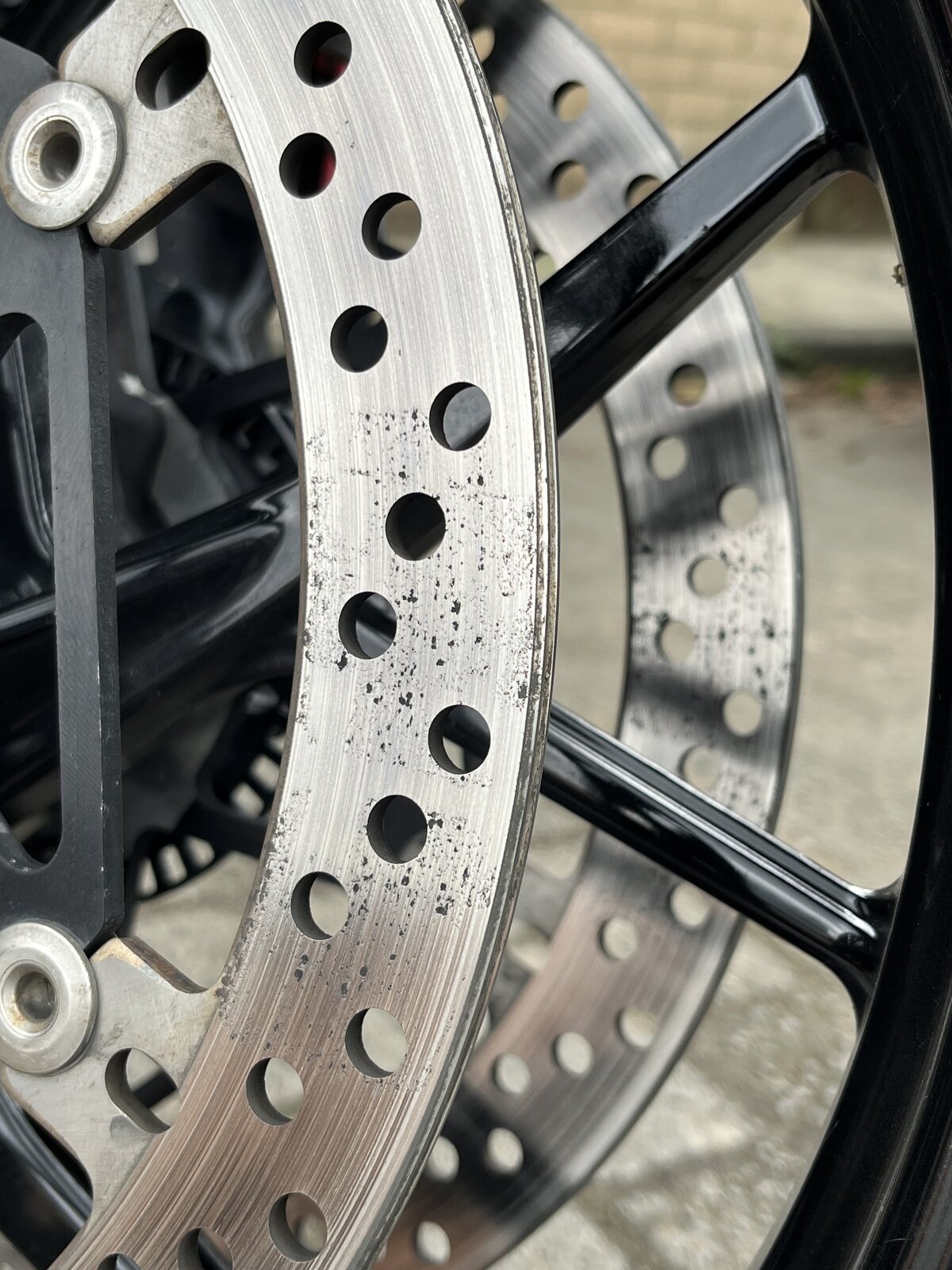

  11. Had a closer look at the discs
    Weird sort of pitting, tried cleaning with green scrubbers and brake cleaner. Definitely pad sized marks.
  12. Looks like corrosion that tends to start behind the pads when put away wet, or salty. It’s actually very small pitting that will only machine out mechanically. Could be enough to put a surging effect into the low speed stopping. To prove a point, remove 1 disc and refit at 180 degrees circumference. In theory the two marked discs will cancel each other out. If they are both pitted that is?
  13. Yes both pitted in the same area. As said it’s totally unnoticeable at anything higher than traffic light speeds. Think I’ll just live with it, maybe it’ll get better as the discs wear, the pitting is not deep
