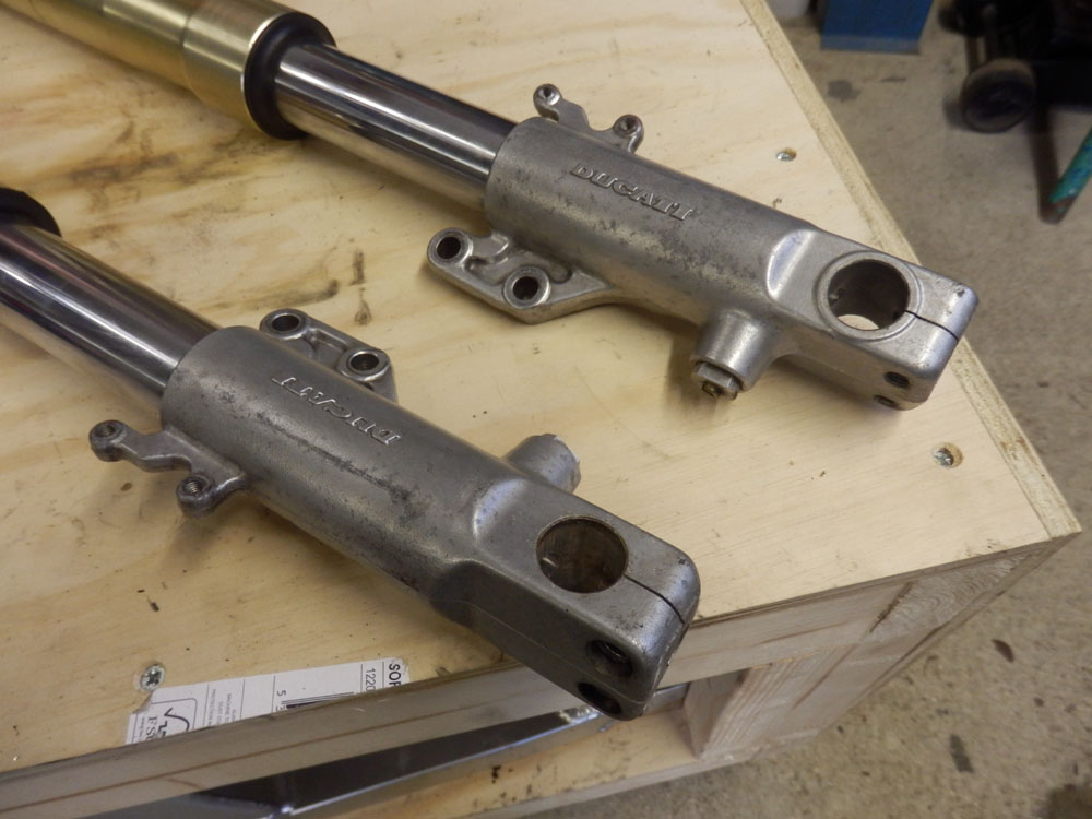

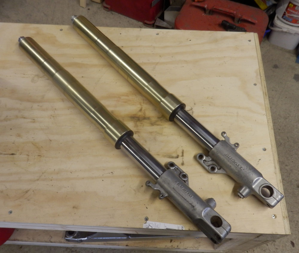

  12. Not these forks. I’ll post an image and maybe a video if I can tonight. Cheers.
  13. Yes, it doesn’t seem to make a difference on one leg. The other leg works as expected though. Dampening increase and decrease as you turn the adjusters clockwise.
  14. Yes. Sorry if that wasn’t clear.
    I set the pre load, rebound dampening and compression dampening to the same on both legs for a comparison between them. The faulty one seems to have zero dampening. Just springy.
  15. It’s all I got atm.

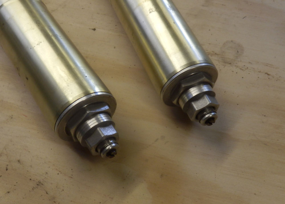

  17. Yes. Two small, flathead adjusters on each leg. One in the centre of the preload adjustment and the other down the bottom of the leg.

  19. Top and bottom adjuster screws?
    IIRC these are 2002 SSIE Showas. Top screw only.

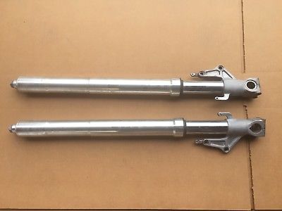

  20. Early Showas look like these which I have on my 900SS.
    My M900 has the MARZOCCHI version which I don't have any images of I'm afraid, but as has been said the giveaway is the mudguard bracket and of course the word SHOWA in raised letters instead of MARZOCCHI.
