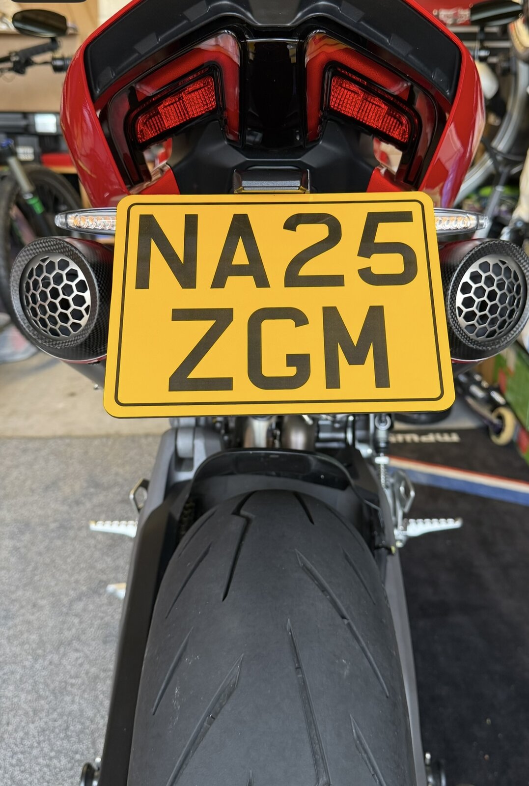

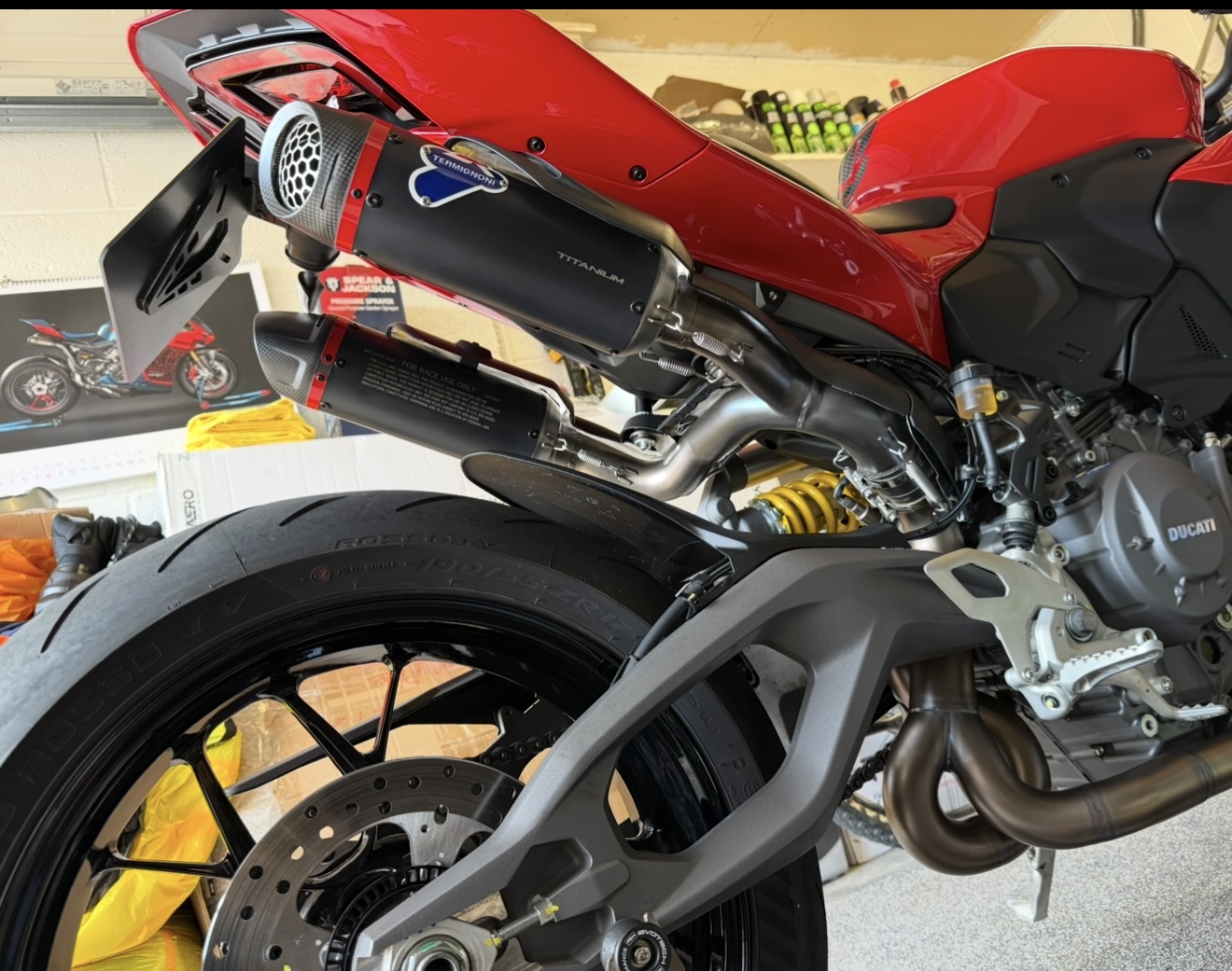

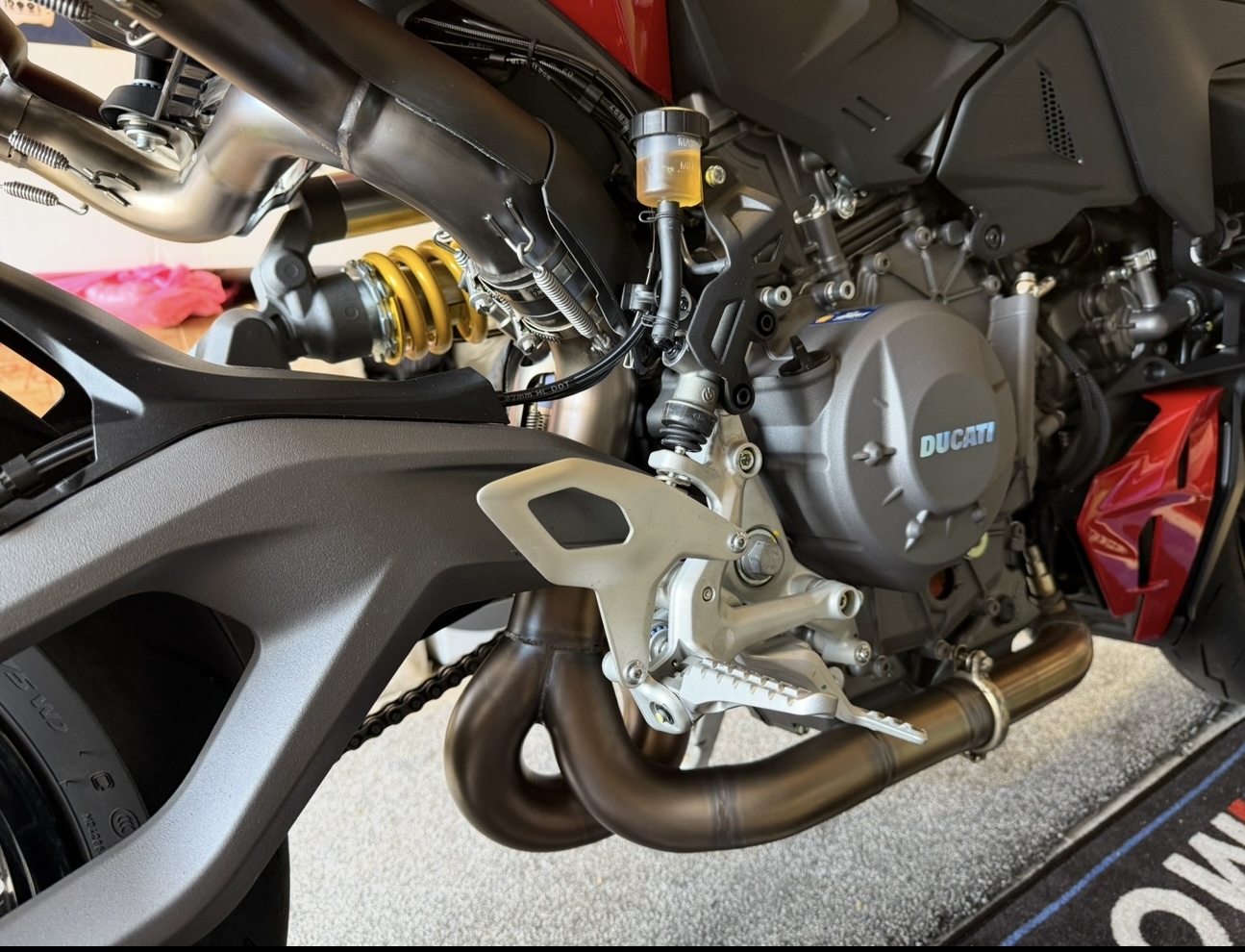

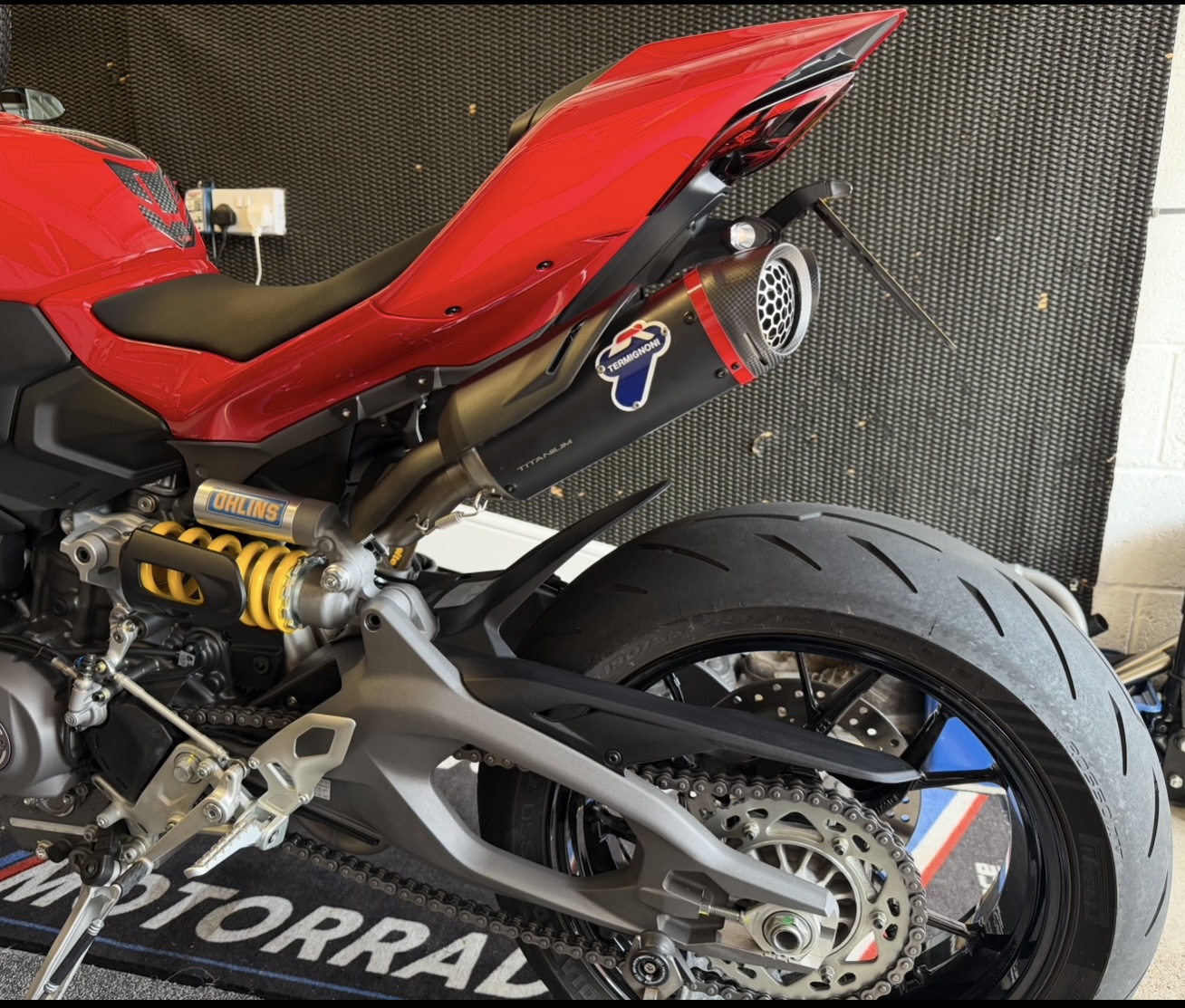

    My Termi exhaust arrived a couple of days ago so set about fitting it over the weekend.
    Turned out to be an awkward job to do.
    A few of the bolts are hidden so you have to remove other things to get to them.
    They say to remove the shock but I managed to get in without doing that.
    The worst bit was where Ducati had fixed the cat lambda sensor plug. It was wedged in a very tight gap between the inner frame and fuel tank so the tank had to be removed.
    The problem was that the front of the tank is held by metal sleeves that did not want to come out. After much swearing I finally got them out.
    The pipework fixing points were also a pain as they did not line up so I ended up removing the fixing brackets from the frame, attaching them to the pipework then bolting the brackets back in.
    Finally got it sorted so just need the map loading.
    Looks much better without that link pipe outside the swinging arm.
    The flashers ‘just’ miss the end of the silencers. If I didn’t have the thin metal flashers the standard ones would not have fitted.
    It is Loud !
