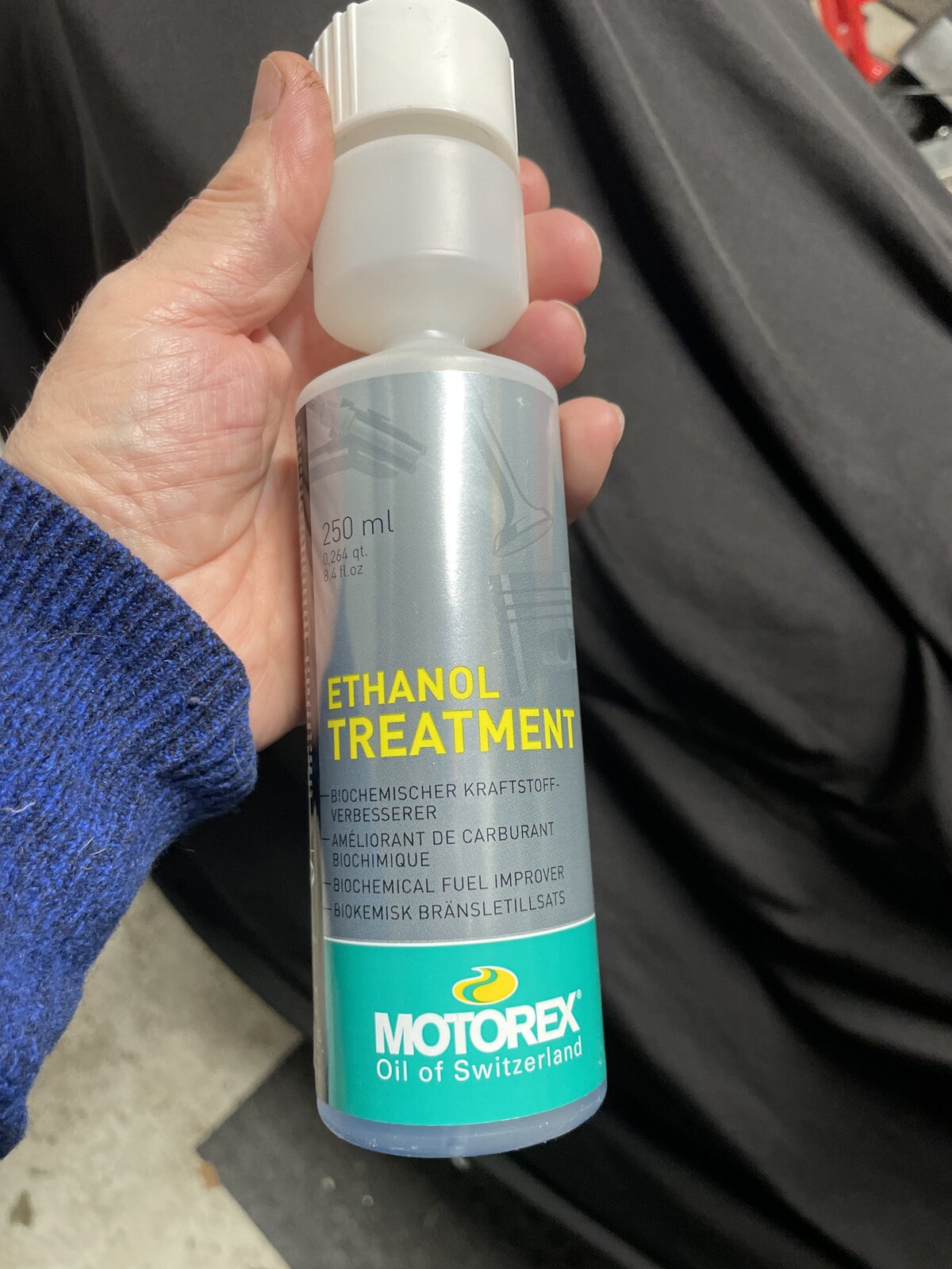

  3. I use exactly this.. Tend to buy it in small batches and it's not expensive really for the sense of protection it gives. I actually put it into every tank. Better to be safe than sorry. 1 Bottle last about a season or so
