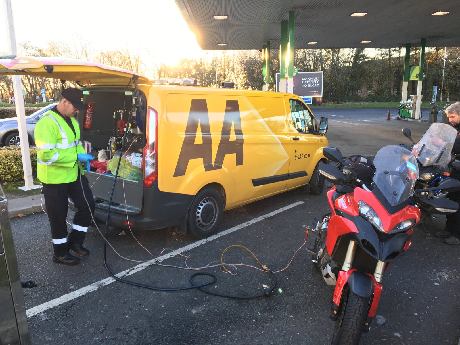

  17. IMG_3970.JPG Tesco momentum or bp ultimate , I have the termi and c Js racing tune. I also one day tried bp ultimate diesel that didn't go so well ! Yes yes I know How ! We still wonder to this day
