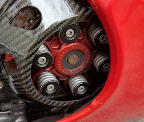

    Pressure plate bearing is all rusted

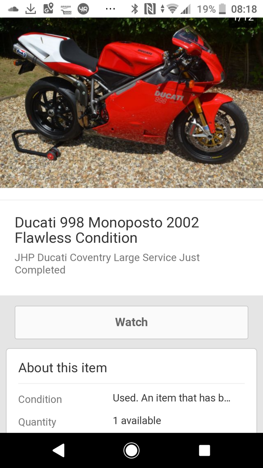

  11. Beautiful bike on ebay but it's only a 998, 9.5k gbp

  12. thats the one near me in cheltenham.
