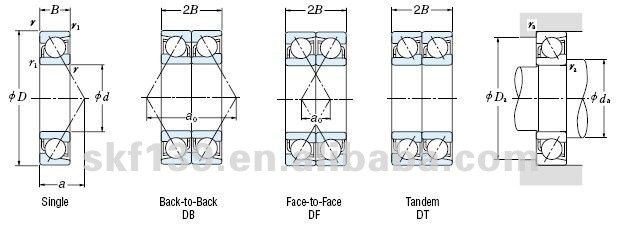

  9. Nelson as the engine heats up the preload gets less as the casings expand but the pair of bearings have to have just a little prelod to operate properly at running temp, that hot running preload is specified by the bearing manufacturers. If you put a typical 0.2mm preload cold that will mostly disappear as the engine heats up which is why there should be no float or up and down play when cold. Steve R and John Hackett is suggesting 0.1mm is more appropriate
    CR the mains are a pair of facing angular contact bearings which are "clamped" together by the crank cases and shimmed to ensure they retain the correct axial loading they are designed to operate with. Too much axial load means the bearings will break down due to overloading, too little means the bearings run loose and break down due vibration and intermittent ball loading. They are designed this way to minimize engine construction costs by reducing the tolerances required making the crankcases the perfect size.
    This is an extract from an skf bearing catalogue, the crankshaft is arranged with a pair of bearings arranged "face to face" either side of the assembled crankshaft
