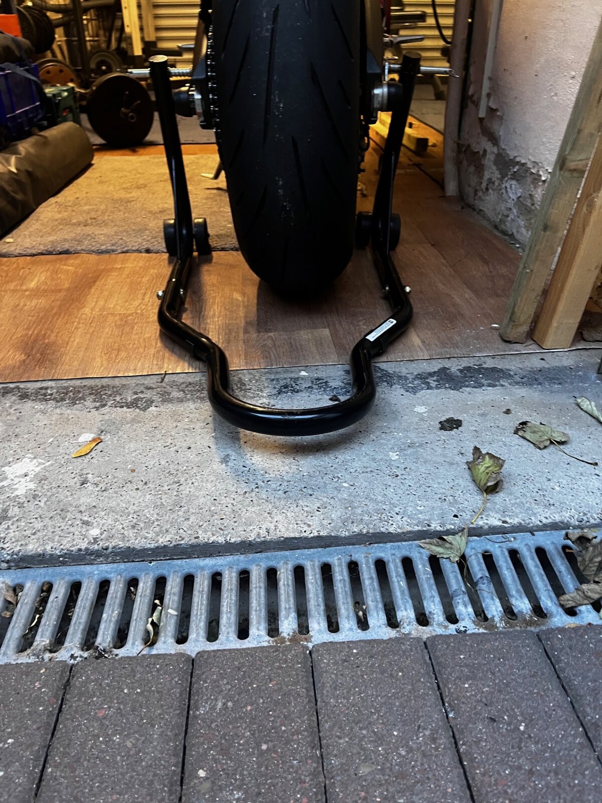

  1. anyone shed some light on why the wheel is still on the ground please.:thinkingface:
  2. Had this on the 959 as the bobbins sit lower than the R6 - had to use the oxford paddock stands or taller ones for wheel changes on it

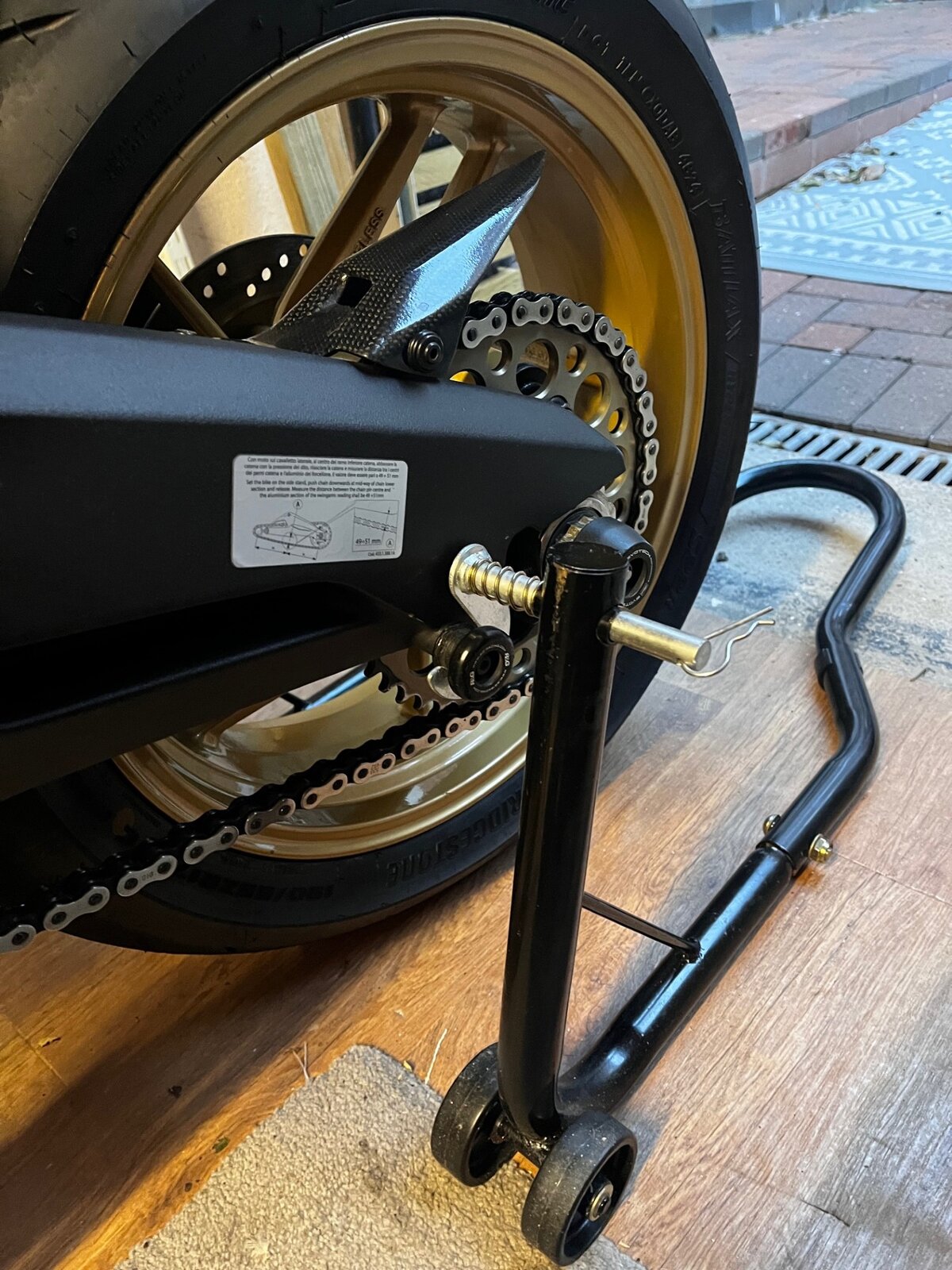

  6. The drop hooks are your problem, that stand is not suitable. Andy

  8. I reckon it's gravity. :kissing_heart:

  10. Yeah seen people do it, but its a pain to keep them in place and no where near as stable - think would look at Andy's suggestion of taller stands/upright hooks
    The oxford ones worked for me (Silver ones - the other ones wont) as they had the same config as per Andy

  17. Take a look on the Demon Tweeks site ,as there are some decent stands for not silly money on there ,
