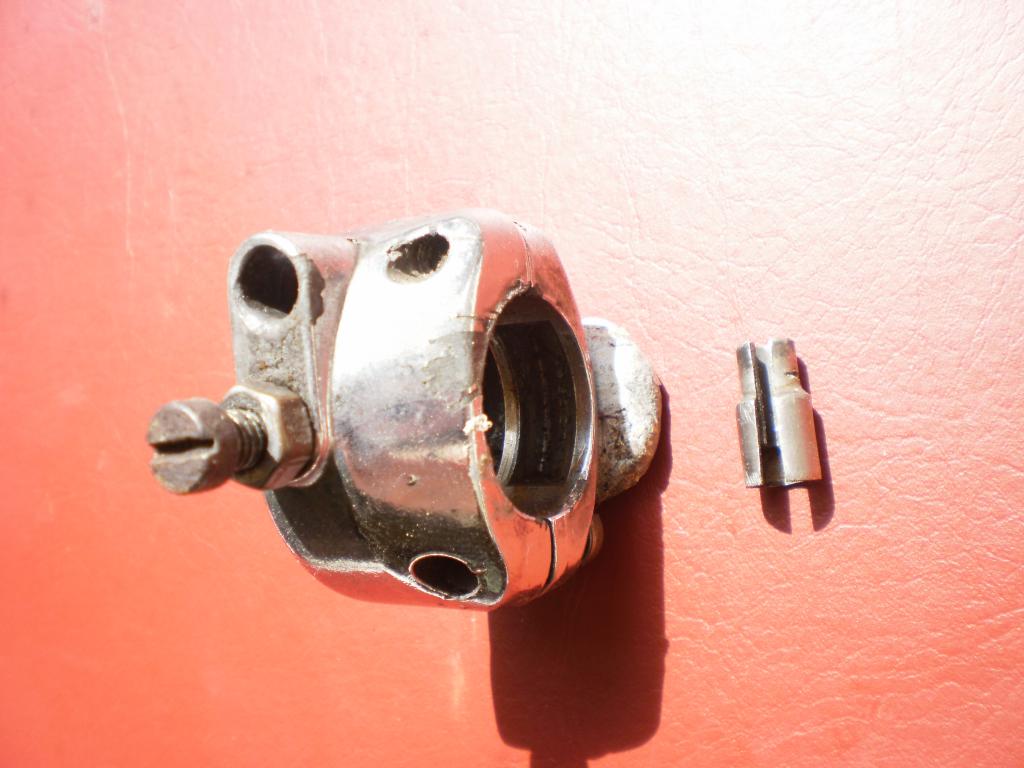

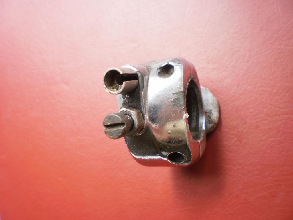

    And for the cable adjuster......is that hole threaded or plain?.....is there a 'stop' inside the hole?...... and is the nipple a removable one or is it soldered?
    I have a nice curved throttle cable adjuster from my Guzzi, but you would need to remove the nipple to get it on.......
    ........however, if you haunt Halfraud's bicycle section or any decent bike shop, I reckon you could find something like a brake cable adjuster adjuster which has a slot along it's length.......

    The hole in the throttle assembly is plain and 1/4" diam. There is a 'shoulder' of slightly smaller diam about 3/16" down the bore. My throttle cable's nipple is not removable.

    Thanks for looking through your bits. Please don't cut anything up ( yet). I will try the bicycle shop and the 'garden or agricultural machinery' type Le Throttle (2).jpg Le throttle.jpg establishment,first. I have now taken some photo's of the Le throttle with a ferrule that I have. The adjuster would have to be a slotted type.
