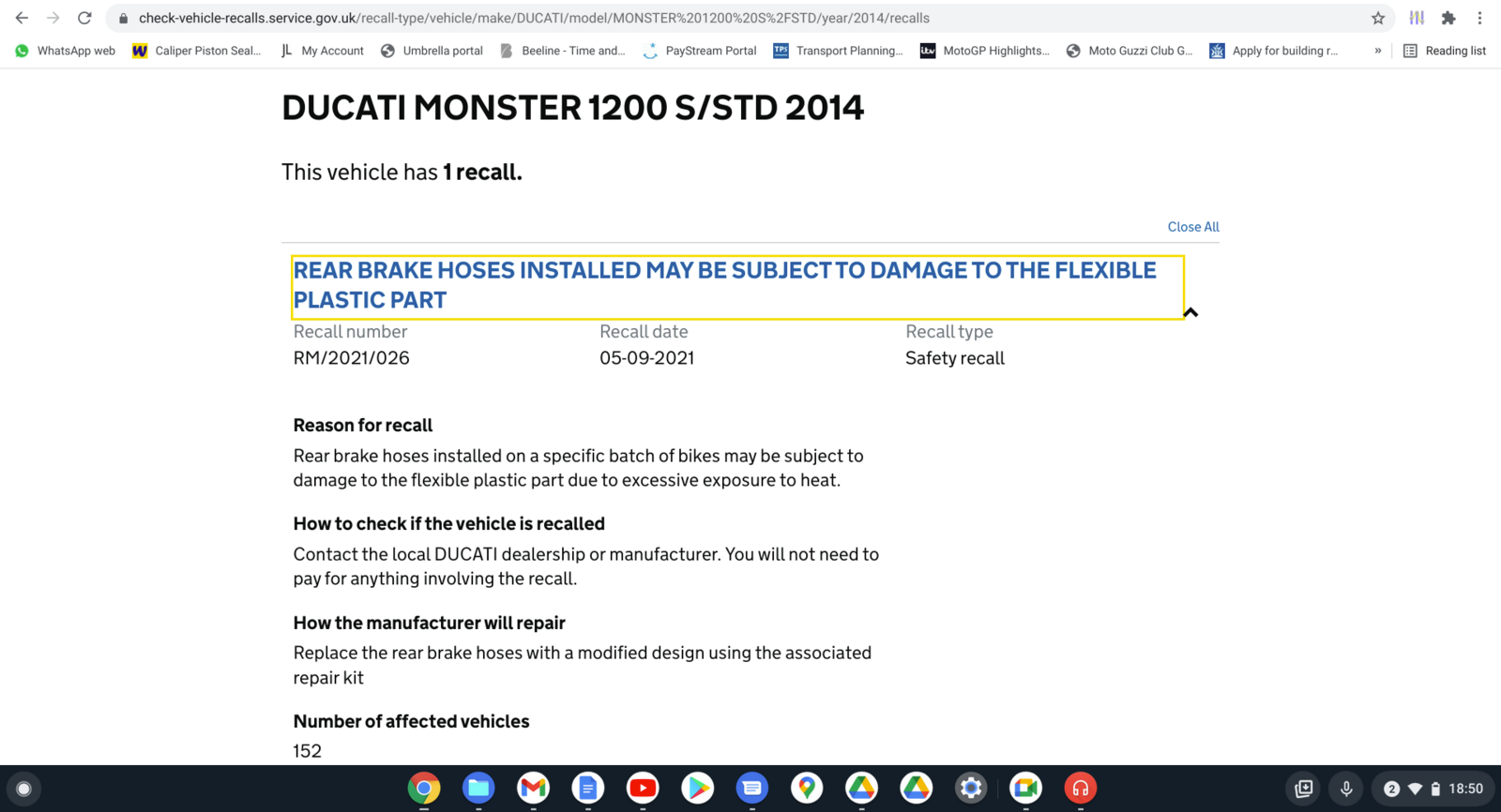

    Has anyone had the recall done and used the bike for a while to see if it has resolved this perennial Ducati rear brake problem? Like many people here and on the other forums, I have gone through a whole process of trying to bleed, reverse bleed, pressure bleed, vacuum bleed and even tried a different caliper, to end up with a rear brake that won't stop the bike rolling down an incline.
    I have also tried triggering the ABS by attempting to lock the rear brake in urban mode to build pressure, to no avail.
    I'm really hoping that the recall work will resolve this once and for all so I'd be really interested to hear from anyone either way. Couldn't find anything on the Ducati UK website so I checked on the UK.Gov website and found this below:

    If you see the thread above; I heard nothing from Ducati so I looked up my 1200S on the DVLA database and found that it was one that was included in the recall, so I sent this information and the screengrab to Pro Twins who undertook the work and billed Ducati.
