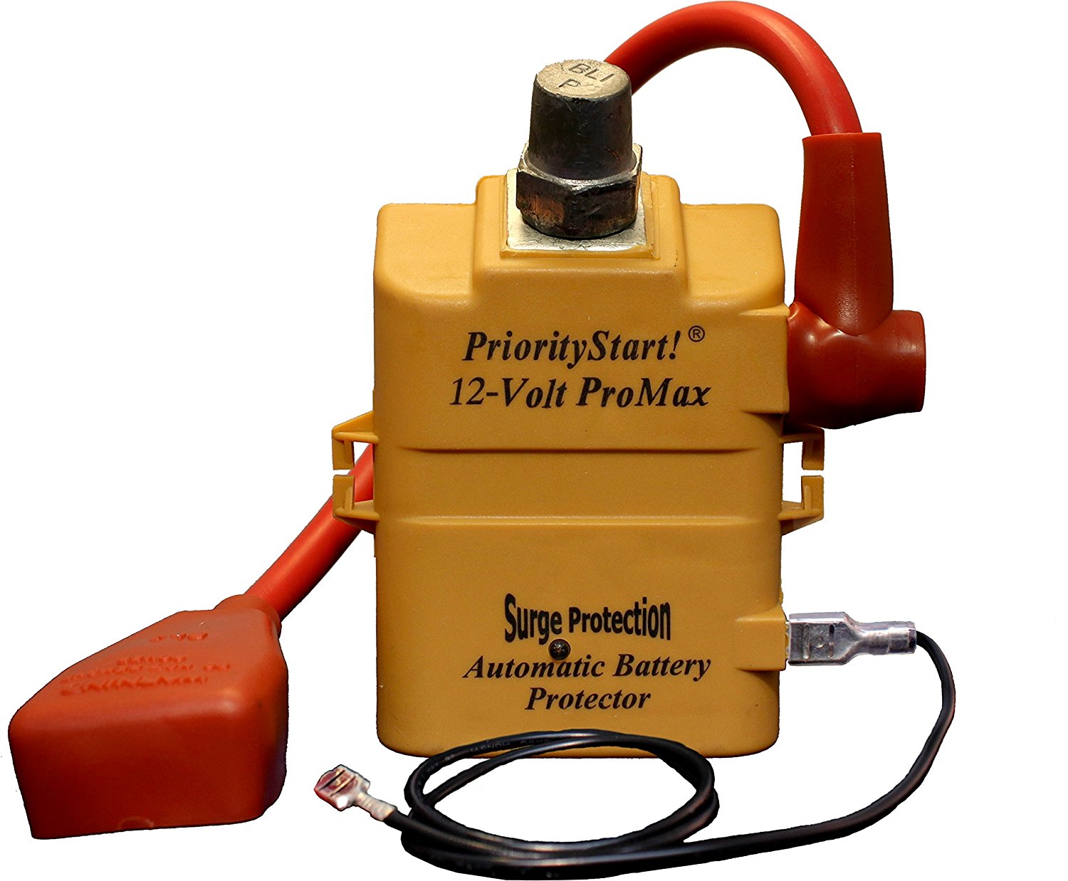

  11. What I'd like to see is a small (enough) battery disconnect module, like I have on my van (mines coloured Black and was purchased in the USA). I think these are available in the UK.
    [​IMG].
    This 100% stops dead batteries in normal use.
    Like this, but built into the bike.
    It wouldn't need to have the starting current go through it, just everything else, so perhaps 50-100 amps max.
    The biggest running current is the injectors and pumps (fuel) / motors (fan) these days.
    It works by monitoring the battery voltage, once it reaches 11.7V for a period of time, with no changes in current draw it disconnects it from the vehicle.
    Just tap the brakes to make it come back to life.
  12. What a stunning bit of kit!
  13. Obviously an issue for alarms and trackers though
  14. Both the trackers and the alarms alert me to the fact it's triggered. It's always been I've left the lights on.
    It's only gone off about three times in 2.5 years.
    It's better than having your van stuck in some dodgy part of London with £35K worth of kit in it.
