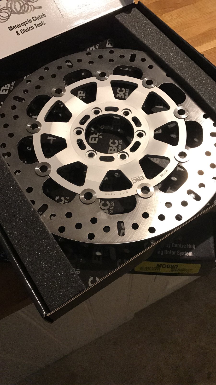

  1. Hiya, the front discs on my 2009 Ducati 848 are starting to look a little worse for wear so looking at replacements. I prefer the look of the EBC discs to the Brembo's, purely because the disc carrier is gold rather than boring old black. Question is though, are the EBC discs gonna be detrimental to the braking system as it isn't oem Brembo ??? I would be looking at EBC round discs with new EBC HH sintered pads.

    I’ve had them on long enough to know they’re equal to the oem Brembo Kit discs that were on there. No issues.
    I’m running an NG waves Disc at the rear and that’s good too.
  5. If your Brembo are proper aftermarket Brembo I would agree. The oem stuff isn’t. It’s cheap stuff with a Brembo name and just on par with EBC.
  6. Get Brembo from Omniaracing.com.
    Good prices and great service.
  7. After much searching I have found Brembo Serie oro discs for around £330 a pair and EBC X series discs for around the £250 mark.
    Are the EBC gonna be THAT bad in comparison to OEM Brembo????
    As I said I prefer the LOOK of the EBC as the gold carrier is a bit better than boring old black that Brembo use.
    Plus the fact the discs on my bike show considerable wear on the braking surface , I reckon the disc is around 1mm thinner over the contact area of the pads compared to the original disc thickness , after 17,000 miles , another reason I lean towards EBC discs. (I machine metal for a living and it has always been a popular belief that Italian manufactured steel is pretty crap)
    chz
  8. If you’re replacing oem Brembo with oem Brembo, EBC will be just as good. If buying off the shelf Brembo, Brembo may be better.
    To be clear, when we talk about oem Brembo, we’re not talking about Brembo’s usual quality items. We’re talking about the cheap toot that the likes of Ducati, KTM etc ask Brembo to make on the cheap so that they can tell us chumps they’re fitting top spec brands when actually they’ll be worse than cheaper brands.
