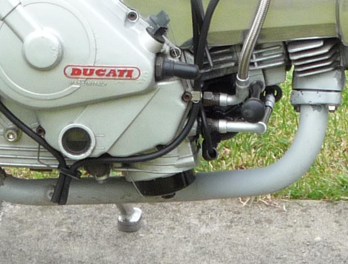

    By the way - lock-wired to a sump fin, not the cylinder head. Below.

  16. IIRC the 750 IE doesn't have a convenient fin near the filter; so what I would do is use a K&N filter (which has the lockwire nut on the bottom) and drill a small hole across the angle of the screen filter nut and lock wire to that. In fact on my carbed SS, drilled the 'sump' plug and the screen filter nut so they were both lockwired together. You could do the same but include the filter as well.
    Before you remove the screen filter so you can drill the 'nut', mark the nut face at between 1 and 2 o'clock, that way the wiring will tight in the right direction (if you are only wiring to the filter - if you include the sump plug you will need two holes, the other at say, between 6 and 7 o'clock position.
    With the sump plug, you drill at quite an angle from the face of the plug into the allen socket so the hole comes out about 2mm up from the bottom of the socket.
    Drill size preferably 1.0mm but you can get away with 2mm. (I use 0.75mm stainless lockwire).
