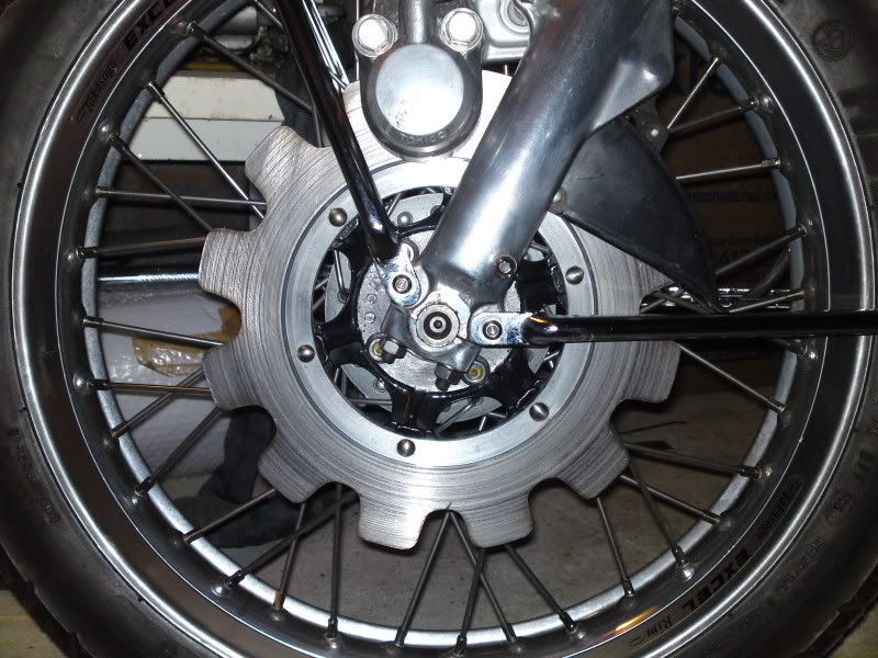

Hi all (Having a senior moment...) I remember reading in a bike magazine lately an advert for a company that can make ANY replacement brake disc... At the time I didnt relate this to an ongoing problem with my beloved Yosh 400/4 - the engine is now a LOT faster than the brakes... Wishing to keep a standard front-end, a large part of the problem is the stainless brake disc - too hard to work effectively if at all? Im thinking a custom cast-iron disc could make the thing stop & induce an interest in riding the bike again. :biggrin: Anyone? :frown:

400/4's arent known for having good brakes. :wink: Have had the bike for 22 years, tried a different master cylinder, FIVE different type's of pads - the front brake is in typical '70's fashion an ornament, nothing more... Stealth went bust a while back, apparently under new ownership? Their previous reviews werent great... Standard Four disc is a strange diameter - nearest I could get to it was a Guzzi Brembo disc? Will see if I can get into the garage and get some measurements...

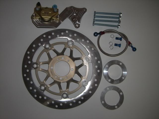

These people do a Brembo caliper conversion - caliper is as far as I can see a rear Ducati one? The caliper & disc wont be a problem, the adaptor bracket would be... CB400FOURƒtƒ‹ƒŒƒXƒgƒAEƒJƒXƒ^ƒ€ê–å“XAGAINiƒAƒQƒCƒ“j/‘åã•{‹·ŽRŽs Edit - is £712 + P&P

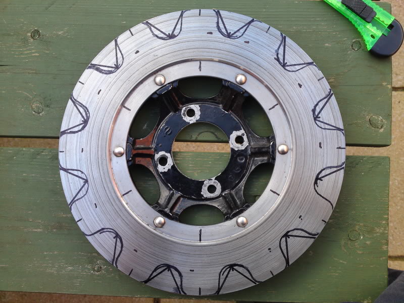

Ummmmmm disc diameter is 260mm, PCD is 76mm. :smile: Was thinking this afternoon if it was plausible to have a cast iron rotor machined up to re-rivet onto the original carrier?? Here's a pic of the Jap Brembo conversion... will get the PCD to you asap but as you can see its a four-bolter... easily overcome as they have by using as existing pair of holes then drilling two new ones to suit? The standard discs are 6-7mm thick, almost a car disc - did have a drilled one on there but upgraded to a wavy... The standard solid discs are LETHAL in the wet - almost an extra throttle??

On the upside 260mm appears to be a very popular size for car rear discs?? HONDA CIVIC 06> REAR BRAKE DISCS *PAIR* *0555* 260mm | eBay Wondering if these or similar would have the necessary depth to have the middles machined out and the disc swept surface fitted to my carrier??
