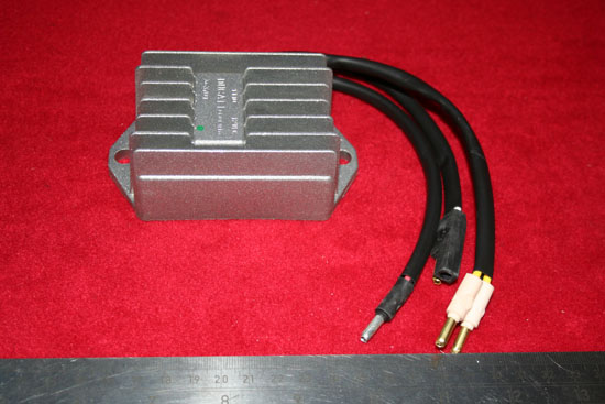

  1. Strange that Zane Laverdas use basically the same reg/rect as late 1990's Ducatis, and yet don't have a reputation for them dying. Could that be because the wiring is made to a better standard ( apart from the starting circuit ) and the reg/rect is placed away from anything that generates heat?
    To answer the OP - two reasons : they get hot - because of where Ducati located them, and they wiring connections corrode, hence creating high resistance joints which damages the reg/rect.
    And yes, Electrex ones work well and seem to last much longer than OEM ones.

  6. Have to agree with you there Hammer, I think I paid about £120 from memory for my RR53 Electrix unit around 18months ago and now thats fuct too.......not impressed with rip off Britain piece of shit...... bike sat for over 6 months without turning a wheel so didnt last as long as original fitted to bike, 13 or so years for Ducati part.....
    Ive already changed connectors for a better type and use thermal grease as Bootsam does.
    Due to time constraint as Im getting bike ready for a trackday at Cadwell on Tuesday Ive purchased a new unit off ebay for £29 pounds......
    cant be any worse than the shit Electrix unit....
    Will fit Zx10 unit and harness as Chris W suggests in future.
    Daz.

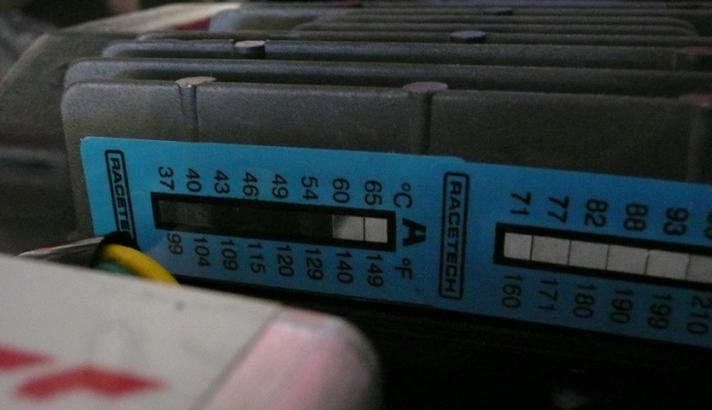

  13. had similar experience, the 'everything turned off' leakage of some Electrex are typically typically 4 times the amount of the standard units and can get larger in time. As said earlier I think both the earlier Ducati Energia and later Shindengen units get an unfair pasting, often being targeted incorrectly.
    [​IMG][​IMG]
