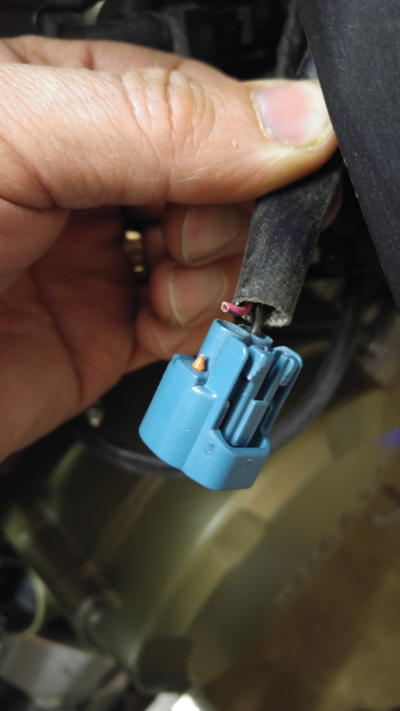

  3. Diagnostic showed Air Induction Sensor.. Which lives on the bottom on the airbox. No idea WTF its roll is
    as seen here
    Can anyone spot the fault
  4. It opens the valve up to allow fresh air into the exhaust ports... emissions trickery ;)
