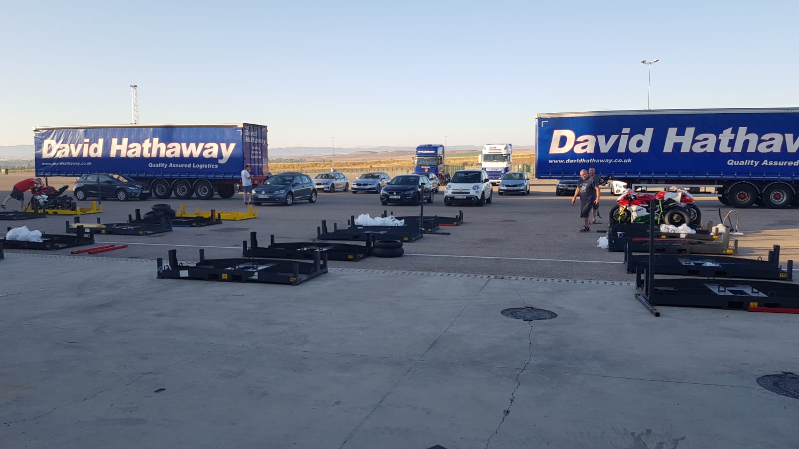

  10. Well a disasterous Aragon trip - had 2 sessions of first day out of 3 and coolant all over the bike :( -
    Looks like either rear thermostat housing split/cracked , or rear coolant pipe where it goes into crankcase then into the coolant pump .. or a cracked crankase at the bottom as you can see bubbles in the pool of coolant
    Bikes under warranty but back to Ducati.. and £1k down the drain ...

  13. Yeh Ducati Cambridge are pretty good
    One of my buddies who has a 1299r had similar symptoms when his water pump failed theres a bypass valve (ball bearing) in the bottom of the v- crankcase - so I’m hoping it’s this rather than cracked crankcase ...

  15. hi fella it’s an S - puck it up Saturday and straight back to Ducati
    looks like it could be water pump - similar to my mates 1199r that had one go
    I’ll ask for a spare just in case it goes again
    I wonder if i can get some compensation from Ducati ?
    Embarrising - 2 broken Ducati's put on stillages ealry - £60k worth of bikes broken on day 1
