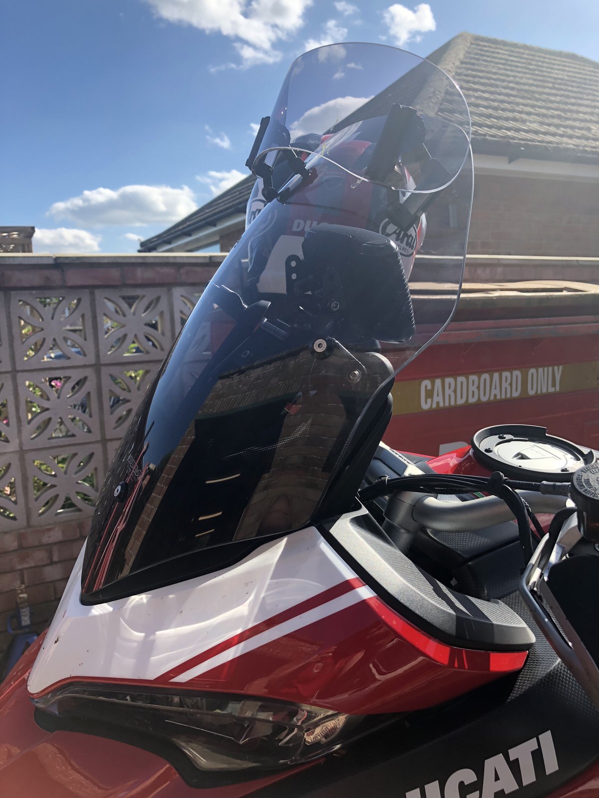

  10. Good news at last. I can see light at the end of the tunnel. I’ve fitted the mra vario screen and the noise is reduced dramatically with my tour x. At the moment I’ve had to fit it using the spacers from the multistrada group on Facebook as it fouls my Sat Nav. There’s still some tweaking to be done as I’d fitted the seat risers at the same time so I’d like to try it without them. I’d also like to try the seat risers with the PP carbon screen.
    If anyone reads this in the future and is thinking of fitting the mra on a PP. contrary to what the supplier thought. You do not need a fixing kit from a standard Ducati screen. All fixings are supplies.
    The only downside of the mra vario screen, imho it looks pants but on long journeys at least, I can live with that!
  11. Do you have any pics?
  12. not a very good pic, i'll take some more tomorrow
  13. Just ordered mra vario. Might just do the job as having same problems. Tried puig tall screen but took it off. Too tall. Fingers crossed.

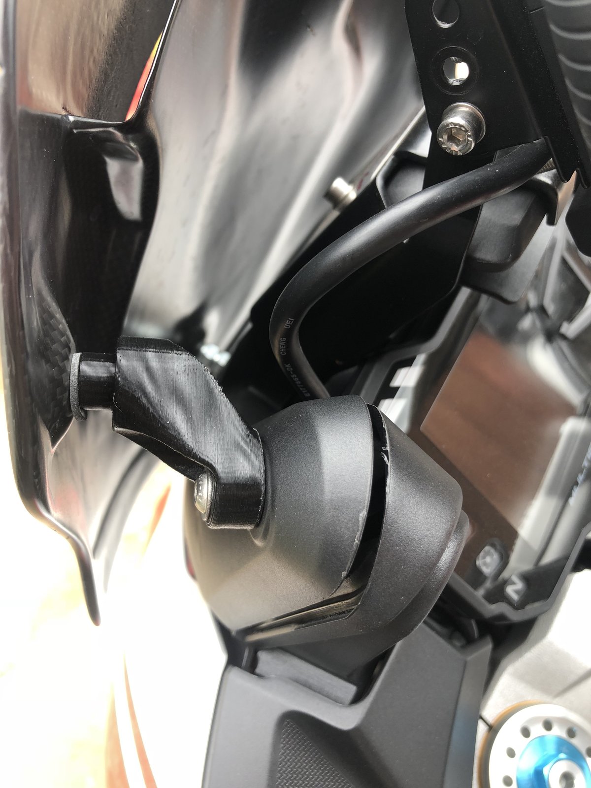

  14. as i said, my sat nav fouled the vario
  15. Yes read that. Is it an easy fix. As I have navihalter too
  17. but i could have probably just moved the navihalter bracket down one hole
