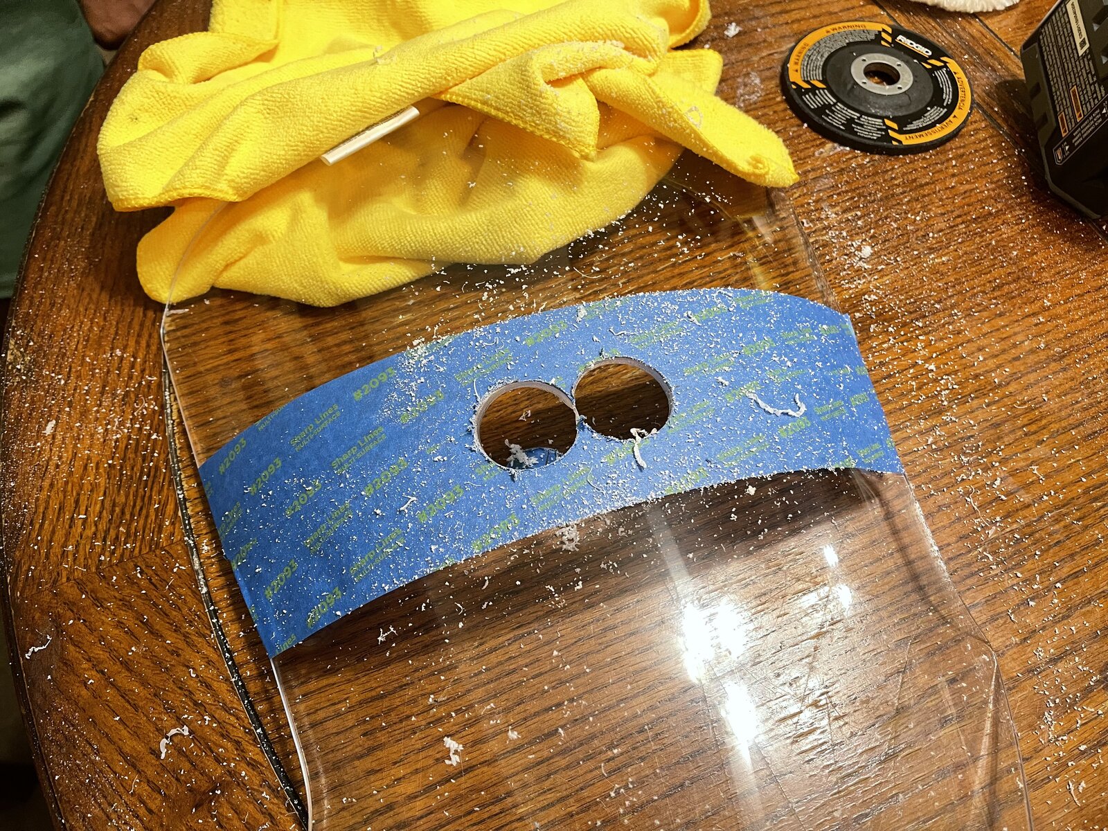

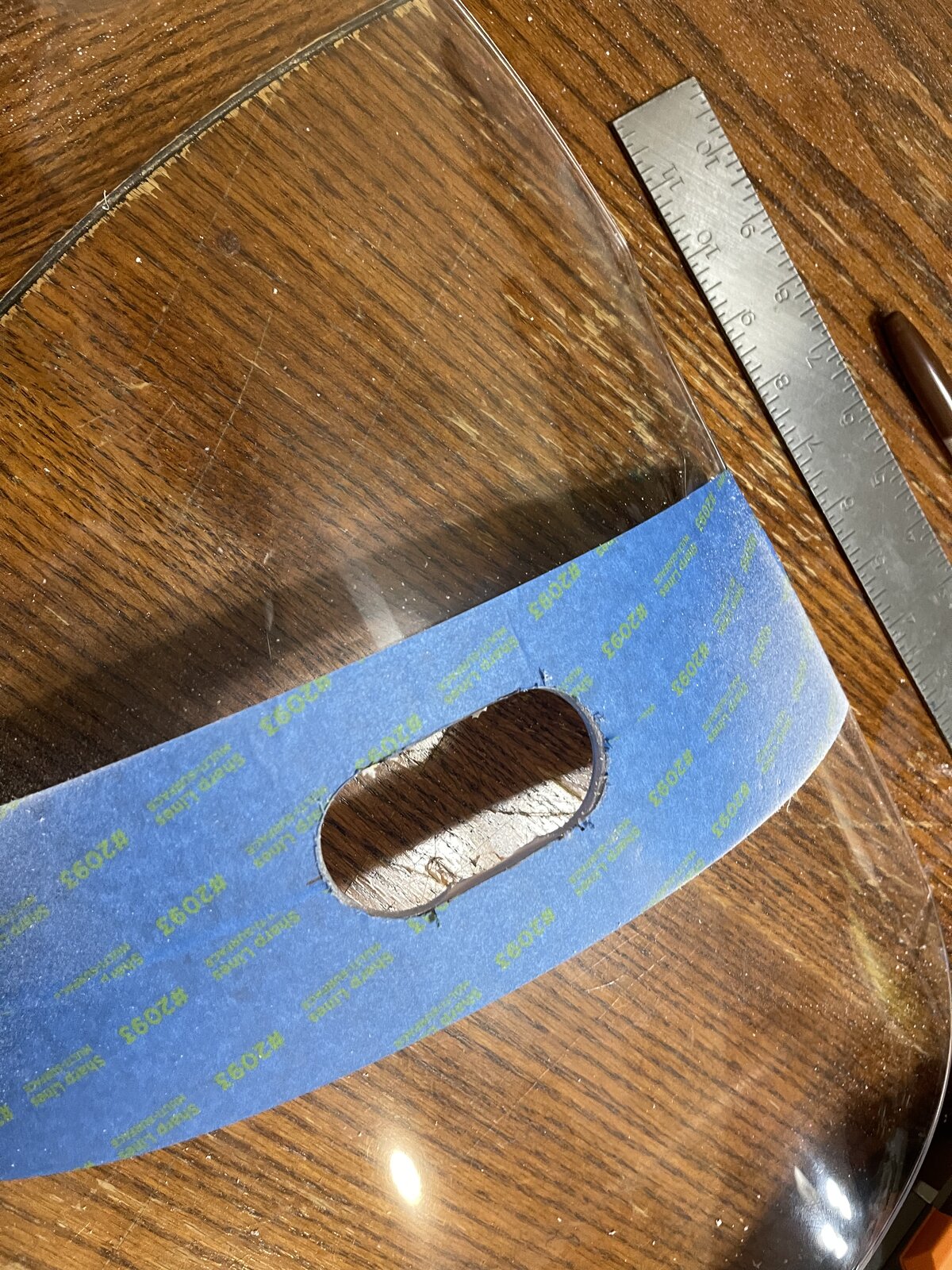

  1. Punching a hole through the stock windshield helps too.
  2. That’s interesting, proof that relieving the back pressure helps.

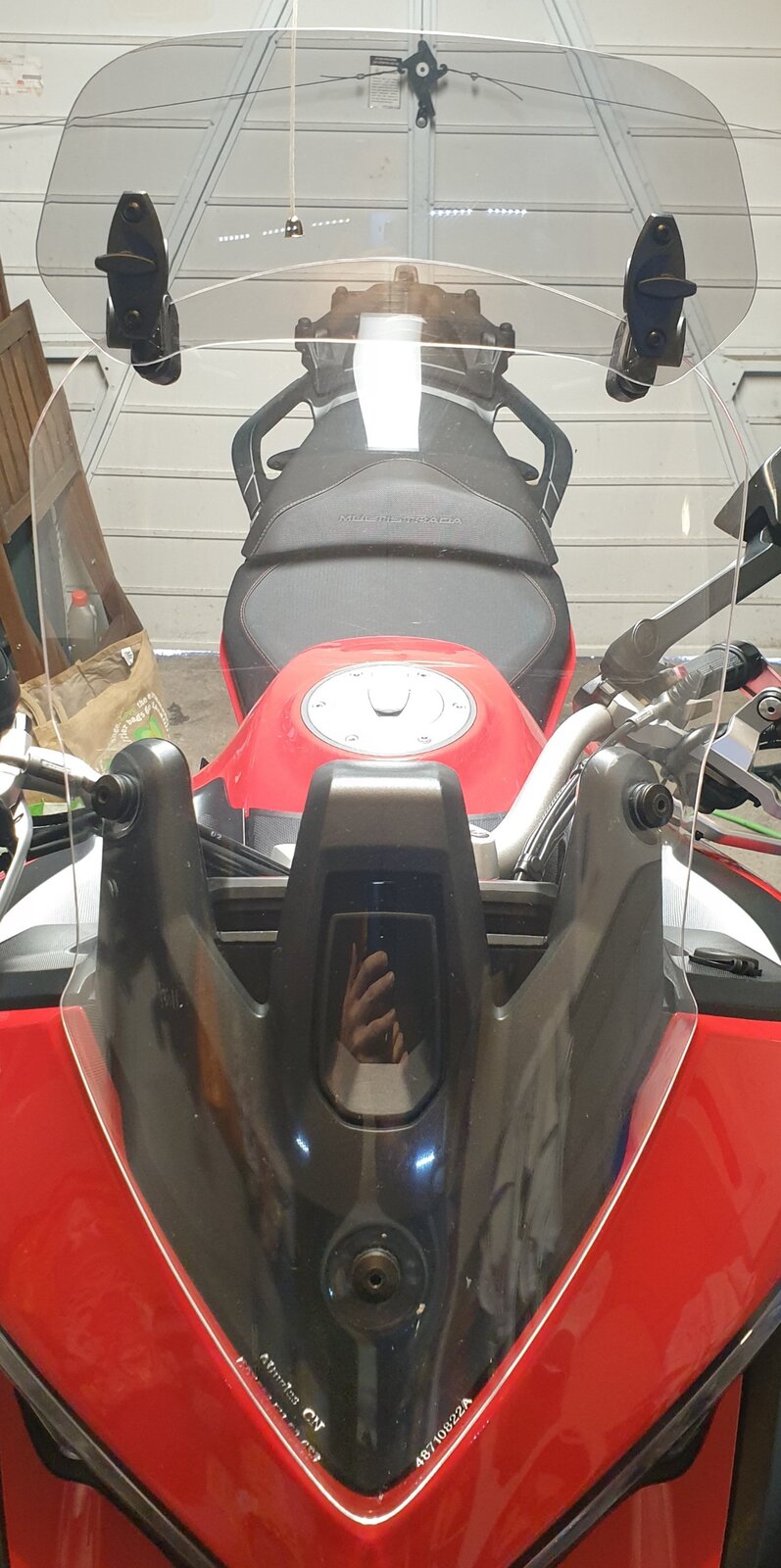

  5. Just fitted the deflector.
    Hopefully it helps but the predicted dry day around here has turned into a downpour so I can't test it. Obviously I much prefer the bike without it but until I find a more aesthetically looking solution without wasting a load of money, then this is it for now.

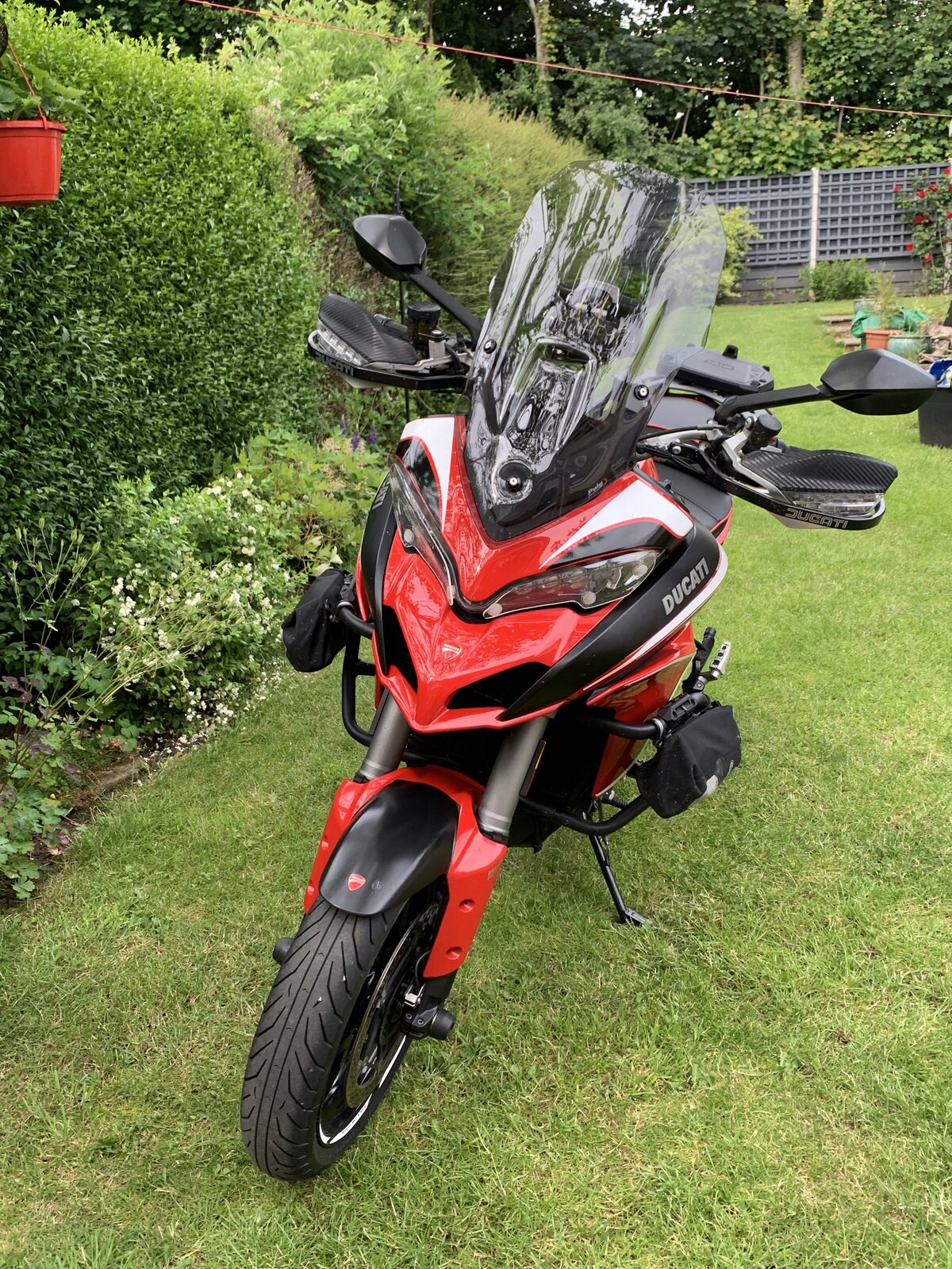

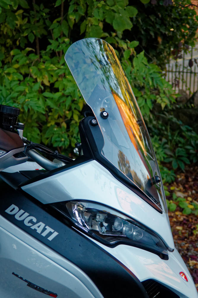

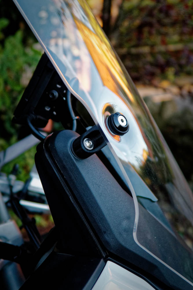

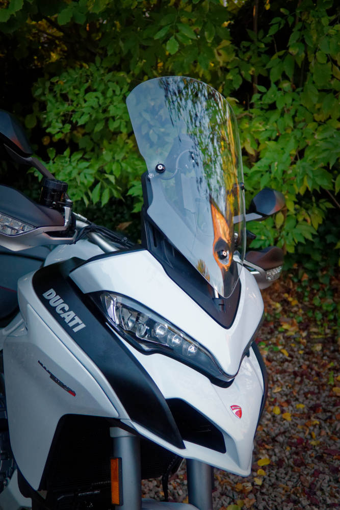

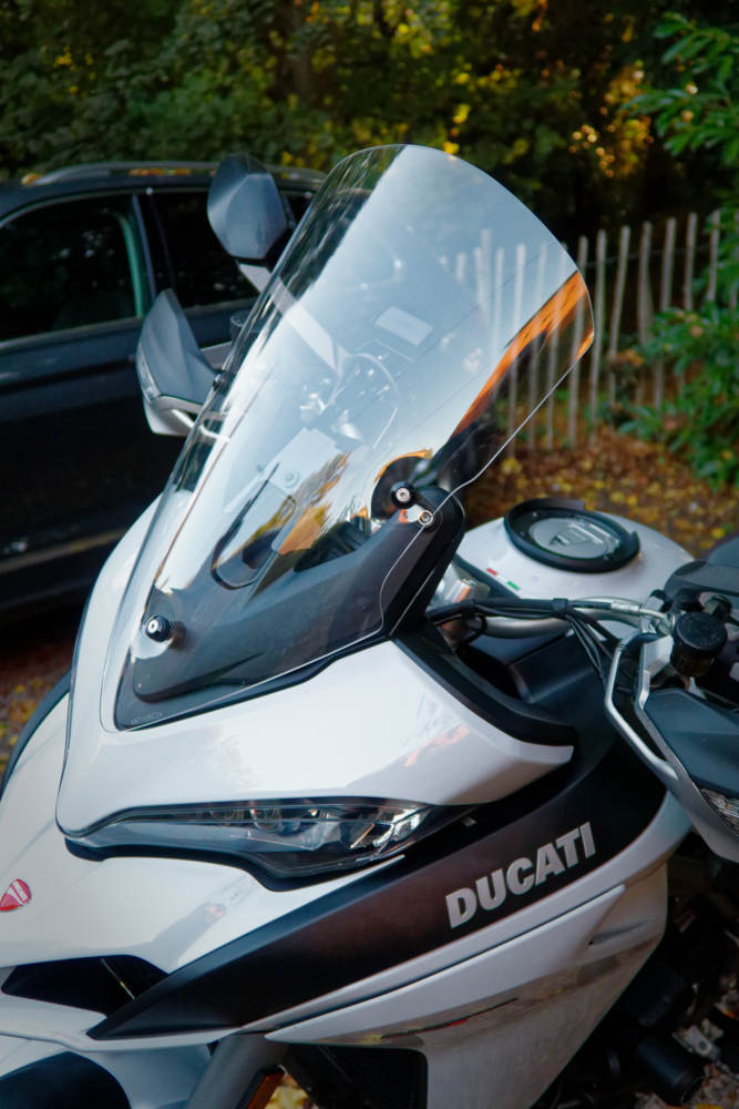

  9. 90AA27AF-5163-4E75-A3FD-B2800C97DFB5.jpeg 6227F8D5-120A-4151-A2F7-3B1349777FFC.jpeg 823A6715-3089-4986-898B-E3AD5C8022A9.jpeg
    a selection of photos showing some of the screens fitted

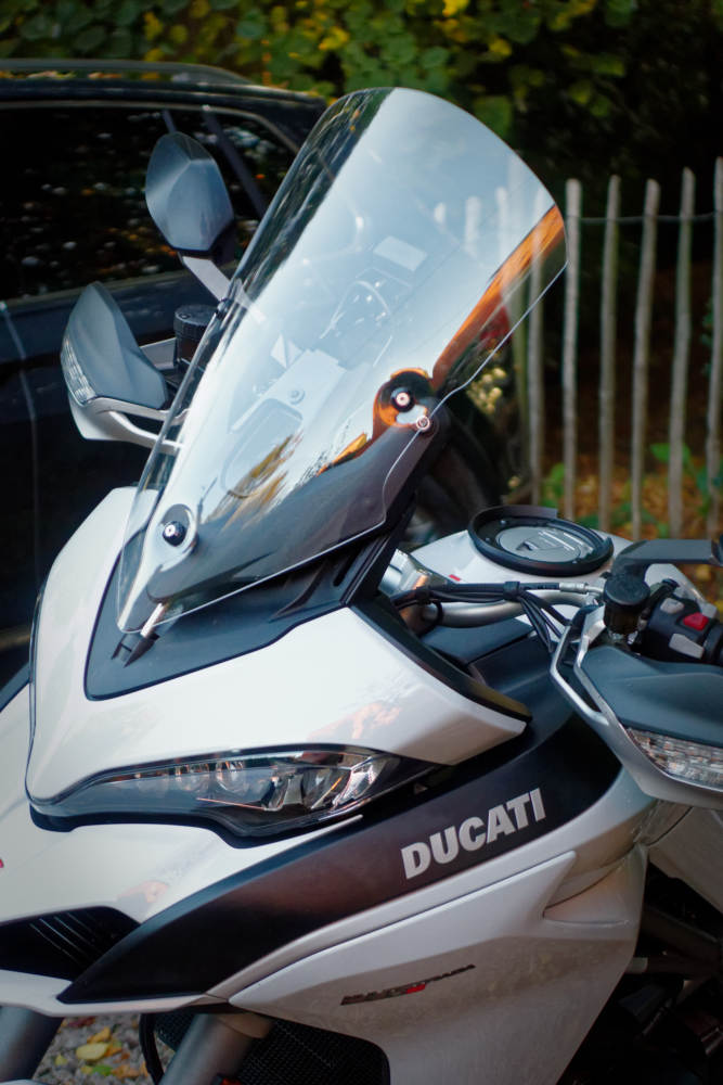

    IMG_1123_web.jpg IMG_1124_web.jpg IMG_1125_web.jpg IMG_1128_web.jpg IMG_1131_web.jpg
    Though there is a different spacer kit for fitting with the new wings/nav mount/spacers combined. Though I imagine that these still use the grommets, just aren't as tall.

  13. I did that with a stock screen, and made my own version of a PP screen. Fine for short summer rides, although the bugs are annoying!
  14. Had a ride out yesterday with the new deflector in place and after a few adjustments I can report back that its better, but I obviously as mentioned before do not like the looks (what a tart !).
    I will for the summer no doubt get the puig sport screen. But one of the big reasons for getting a sport tourer was for the weather protection in winter months, so I really need the bigger screen for now.
    I've emailed iconic parts who now want pics so I'll sort that later. Still hoping that the spacers will make it more rideable without the added deflector but so far the £16 or so for it has been money well spent.
  15. After I while I didn’t even notice the deflector. It was by far the best solution I found for wind noise. Best £16 I ever spent. Well not ever, but you know what I mean.

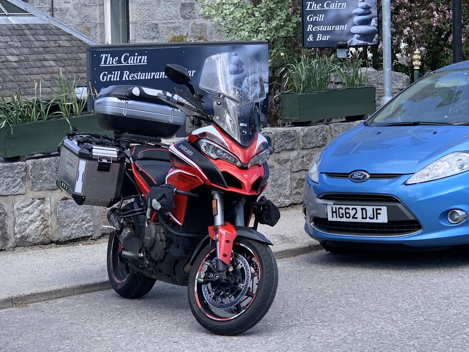

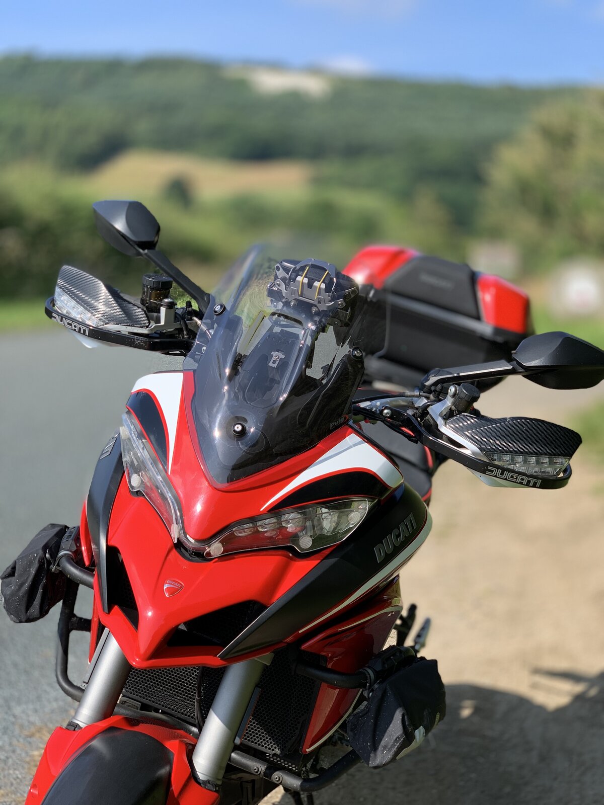

    Here’s mine!
