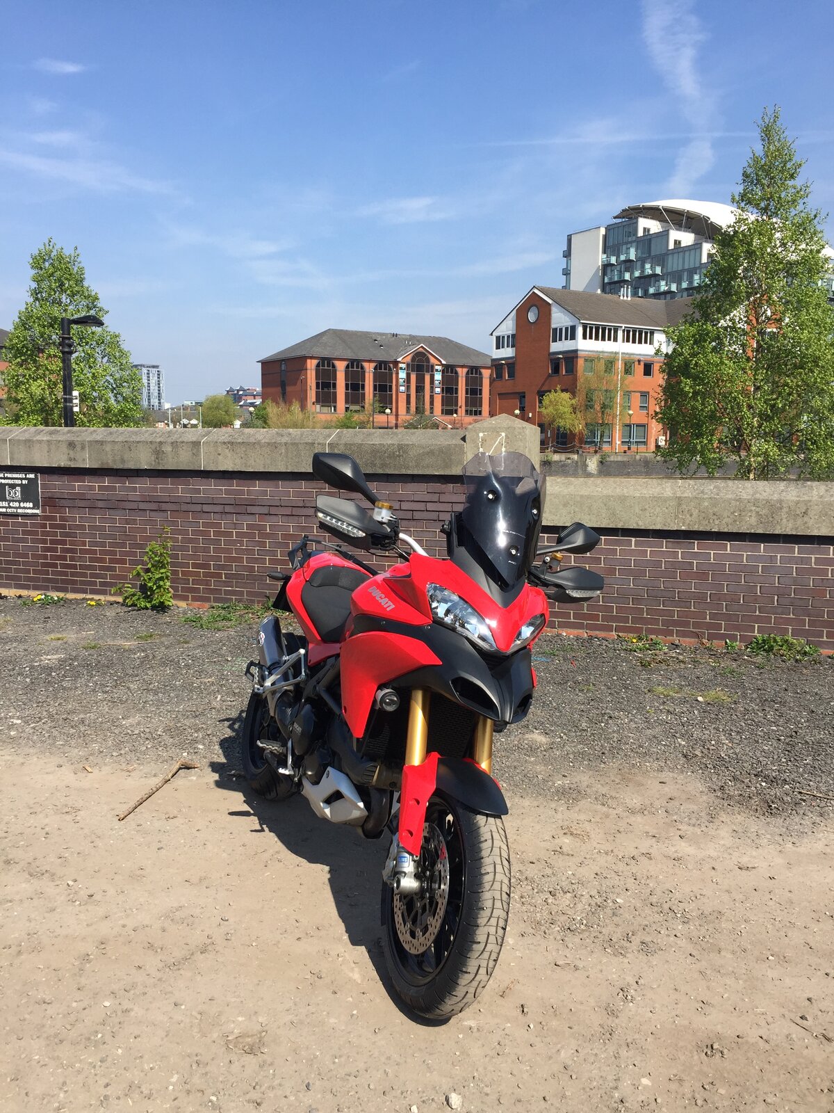

  8. Short screen with spacers which allow the wind to flow around the screen 60217639-ED07-4CF7-9E3A-4D8313AB3167.jpeg
    Stops vibration and looks cool!
