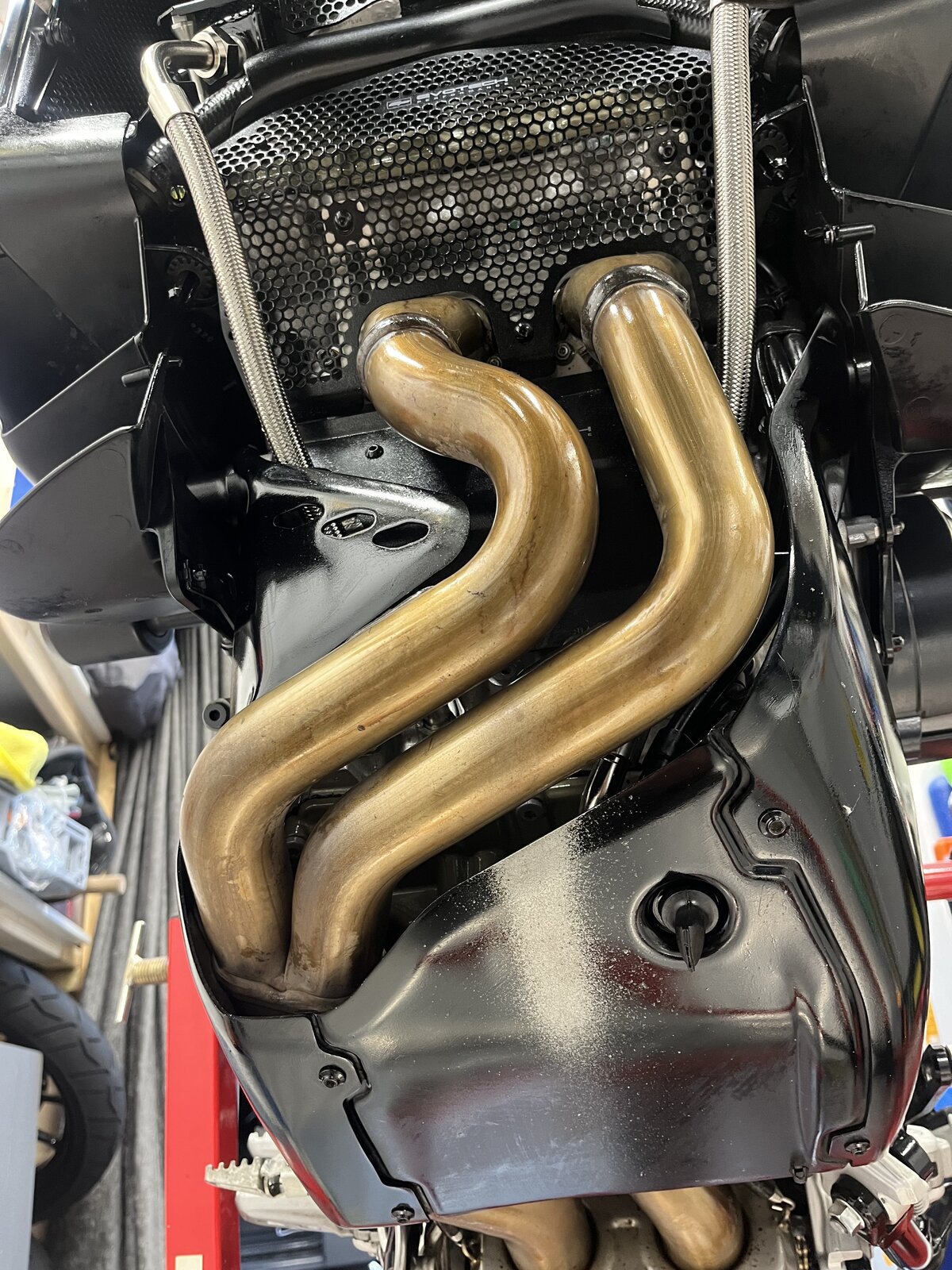

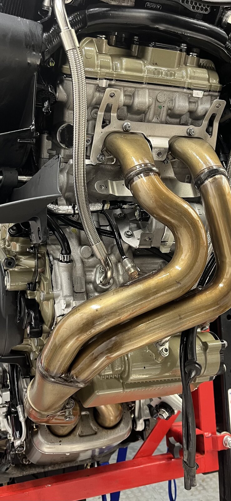

  1. IMG_3586.jpeg First coat AC50 ready for the winter rides , can’t wait. Second coat tomorrow after a pre heat . Bring in the cold days and fine tune the grip hunt ready for the summer slides lol
    The Evo tec full guards did there job well , well recommend them . 6k

  3. Do not underestimate the power of a proper application of acf 50 (atomised via compressor and paint gun). My bike still looks new after a wash despite it being several years old.

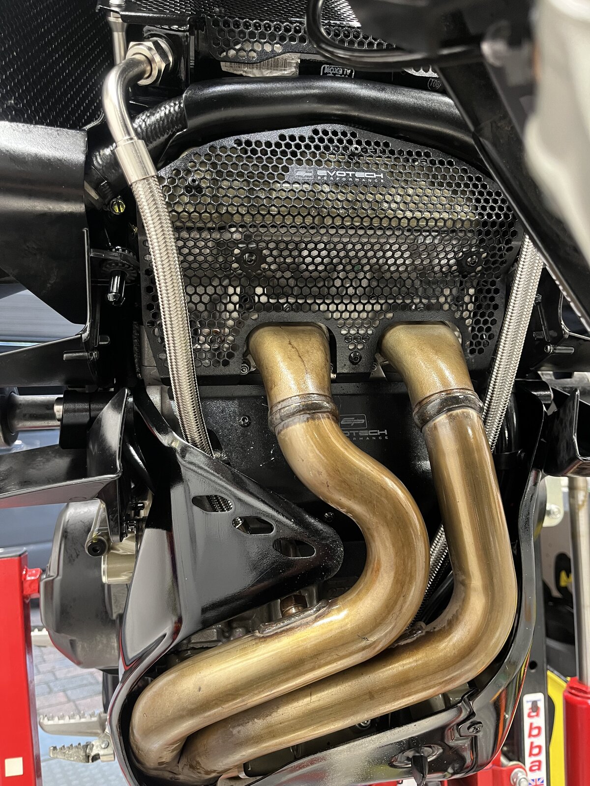

  7. IMG_3590.jpeg All back together , re coated and re plated , again Evotech guards , perfect .

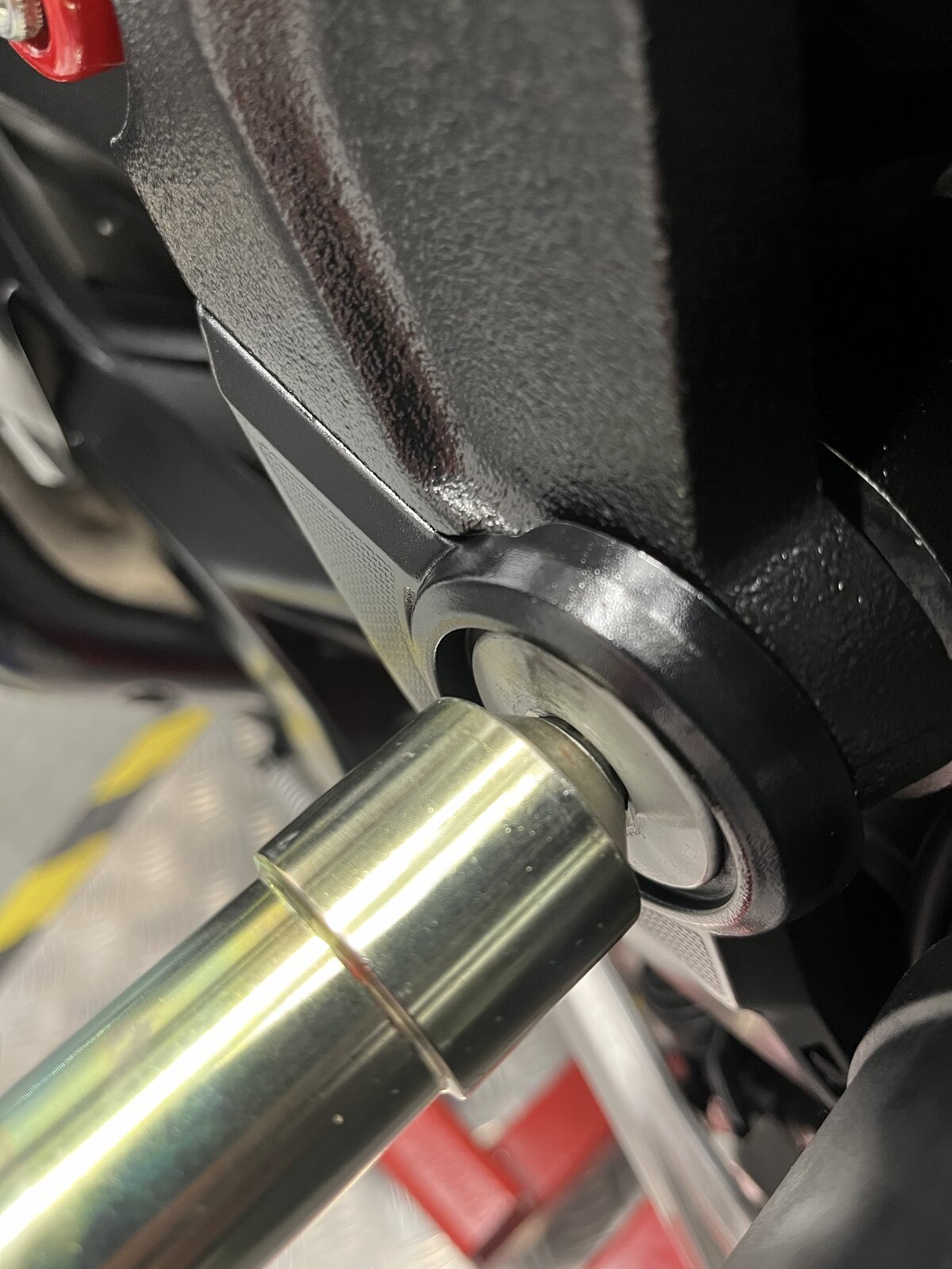

  8. No , it’s on an ABBA Skylift which allows you to raise the front right up which allows total access to the underside and front . You could take it out but still have the ability to sit on a cushion on the floor even thou both knees are a bit worn lol

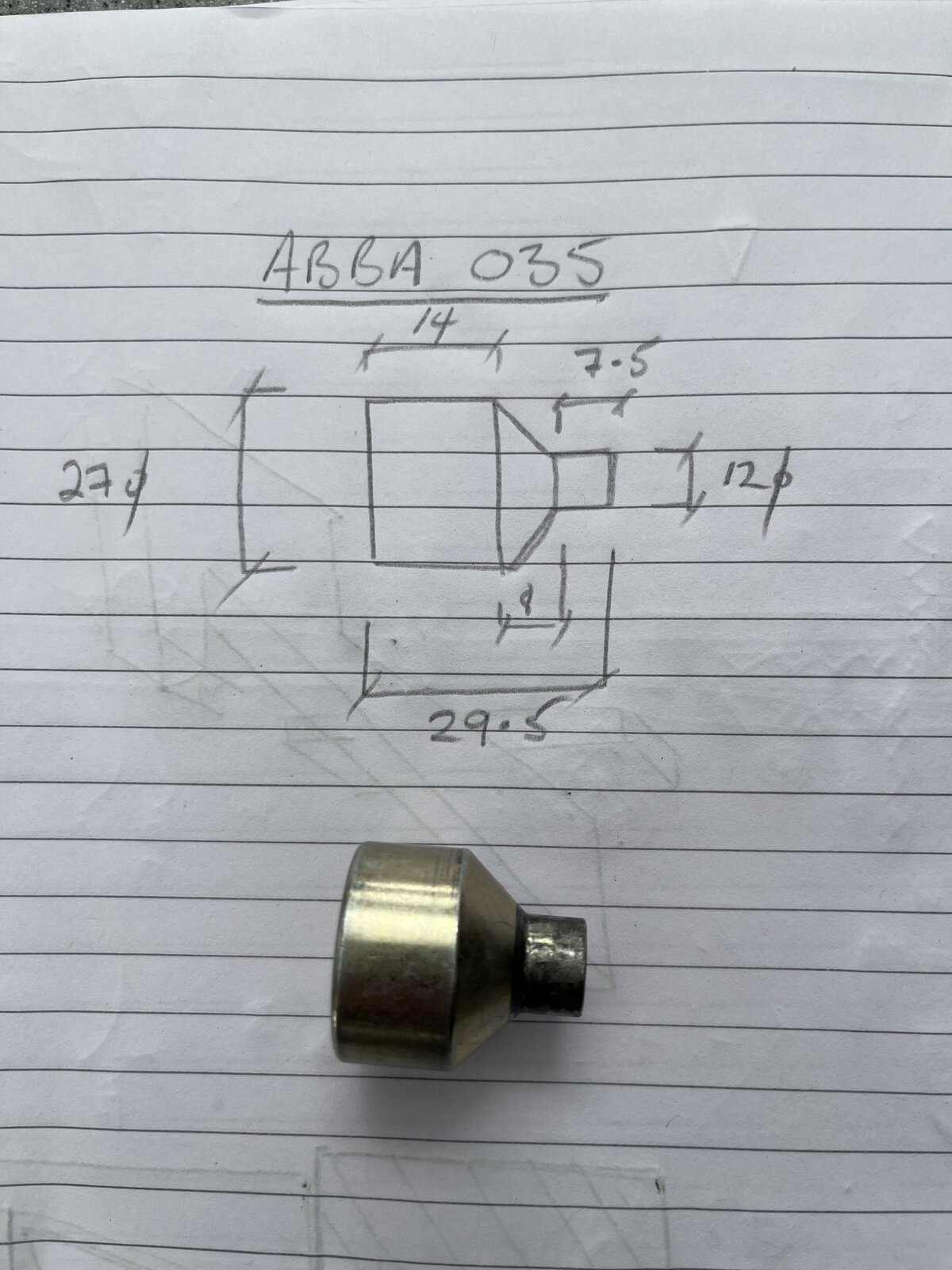

  10. Thanks. Next question, which adapters are you using for the skylift please? ie the code number on them? I've the entire set of adapters from ABBA and I'm buggered if I can find ones that fit securely, it's always a bit wobbly on the lift, to the degree I've just given some plans to the local engineering workshop for them to produce two specific threaded inserts that will screw into the threaded holes at the swing arm pivot point once the blanking plate is removed.

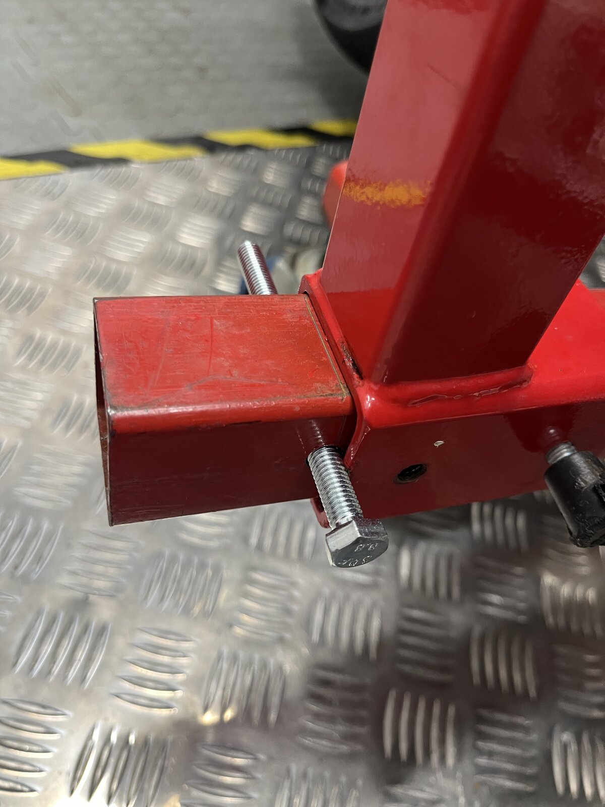

  11. The ones I use are not threaded , but I will do a sketch of the parts for you. I have drilled the cross bar and inserted a pin to lock against the slide mount to make it more solid and can move it arond with no issues in all positions.

  12. I love my abba lift for this, but when I do my application I do sometimes remove the wheels and just stick a plastic bag over the rear brake. Else I'll just cover both wheels entirely with sheets.
    Still, the abba lift is a brilliant bit of kit and I'd strongly recommend to any home DIY'ers working on their bike.
    • Lock Thread Lock Thread x 1
  14. Perfect. Thank you very much.:upyeah:
    Therein lies the problem, on the 2 multistrada V4s I've had the pleasure of working on to date they both have replaced those bolt covers with red anodised variants, so I've been unscrewing that and going into the fitting behind it so as not to damage the anodising.
