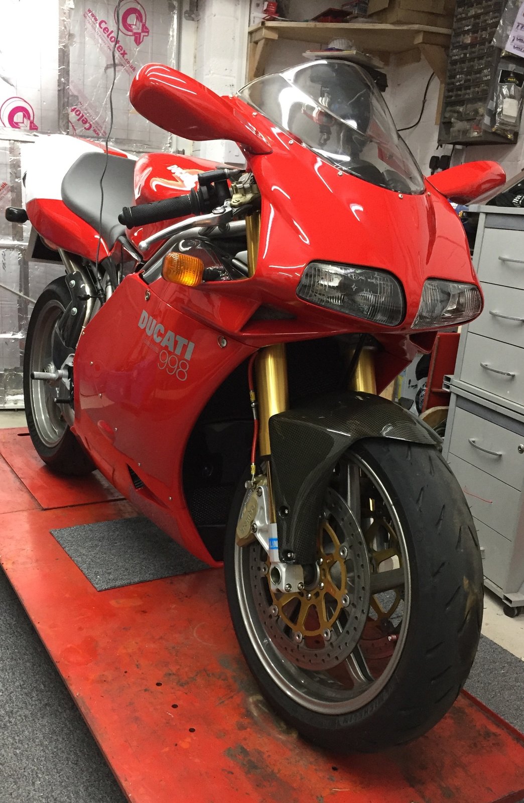

Discussion in '748 / 916 / 996 / 998' started by Wooly46, Feb 17, 2018.
  1. Wooly46,
    Have you 'upgraded' the side-stand yet ? Following from advice on this forum I upgraded to a 1098 side-stand (bought from eBay) and am happy with the results to reduce the scary lean angle.
    I understand that a stand for a 848/1098/1198 all fit a 998 and similarly reduce the lean angle due to slightly increased length. The end pad also has a larger footprint, so reduces the digging effect. See other posts on this forum for more details.
    Thanks for sharing your good work.
  2. I realise your brakes and forks are upgrades but your original pictures are of a standard biposto, not an "s".
    Is it a deep sump engine?
  3. Yes mate, it’s a standard one, not an S

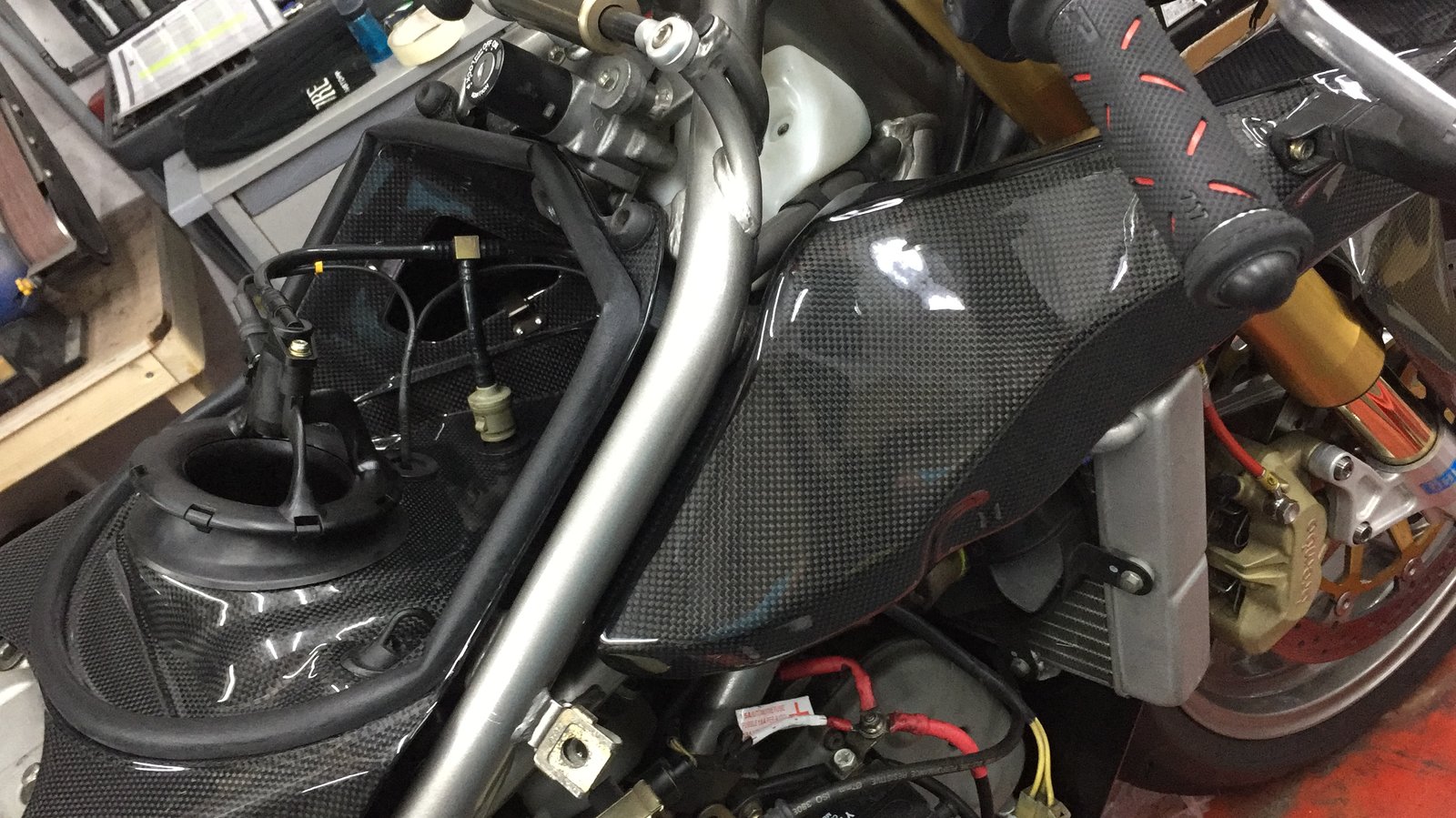

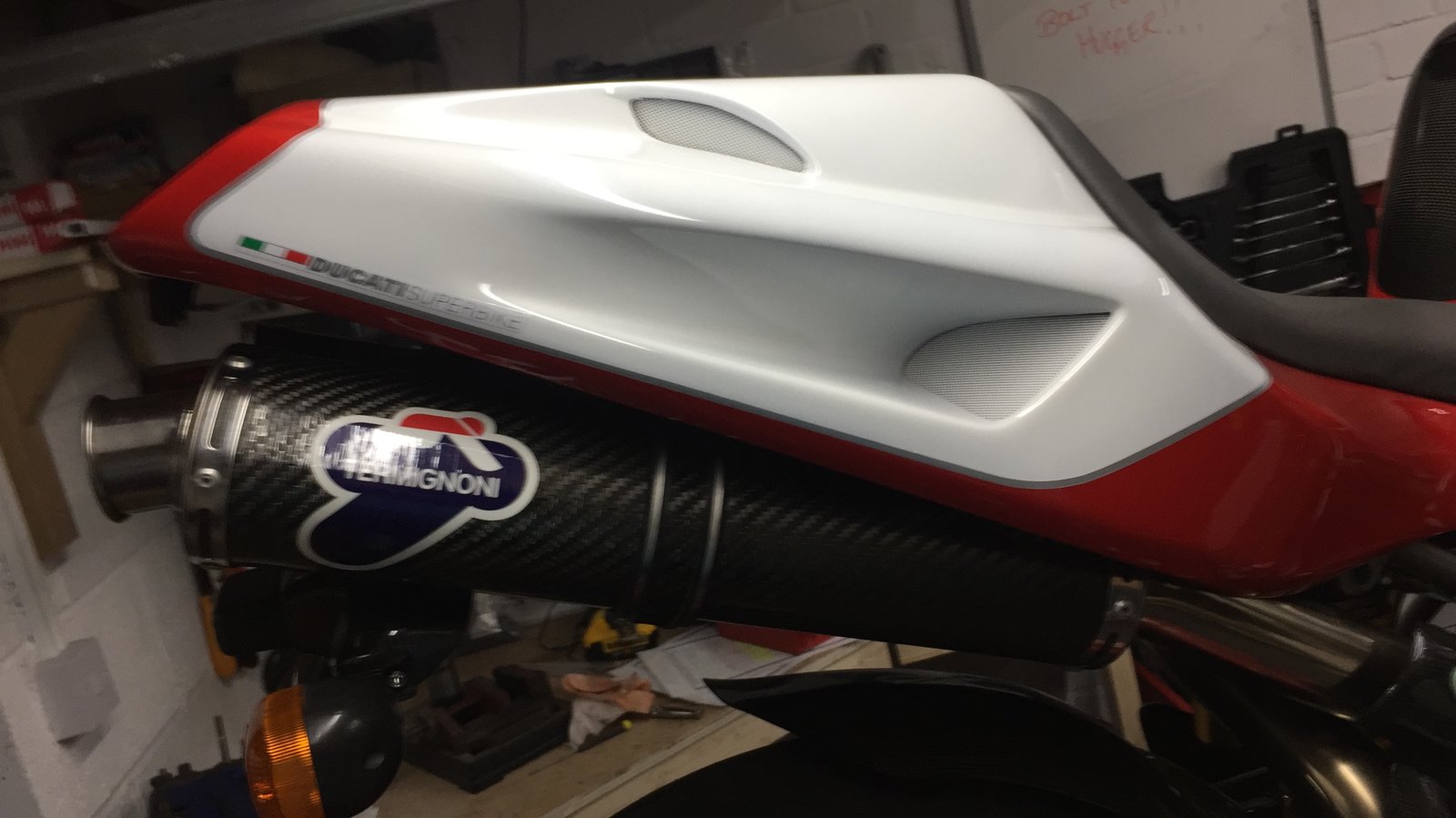

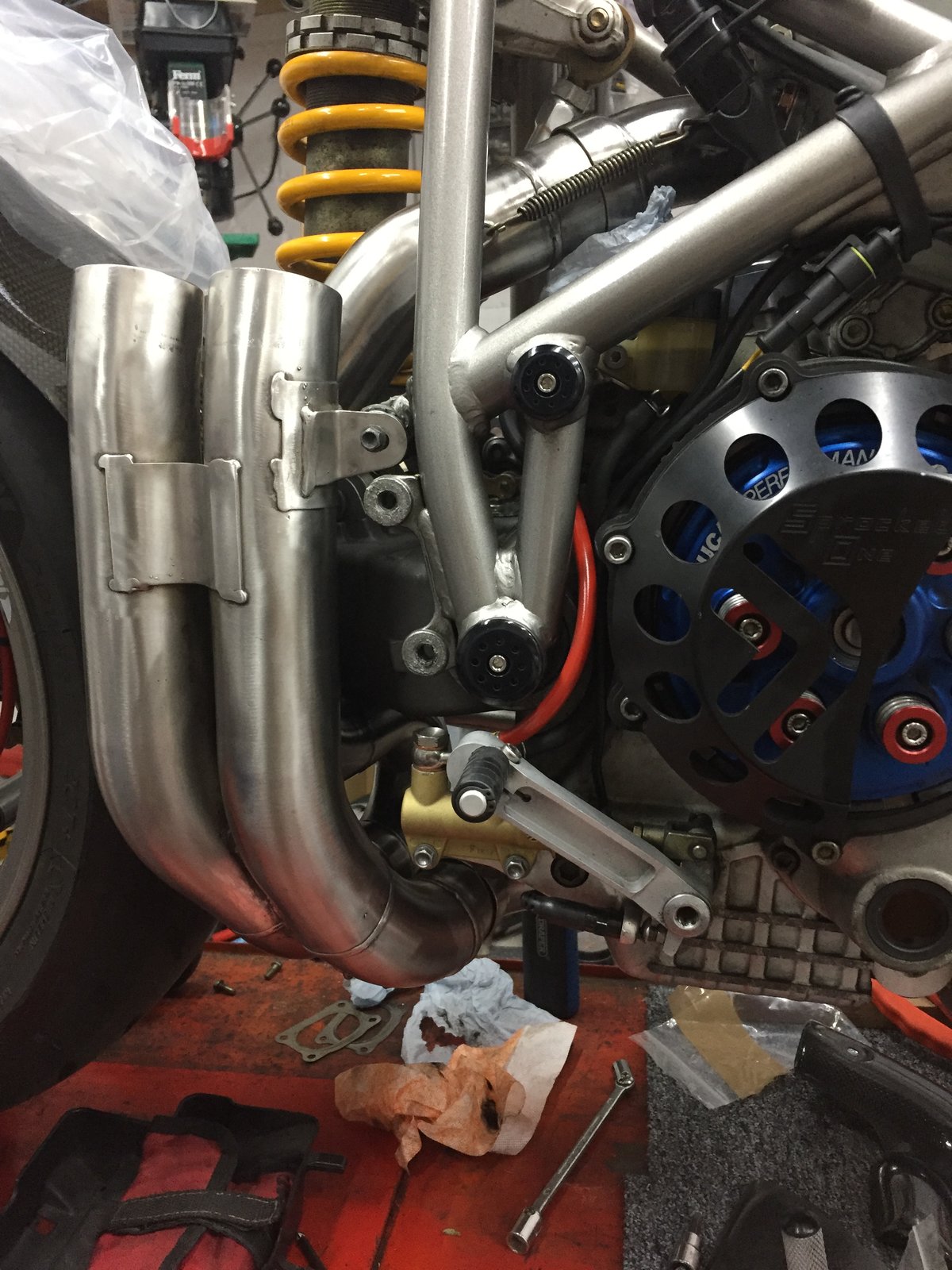

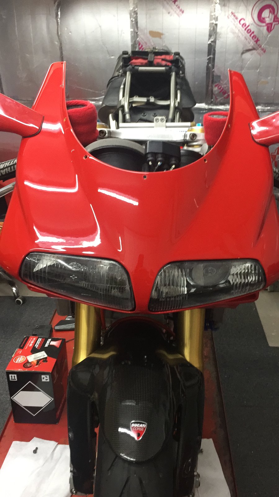

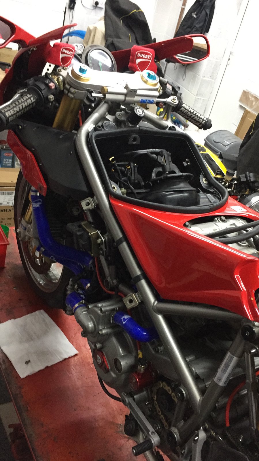

  5. A few more jobs done, I’ve decided to get it back together now as the weather is improving slowly, still waiting for carbon from Spain unfortunately! Ready for fire up tomorrow, love annoying the neighbours :p

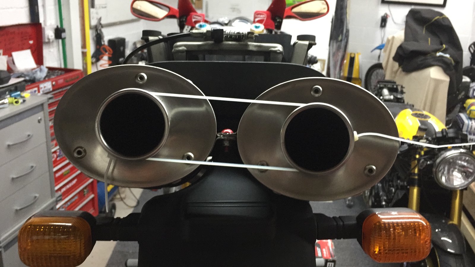

  6. Pissed pipes not good.
  7. Tell me about it! They were bugging the arse off me so a spacer was the last resort! Sorted :upyeah:
  8. Spacer looks good, have you had it set up on a dyno yet?

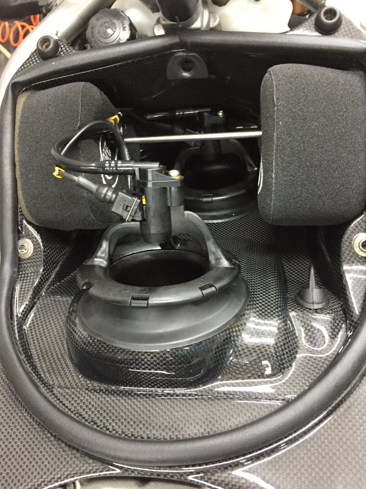

  9. No not yet mate, it’s on my to do list when the carbon airbox and tubes turn up! I’ll be running different filters too so probably get it flashed at the dyno

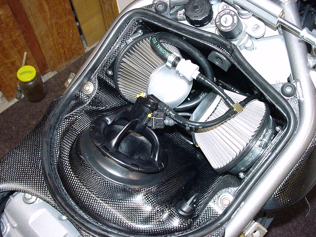

  10. I run a PCIII and JHP filters inside a 996R carbon air box and D.P carbon air tubes with the filter runners removed.

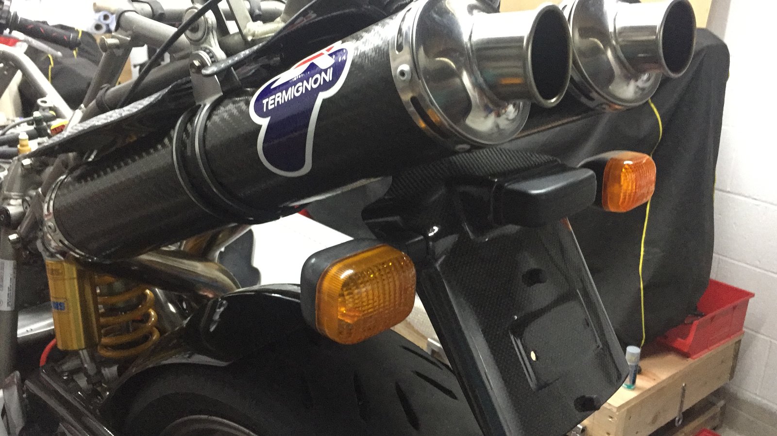

  12. Some more upgrades! It’s never ending this!!!! Now fitted with 50/54mm termis and more carbon :cool:
  13. Nice does she sound any different
  14. Sounds deeper mate to be honest
  15. Jobs done for now, road test it is! Kids, cover your ears :p
