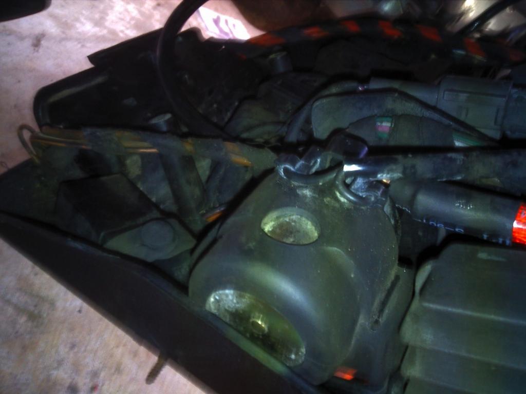

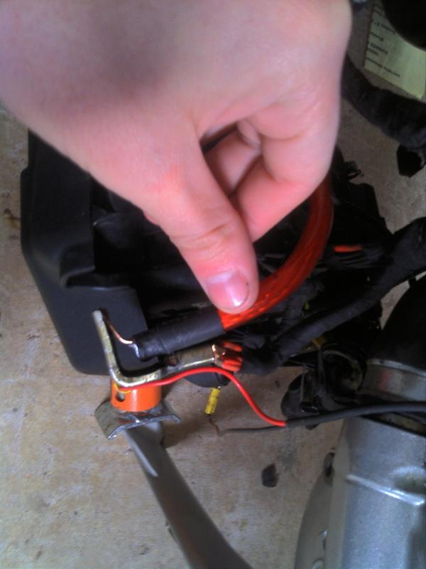

  18. Right, been to halfrauds, got me some new cables, and ready to hopefully get this sorted... So just so you guys know what I have done, here is a few pics of the set up - coming from the battery originally there was a big cable leading to the starter motor, and a number of different ancillaries cables (from both the positive and negative), so I cut the bigger ones off, and then connected the new cables like so...
    Could this cause any issues? This for me was the only way it made sense without making up pretty much a new loom! So negative goes to the block, positive to this thing...
    Then on to the starter motor, nothing else was touched (nothing electrical anyways, I did the R6 throttle mod and stuck on a few carbon bits at the same time)
    The battery was out for a while, now how may this have affected the security devices and how can these be reset? I am doing a big European tour on this thing for charity in a few months, so really need it up and running well!!!
  19. I should just go for it JL - without sounding patronising you must be capable of cloning what was already there? Some alarms need a reset when disturbed by battery disconnection (and probably as an added security measure) but you will soon know when you try to start it normally.
