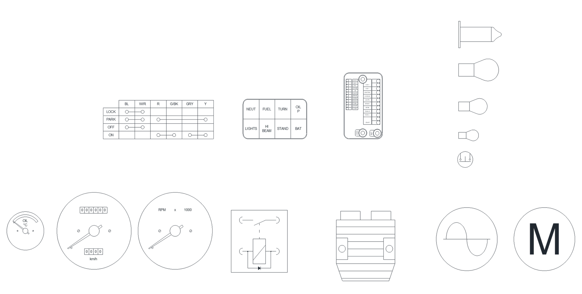

  11. @Duke of Stow How do you rate the imitation Deutsche connectors from chinesiumland, as a pose to Molex?
    I've actually been putting off and putting off the wiring job so long now after getting half way pulling the old one to pieces / zip tying everything etc., I've decided to fuck it, and build a new, neat, minimalistic loom from scratch based around motogadget's mo.unit blue - I needed a motivation kick as I was just avoiding the oem loom so now have taken the plunge and ordered the mo.unit and a few other bits and bobs, but I'm torn between using the molex kit's I have already (from VWP, which might well be chinesium anyway) or going for the imitation Deutsch stuff.
    Based on a vid by Big Clive, who knows his electrical stuff, I am considering going down that route...
    Started my wiring diagram / planning yesterday:
  12. Amphenol do a like for like clone of the Deutsch DT range and are a lot cheaper, I get mine from Mouser.co.uk, The Deutsch connectors can be a bit bulky especially for the low current circuits, so you might have to “cheat” the crimp by doubling over the stripped wire to double the gauge to suit the terminal range.
