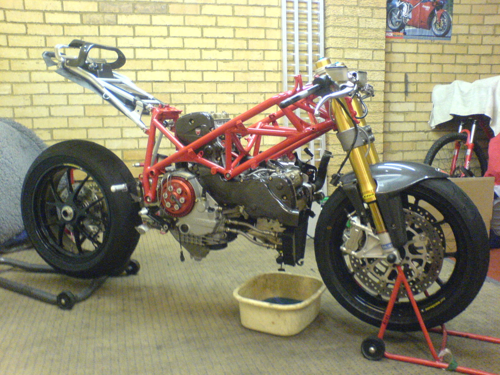

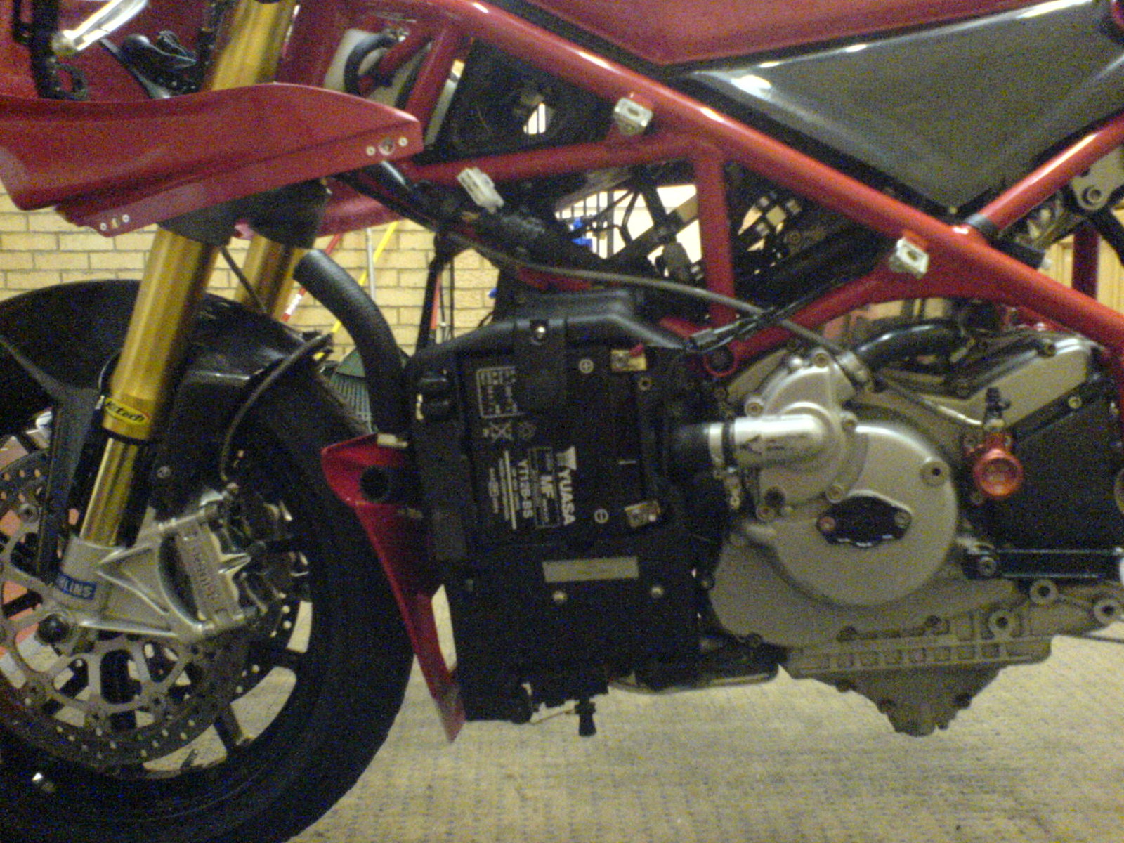

  11. My original 999r engine
    Mounted into a 748R frame with 999r oil cooler
    with a 999r battery box and loom
  12. first time out on track
  13. Sold! lol Andy that is stunning!

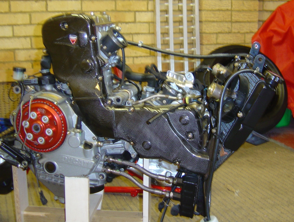

  14. @andyb , the H belt cover with the intake(?), I've seen them before, do they not risk crap getting into your belts area? Or is there a mesh or something? Whats the point as well?

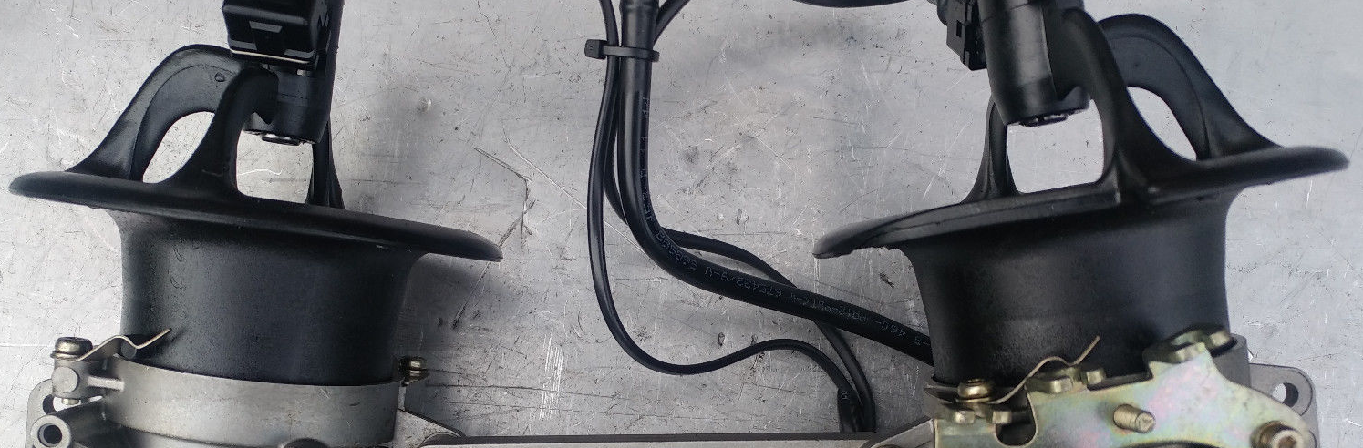

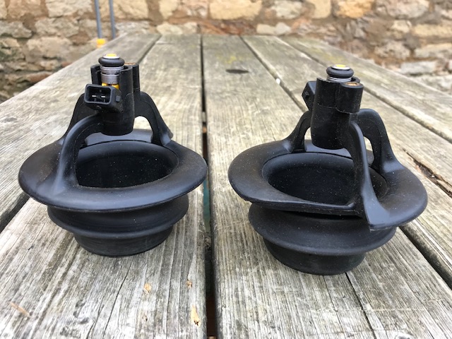

  16. here you go dont say i dont give you anything where shall i send them to 998 injector holders and yellow injectors! IMG_0940.jpg
  17. there is a foam filter on the end they are for cooling the belts as per rs..and adopted by the std 1198 stuff in on the H out at the V
  18. Nice! Thanks
