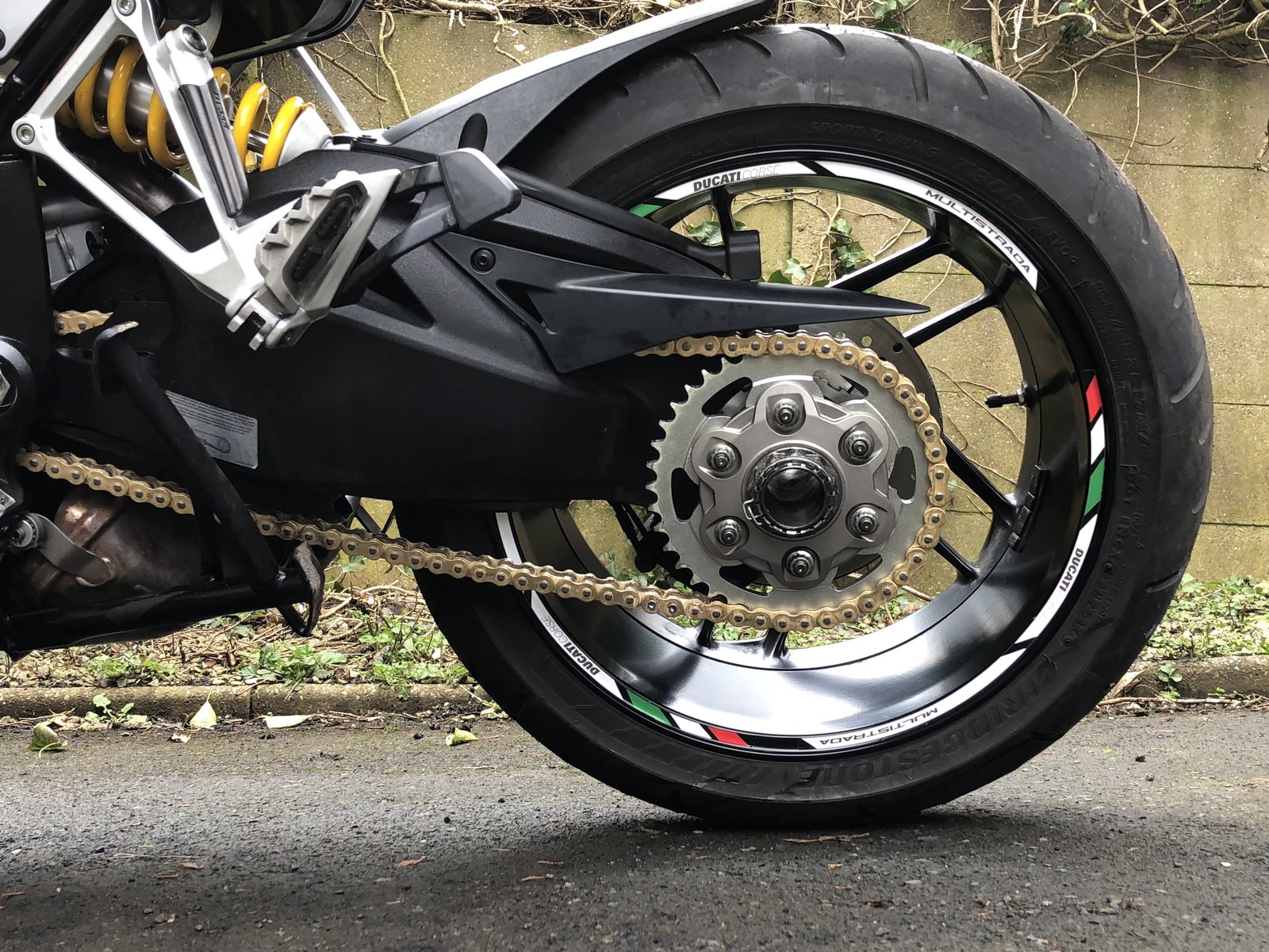

1200 Worn Rear Sprocket?

  10. Done. Hopefully it don’t fall to pieces first time out!?
    Thanks to everyone for tips but especially @Wayne58 for all the tips and advice.
