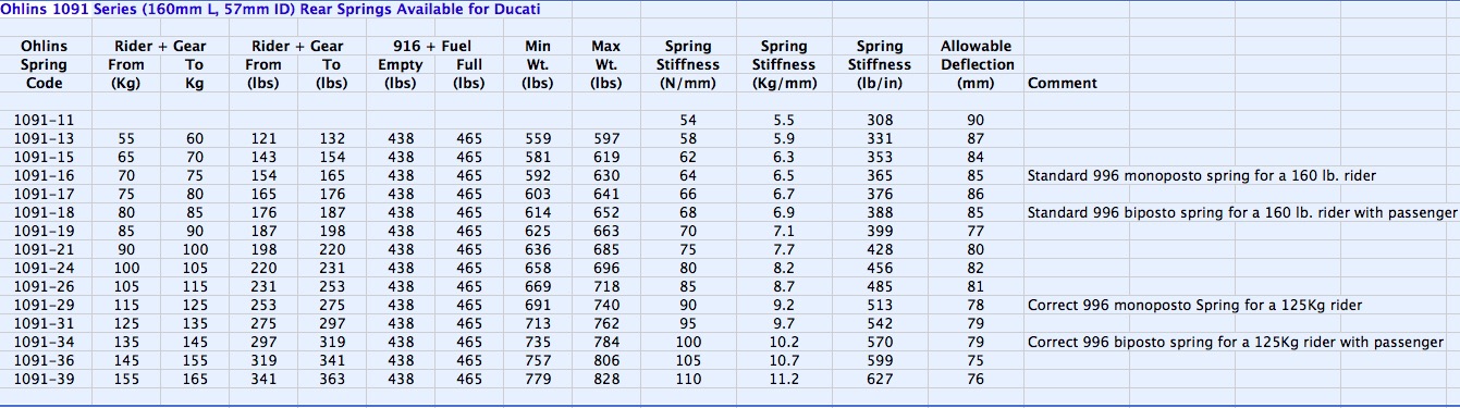

  1. This is an interesting chart.
    Am i allowed to ask where you found it.
    TIA
    TB

  4. It was on one of the forums - possibly this one! There are several similar ones out there on the interweb.
    I googled something like “Ducati 996 suspension settings”. There seem to be a lot of people over the years struggling to get these bikes set up correctly - not helped by the extreme riding position!
    There is a chap called Shazam who used to post some very informative material on topics such as this. He may have been the originator of this chart.
    For years I believed “soft springs = soft ride”, but if you want the correct sag, then often a harder spring will give a better ride.
    There is a very good book called “The Racing Motorcyle” by John Bradley that is really for engineers and not thickos like me, but it explains sag and spring rates beautifully. It really opened my eyes.
    Hope this helps.

  6. Is it the standard rear 80 N/mm spring on an ohlins shock with standard linkage? If so, I would suggest the spring is way too soft, and it needs a lot of preload.
    I am about 90 - 95 kg leathered up and I fitted a 90 N/mm spring to my 1098s - the full length one as there are two lengths of spring that can be used. This, with a touch of pre-load, gave me a fantastically compliant ride.
  7. so Paul, that's a 130 N/mm spring, which is pretty hefty (although it depends slightly on the linkage, length of swinging arm etc). But ] if you compare a standard monoposto spring on a 748/916/996/998, that rating will be significantly lower at around 64 N/mm (although the linkage is completely different of course).
    We can do a lot with preload to get the right laden sag, but if preload was effective and didn't compromise other factors, we would only ever need one spring rate for everyone :thinkingface:

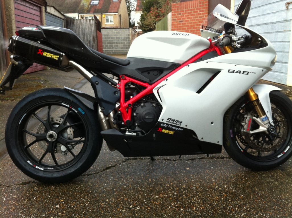

  10. A TTX shock? Yes, that would have made a big difference.
  11. And ohlins forks and matching sterling damper...triple gold :cool:
  12. Lovely!!
  13. Picture opportunity ;)
