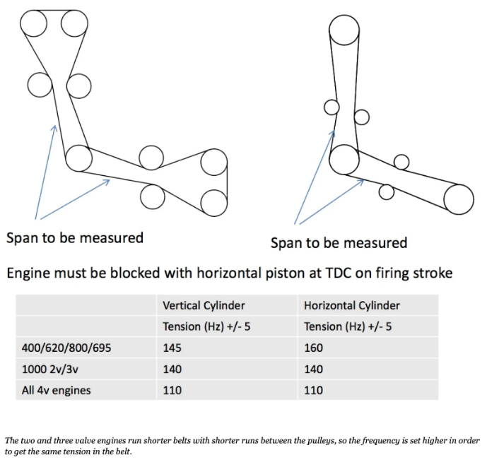

  6. So on my 2021 Scrambler 800, the installation frequency of the two new belts is not 110 but 140? This is really confusing

  9. Yep, different values on different engines, 2V, 4V, DVT etc
