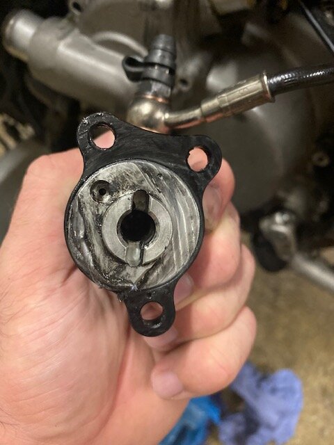

    Also found this carnage when removing my brand new clutch slave cylinder - seems that my chain has been chewing through it .....
    It worth noting that I do have a friend (Qualified Ducati technician) coming to have a look next week but I thought I'd just make a start and save him some leg work

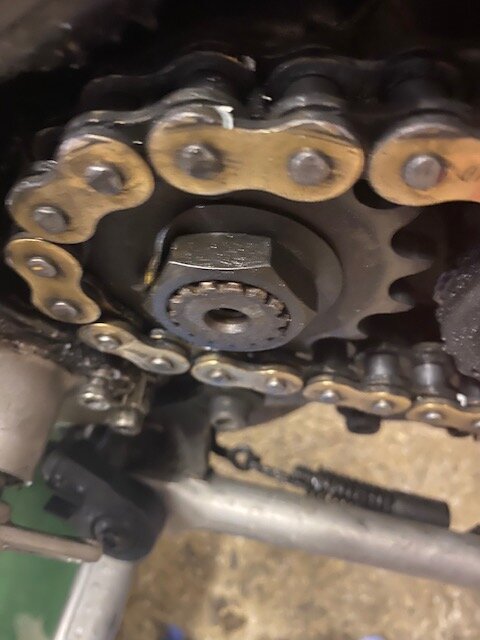

  9. How many teeth is the front sprocket?
  10. 32 by the look of it..

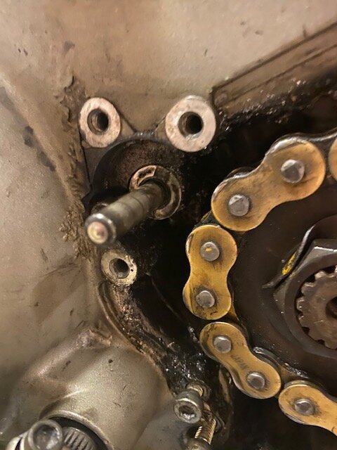

  13. It looks like the M6 screw for the cover has backed out and not allowed the slave to sit flat.
    The screw still appears to be there

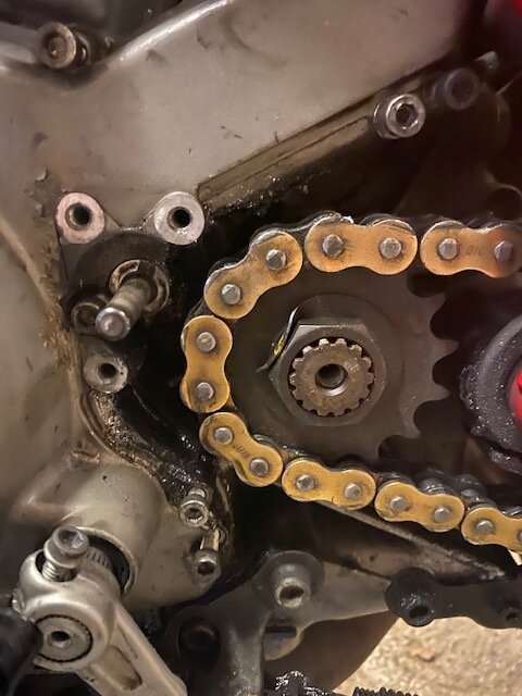

  14. That nut / sprocket doesn't look very far on the spinny thing that turns it. Is it on properly?

    where is the roll pin that sits in the clutch push rod? ( the grooves in the slave are where it sits to stop the rod from spinning)
    Is the chain gold from the picture? Has the bike had chain and sprockets? Who fitted these?
    Is the chain in line ie the front the front sprocket the wrong way around? ( hence answering Creamys question?) This would put the teeth of it out towards the slave.

  17. So I'll try and answer to the best of my knowledge....
    I did the clutch and basket myself
    The chain is indeed Gold but I'm not sure whether the chain and/or sprocket has been changed in the past - I certainly havent touched them.
    Counted the teeth and the front spocket is 15 teeth, definitely not 32 as suggested by someone.
    The chain looks to be inline and seems that the sprocket is engaged properly, maybe just a bad camera angle earlier?
    The question about the roll pin .... not a clue, and assume thats maybe where the issue is?
  18. so the chain will be close to the slave but obviously shouldn't touch the sprocket nut look ok from that picture, there can be shims behind the sprocket and a spacer
    does the chain have a size on it ? Should be 525 as std or 520 race...
  19. I'll definitely have a look but I'm certain that the issue isn't with the chain or sprocket as there was no damage to the old slave cylinder when I removed it - was just leaking.
    And to be honest I dont see how I could have fitted the new one incorrectly as it's pretty much just 3 bolts and a straight replacement...... ?
