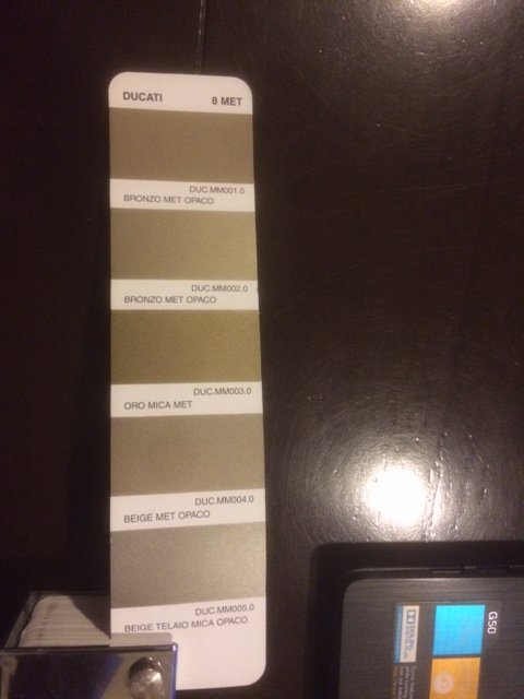

  11. Ok time to revive this thread as the bike heads out to the paint shop on Monday :D:party::party::party::party:. Bolts are away to the zinc plater and I have collected all the parts i needed.
    I seek your infinite wisdom for the original paint code for the frame and fairings I know cajiva used a different red on the early bikes but I can’t find a code for it. I believe the bronze for the frame is all the same.
    anyway how’s everyone been :joy:

  13. From what I have read so far I thought ppg 473.101 was the colour for 2001 and up Ducati’s or am I wrong? or is it the same as the 94 bikes?. My brother has a 97 916 and ours are different colours mine has a more orange look

  16. The early bikes seem to have a darker, almost blood red. Was it called Rosso Corsa? Code still shows 473.101.
    I could be wrong, but I don't think they're painted. Pretty sure the gold is the actual colour of the magnesium alloy.

  18. I dropped the parts off yesterday and my painter has a paint camera so he is going to go by that. He recons the paint on the tail unit is still very good and ideal to match from
  19. Ah ok. If someone else knows what color is a close match, I'd love to hear it!
