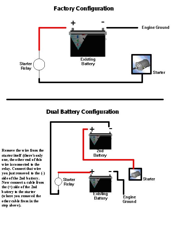

    So i'am looking for other solutions, and i think i have one. I have read that you can change the voltage of the starter system to 24v with two batteries. as the picture:
    i think it would be a great solution but i think if i do it like this all the electric would be gone. But i don't know the solution.
    Does somebody have experiance with this?
    Thanks!

  3. Limited space for a second battery and the starter would have to be re-wound for 24 volts.

  8. I can see your thinking on this but it is likely that you will quite quickly burn out the starter motor. You seem to have tried most things but have you considered that the problem could be in the starter motor itself, they are usually pretty reliable but it may still be worth having the internals - brushes, commutator and windings checked out or get a known good motor and swap it over.
