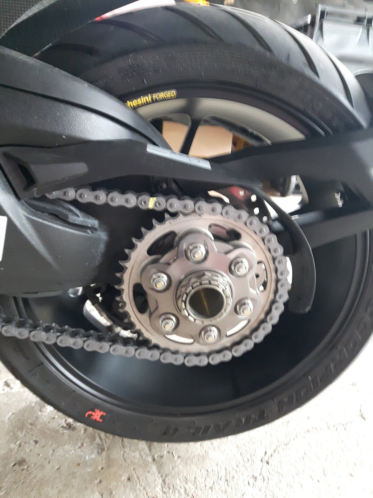

  5. So I did my first chain adjustment yesterday. Followed the advice here plus the owners book (which isn't that detailed or user friendly) and go the job done.
    My only confusion was the exact positioning of the supplied steel gauge. According to the book, the curved notch on the metal should go where the centre screw of the plastic chain guide screws in, is that correct ?
    I've seen pictures where people have them slide further along towards the rear sprocket, and that would make a difference in your reading.
  6. Yes that is correct :)

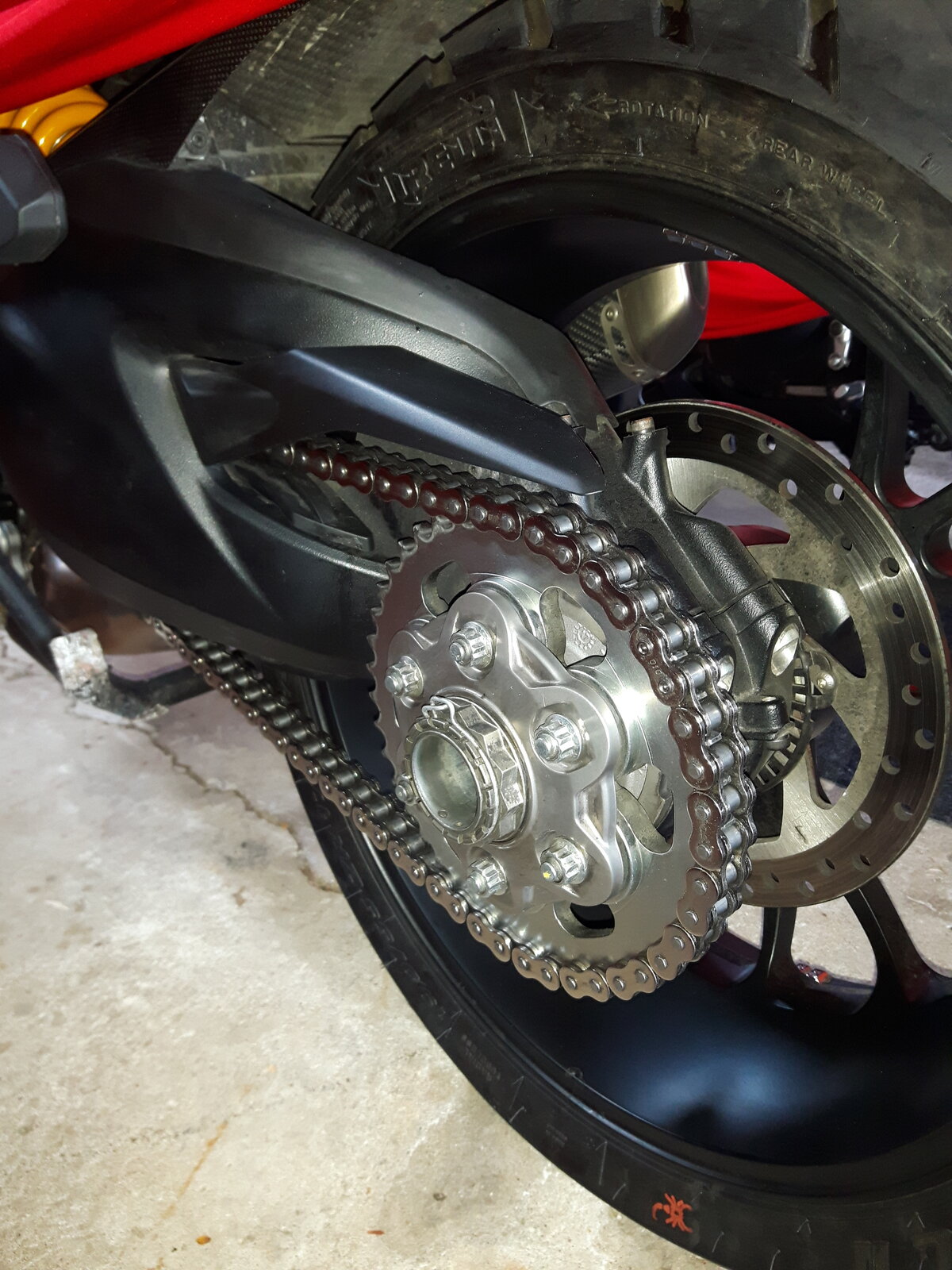

  8. Time, for some new chain sprockets…. Going for some bling on the chain but need some sprockets to match, anodised anyone??

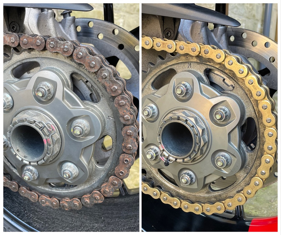

  9. Having recently purchased my 1260S, the chain is looking a bit crap, and having been out a couple of times, is definitely suffering from some rust. I was going to look at trying to give proper spruce up but saw the threads about how easily the OEM chains rust.
    As it's booked in for a service and first MOT at the end of the month and looking to get them to fit a new chain. Is there much point in changing the sprockets as well? The bike is on 5.5k mileage.
  10. No mate. Save your pennies. Andy
  11. Fitted the same to mine, except I paid quite a bit less than £146... Bought off of eBay here, was £99 something in September.
    And yes, will fit your 1260 with standard sprockets.
  12. At only 5500 miles I'd give it a good clean, the rust will come off, and keep it coated in lube/oil so it doesn't rust again.
    You should have 5-10k miles life left in that chain.
  13. Tried a little in getting the rust off but decided I needed the bling so got it fitted at the service last week.
    Thanks for the link, paid £109 so much better.
  14. A bit of GT85 would bring that sprocket up a treat.
