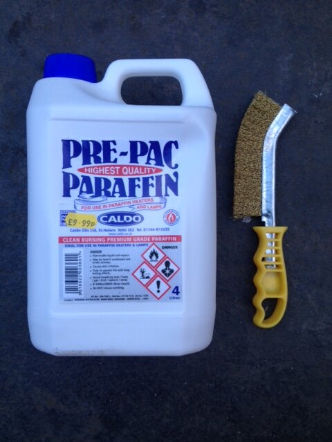

  1. From my initial attempts in the failing light, the chain has started to clean up well. There is some pitting which can't be removed, but it looks loads better. already I'll take some pics in daylight.
    Thanks for all the advice.

  4. I read something on another thread about this and you shouldn’t use a brass brush as it reacts with the chain metal. It recommended using steel wire brush only

  15. Any product that will clean the grime off a chain has to be solvent based and that solvent will in some way small or otherwise damage the O or X rings as the rubber ( for want of a better word) does not like solvent
    The use of those U shaped brushes just rags the O or X rings and seriously reduces chain life
    I am very Anal with chains and expect to get the best part of 20K from them i clean them every thousand miles with SDOC chain cleaner and lube after every ride with SDOC white chain spray ( these products are the very best that I have found the cleaner is particularly brilliant, spray it on leave for 15 minutes, hose off gently and then in my case dry it off with bike dryer and then run it through a soft cloth so it is polished and dry before lube

    Any how paraffin, dry off completely and then the magic detailing secret, flat carpenters pencil, the soft ones chisel point and rub over the side plates. Looks lovely and black, acts as a lubricant, soft carbon, non abrasive and fills in your little pits. No wire brushes in brass or any other metal. Get a shoe shine brush with natural bristles. Or a hair brush for that Brylcreem moment.
    O rings don't like being rubbed up the wrong way, they are soft, just like me. Lube with a low fling gearbox oil from a dripper inside chain to out. EP 80/90, cheap as chips and as good as any overpriced spray can.i carry a little ear dripper bottle with about 25ml of oil. lubricants do not need quantity, just be in the right place. Not like me.
