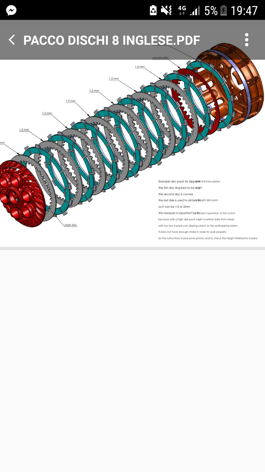

  17. I know this isn’t your clutch but it does have useful diagrams. Andy

  18. That'll be her.

    For some reason i followed the attached recommended stack and it would not even give me use of the clutch the back wheel wouldn't spin when i engaged it into gear so i added a couple of 2mm plates and removed a couple 1.5mm plates.
    Again still to loose.
    The only way i could get the back wheel to spin when in gear and stop spinning when i engaged the clutch was adding a 1.5mm steel plate in to the stack.
    Now if you look at the drawing it says put a friction plate in first but because i needed to add an extra 1.5mm steel plate to the stack i put that in first before the friction plate.
    My question is will this be okay?
    Or would i be better to buy some 2mm steel plates and remove 3x 1.5mm plates within the stack and add 3x 2mm plates which would give me that extra 1.5mm needed and would mean i could remove the 1.5mm steel plate from the beginning of the stack?
    I hope im.explaining this okay.
    Cheers
