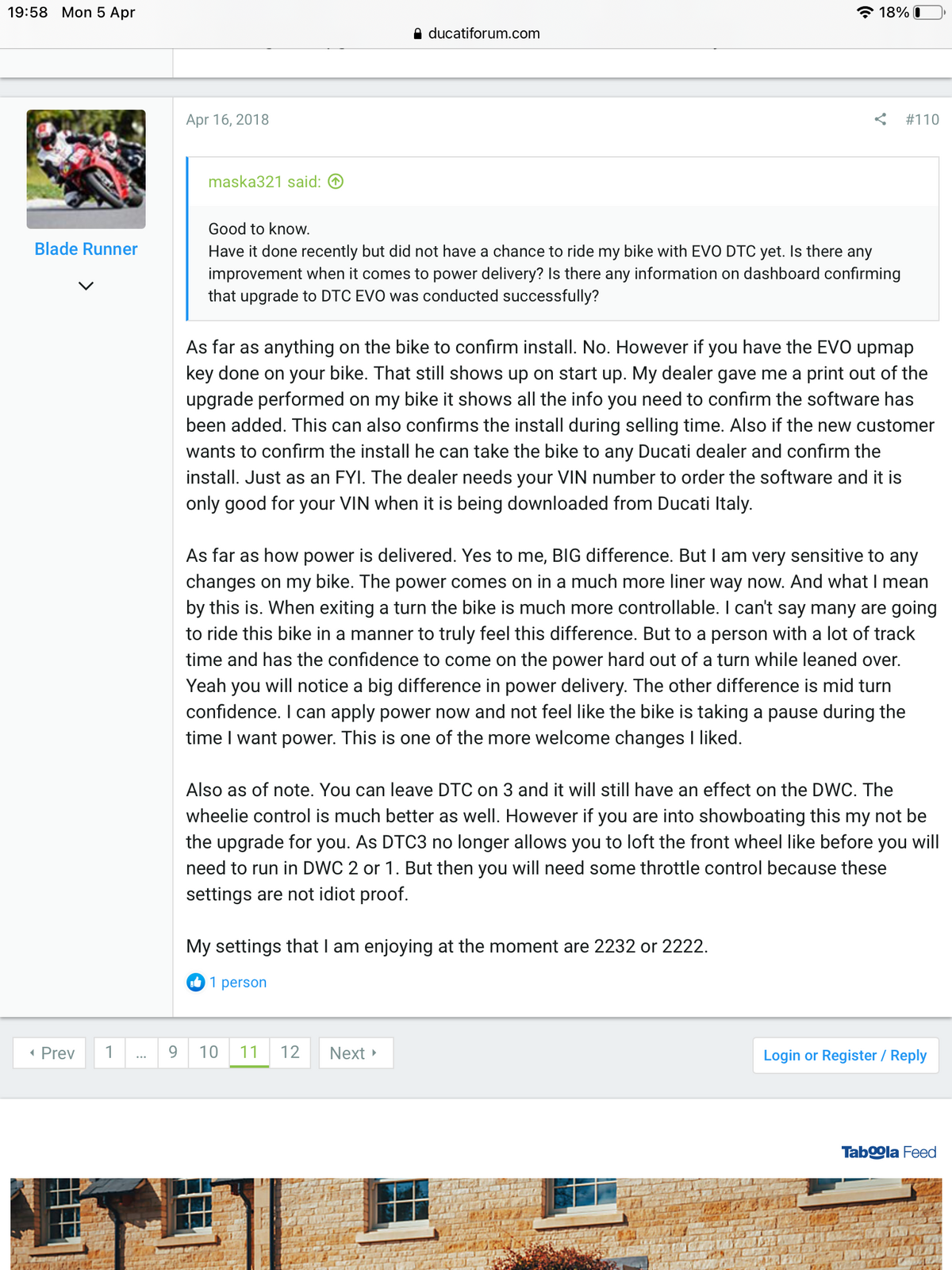

  9. From the DucatiForum.com
  10. Thanks ... seems about right..

  11. I bought a 2016 1299s and as part of the deal i have the Evo update later in 2017 when it was released as an option.
    if your tracking the bike I would 100% recommend it as it the TC engagement is a lot less aggressive than before, and the bike feels more settled coming out of corners on the gas.
    i was told the only wat to check if its been added is to confirm the firmware details with ducati
  12. Cheers, you have just made me have to find my reading glasses and my handbook. Spin on demand or sideslipping as it says in the handbook is only available when you have the DTC on 1, 2 and 3 in race mode and 3 in sport mode. Also I think the earlier than 2017 bikes that were updated to the evo software do come up with evo on the dash, but the 2017-onwards dont as the standard software was pinched off the earlier Superleggera and was standard from the factory. I must say though that im not brave, my settings are DTC 5, DWC 5, EBC 2.
