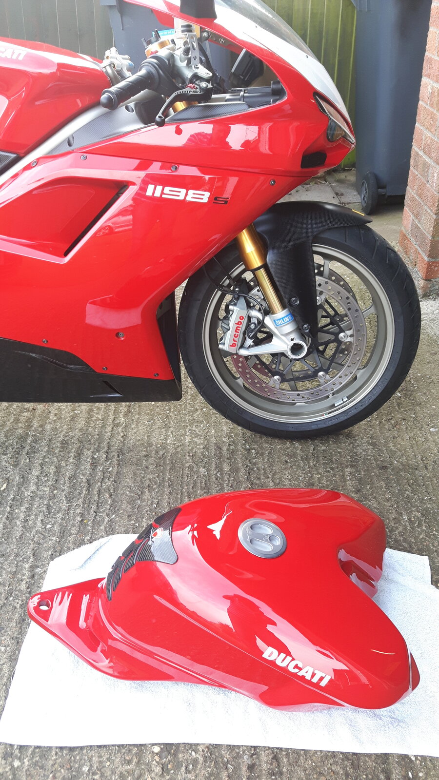

  5. Got my tank back from the painter yesterday, hopefully fitting it at the weekend...I'll see how I get on but might be back on here asking for advice if I get stuck... 20190927_090718.jpg

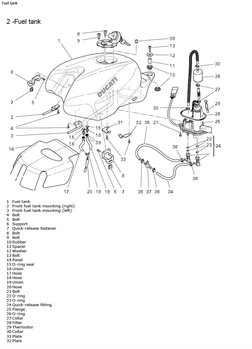

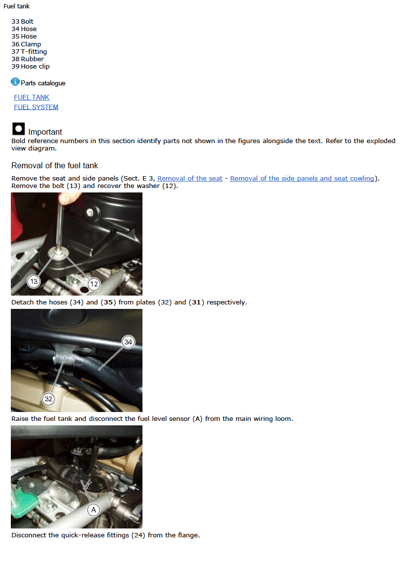

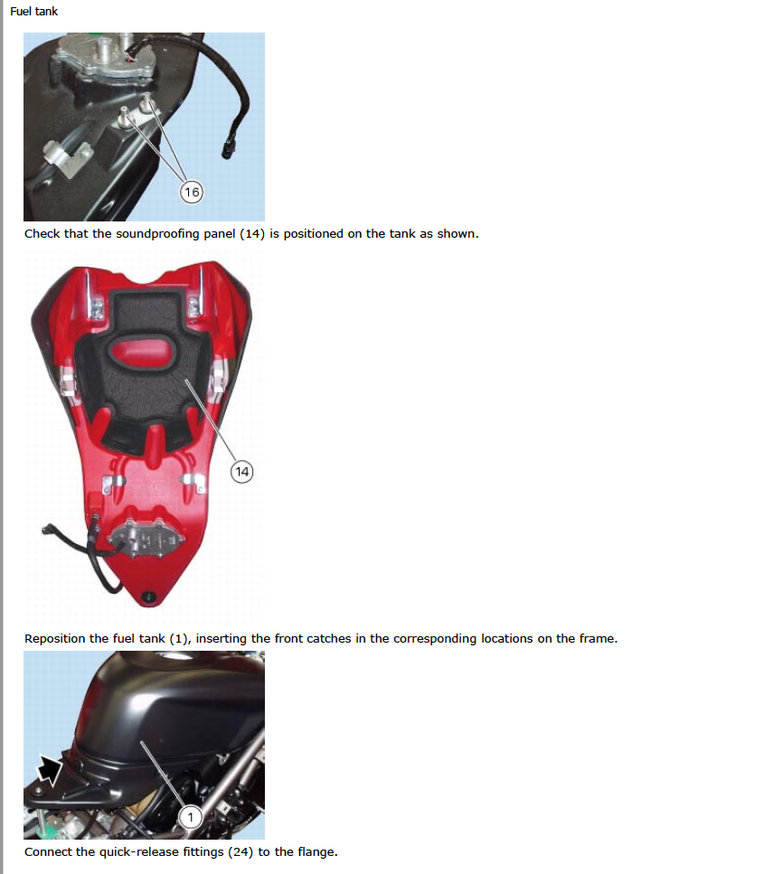

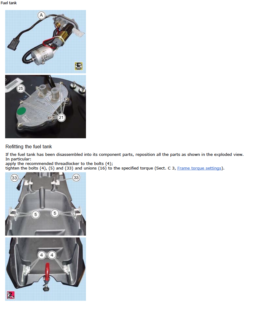

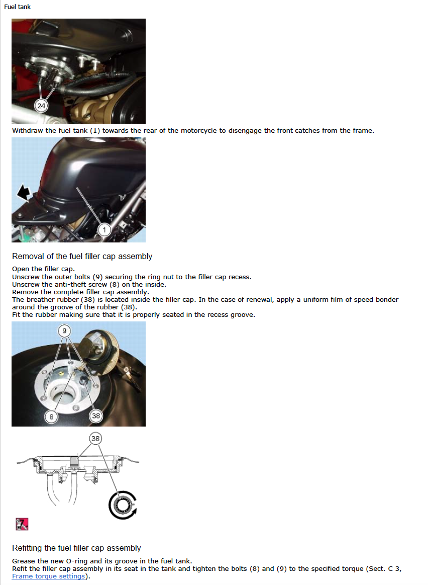

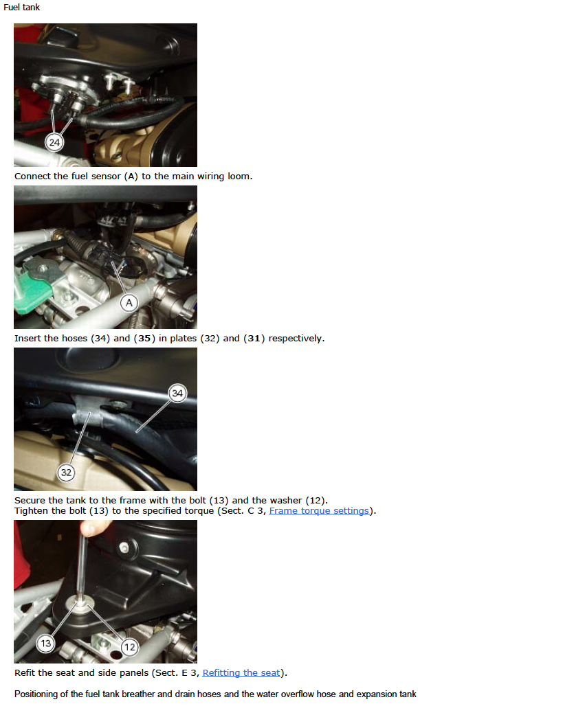

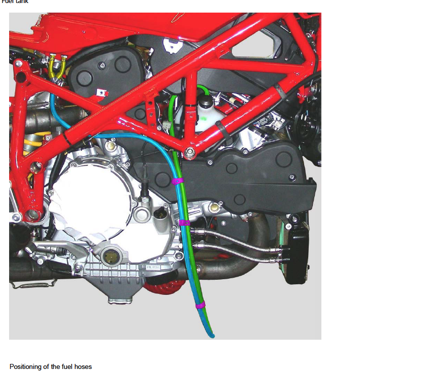

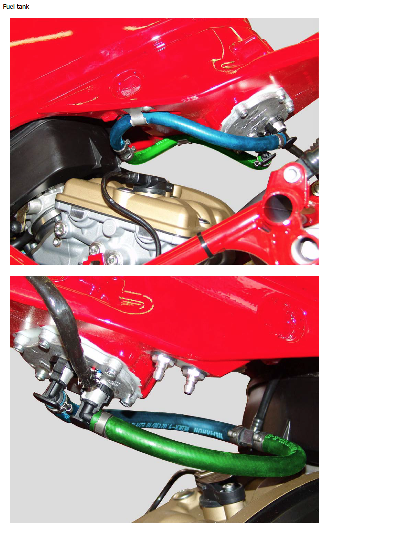

  8. Here are the relevant pages
    Screenshot 2019-09-28 at 17.30.24.png Screenshot 2019-09-28 at 17.30.27.png Screenshot 2019-09-28 at 17.30.30.png Screenshot 2019-09-28 at 17.30.34.png Screenshot 2019-09-28 at 17.30.36.png Screenshot 2019-09-28 at 17.30.43.png Screenshot 2019-09-28 at 17.30.47.png Screenshot 2019-09-28 at 17.30.50.png

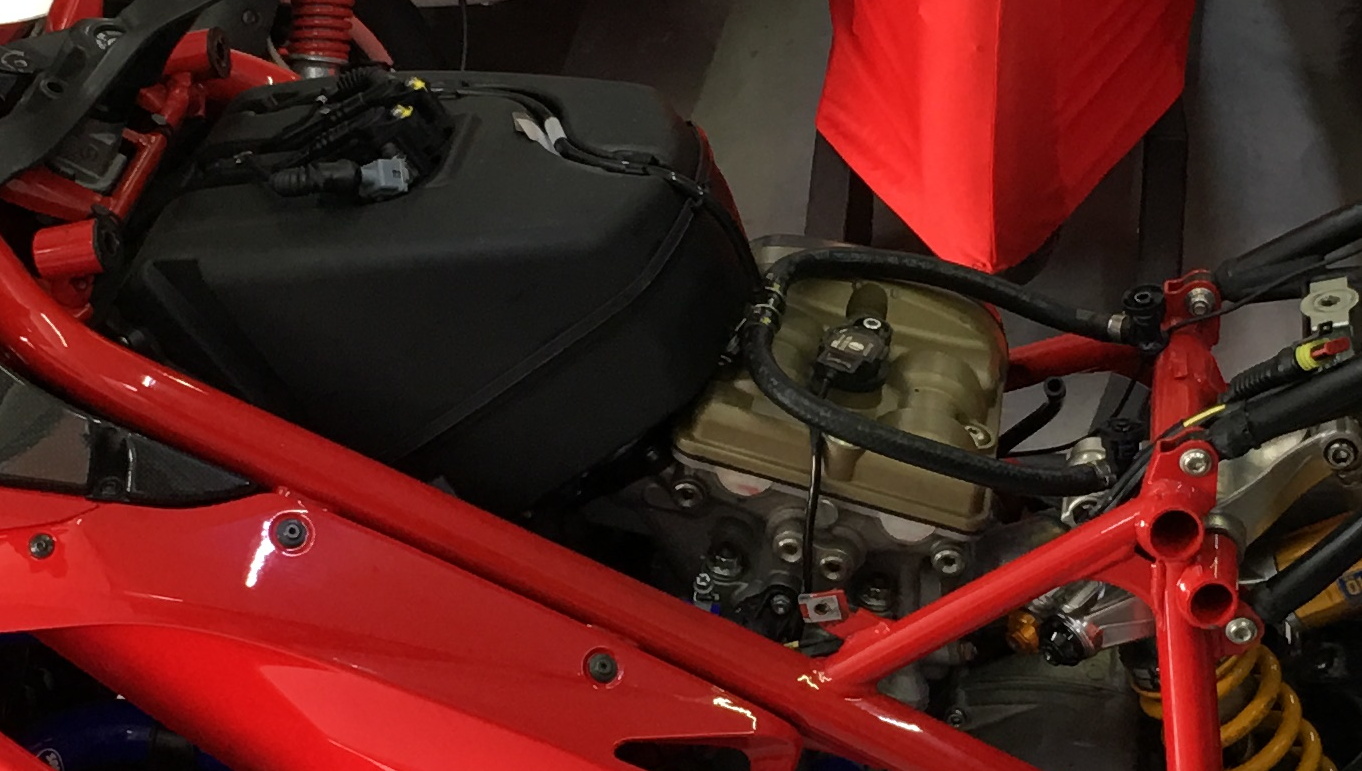

  9. Brill...just a quick question...I'm working on the right side of the bike and I can't remember which fuel pipe went In which union, I think the pipe nearest to me went into the forward most union but I don't want to fuck things up.
  10. I'm not sure it matters as it's basically just a recirculating system to get fuel to the injectors. I could be wrong though and the unions are labelled IN / OUT. o_O
    They should lend themselves to going back onto where they came from and on my bike one is slightly shorter than the other. :bucktooth:
  11. Ok I will double check that the shortest pipe goes to the closest union.
  12. Just checked and it is how i thought, from the right side of the bike the pipe nearest to me goes into the most forward union ,not sure if its marked In or OUT but I primed the pump a couple of times pressed the starter and chuff chuff kabooom...rattle rattle.:D:D
