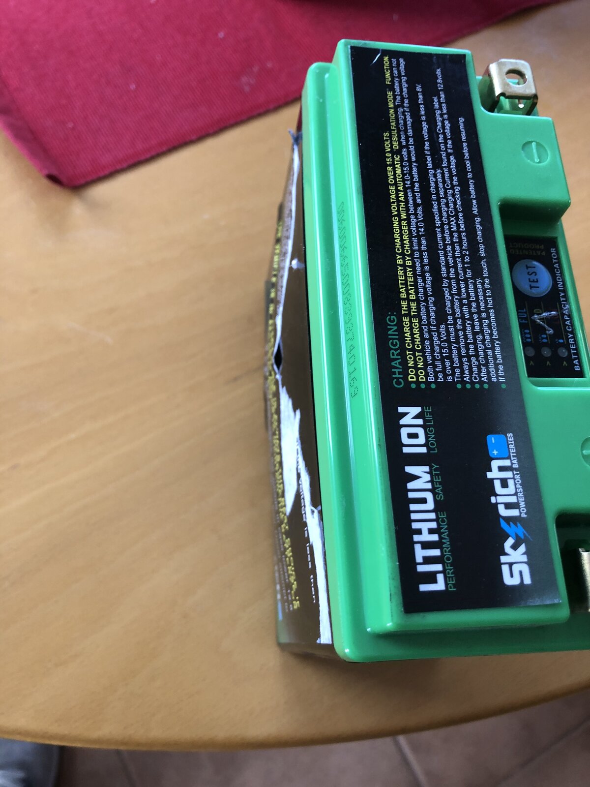

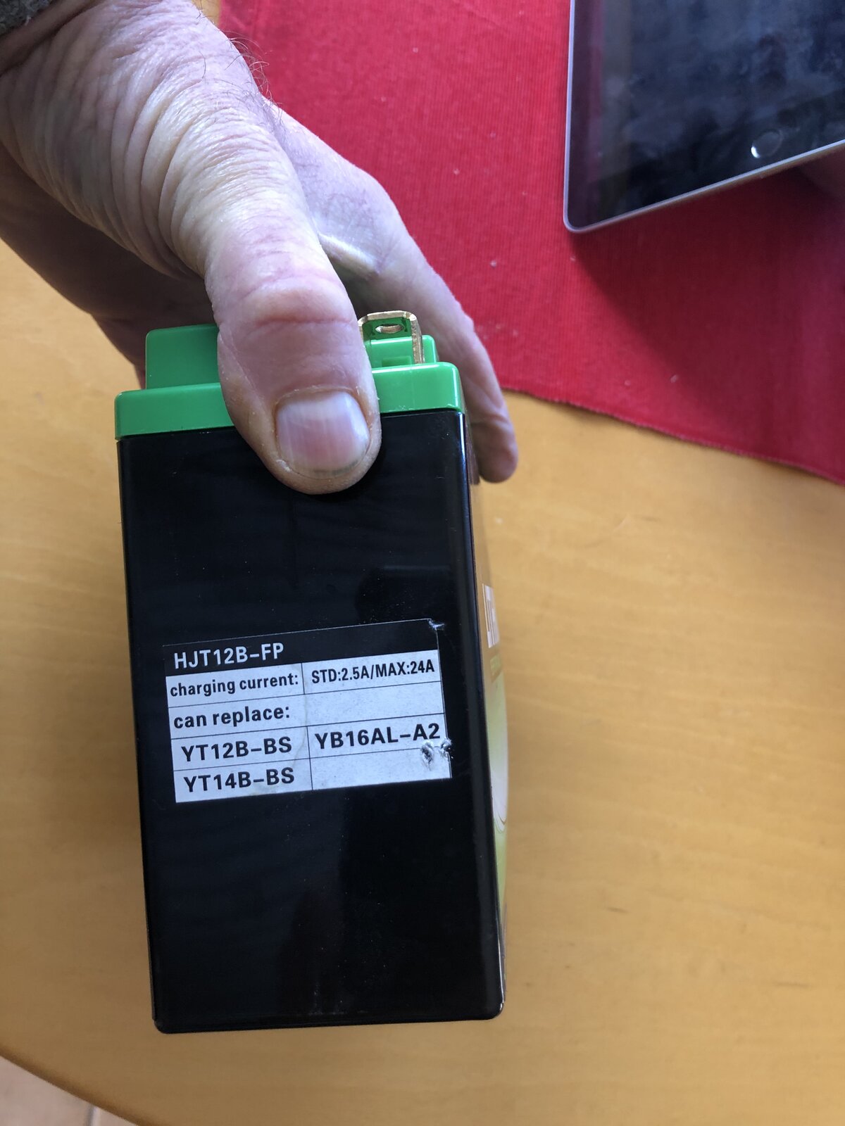

  4. I have been a supporter of lithium batteries and put one on my 749 a few years back, great starting which was always a problem. So here’s where I have to eat shit because this weekend its time to start up the 749 and thought to charge it a bit first but after a while went to start and 10v show on the dash, so keep charging over the weekend and still no go, pictures attached show why, the battery has blown inside only happy I don't have the house fire to put out!
    Note that this happened during charging from a proper lithium charger, not though bike use, battery is around 3 to 4years old. As much as I like it I will not fit the lithium unless I change the charge system on the bike, and then that does not make it safe as my IPad blew in the same way, so I reckon not to leave on charge when you are no close by.
  5. Also worth a note reading though the comments here, Its been bloody cold in the Garage over the winter and is still cold now in the garage, and may have been the reason. Life at the bottom of the Alps!
