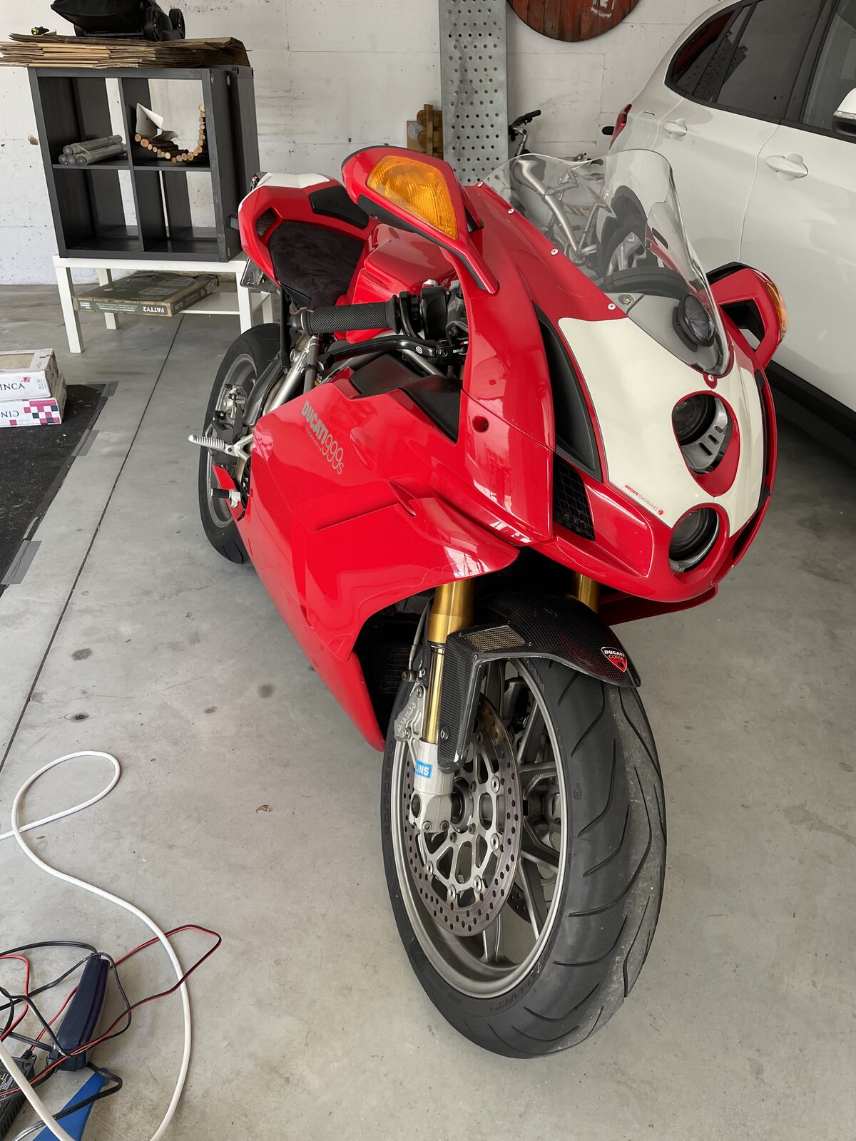

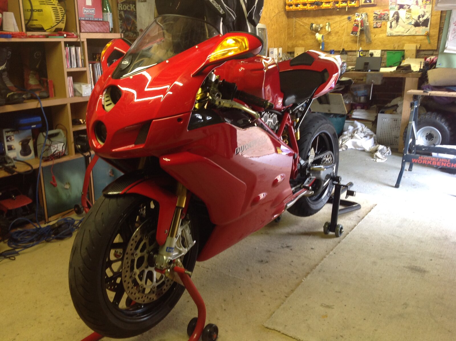

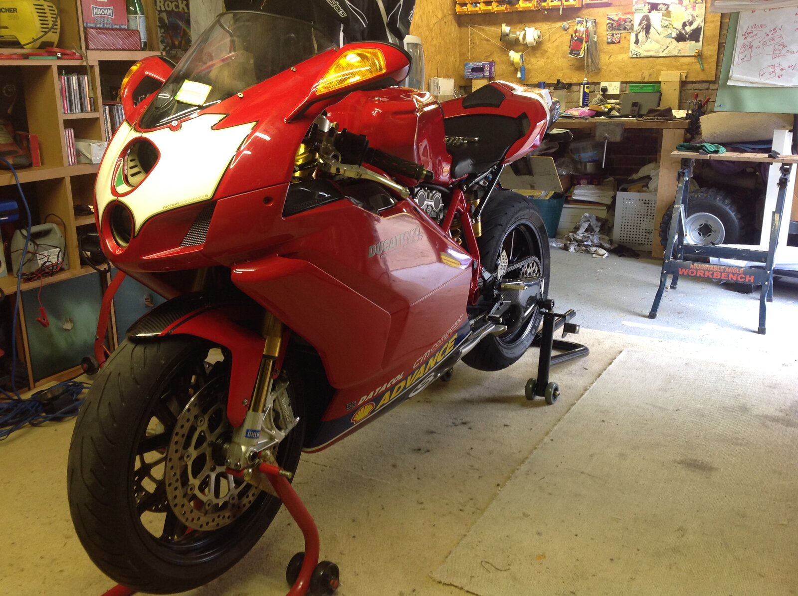

  1. Your fairing options.
    999s in 999r fairing.
    Then back in 999s set up.
    The 999r cockpit fairing doesn't quite mate up with the 999s lowers perfectly. Also the 999R is slimmer - hence the 'bulges' in the side panels and of course one piece winglets.

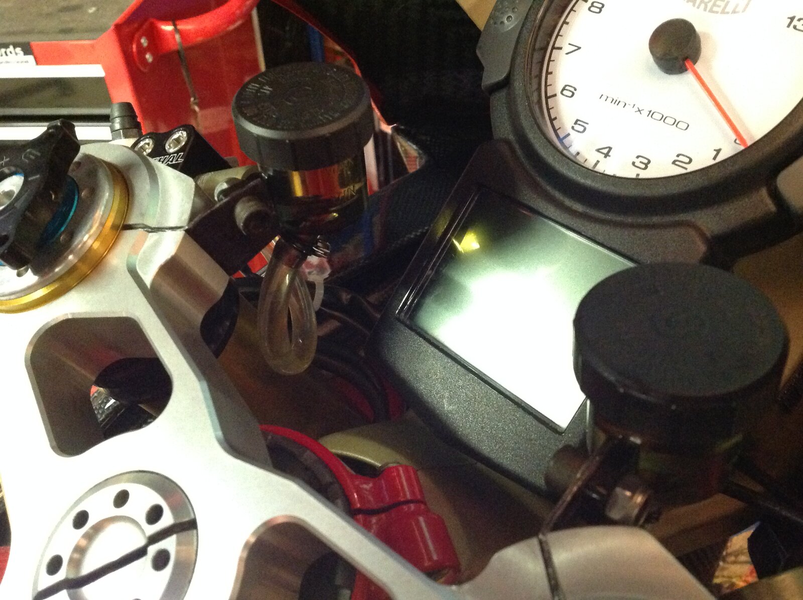

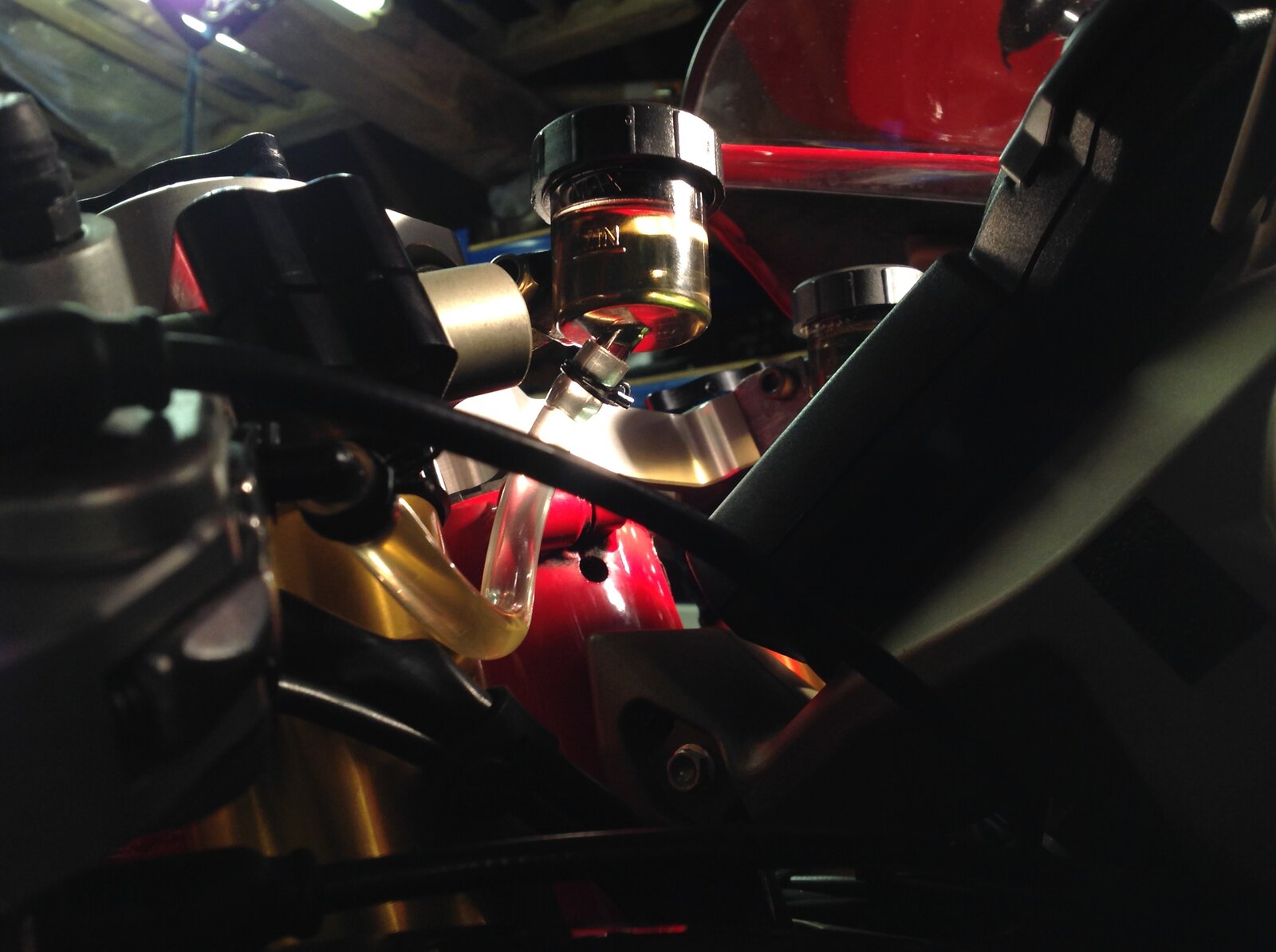

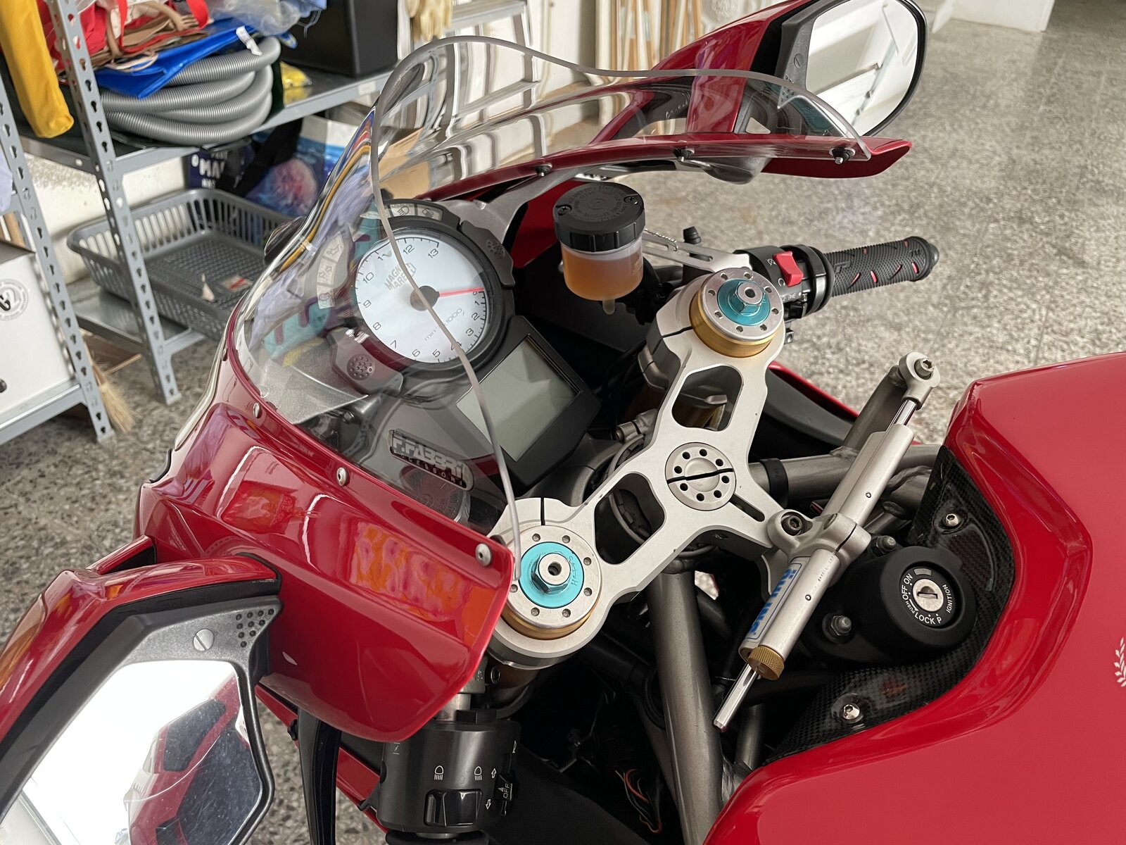

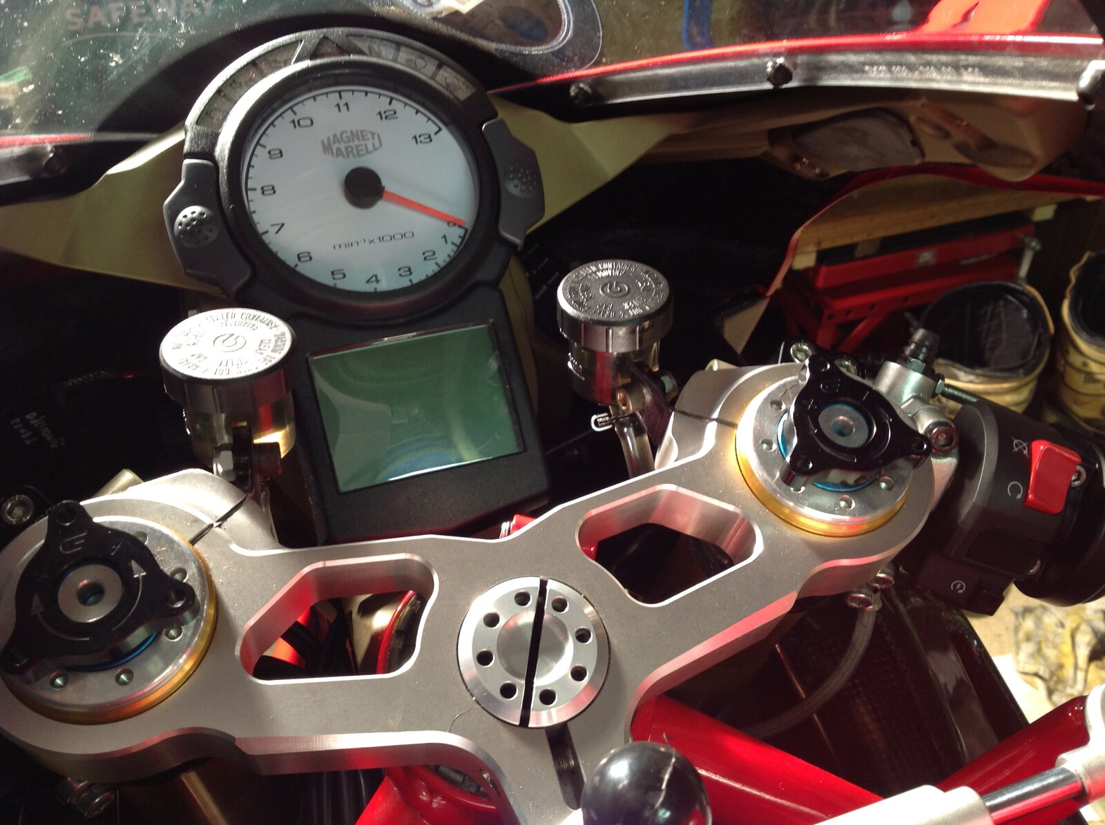

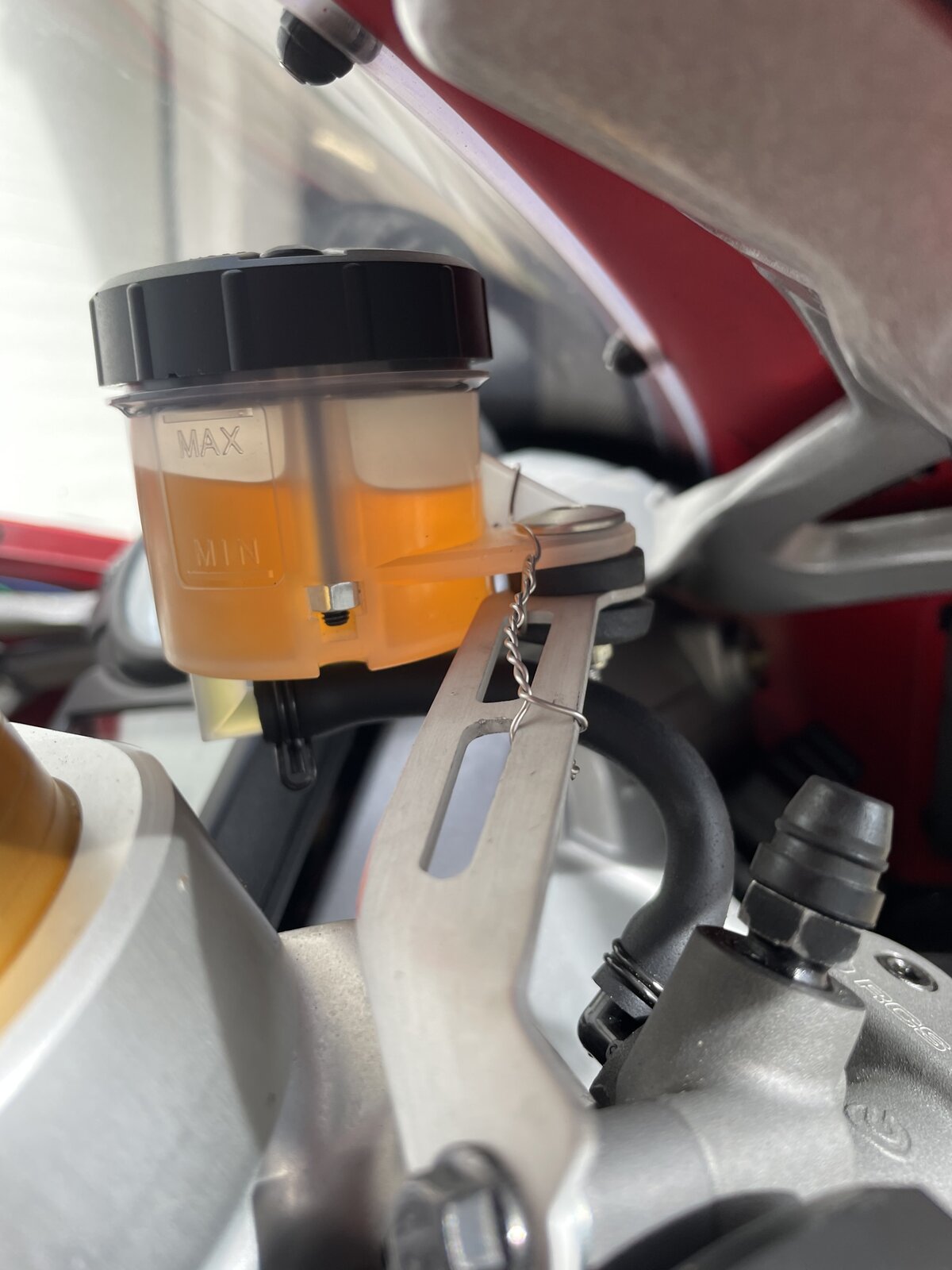

  3. I also ditched the clutch and brake reservoirs when I fitted adjustable handle bars....I started with the Brembo kits, but thought it looked awful. So this is my latest prototype solution - also the smoke reservoirs and clear Tygon tubing looks a lot nicer.
    Obviously make sure the pinch bolts still torque up correctly to grip the forks. I didn't want to drill the yoke/triple clamps. Keep an eye on fluid levels as the reservoir is smaller than before. It all bleeds up fine and I've done track days so no overheating of the fluid.
    I'll make better brackets and source some neater dome head bolts and nuts for the final finish

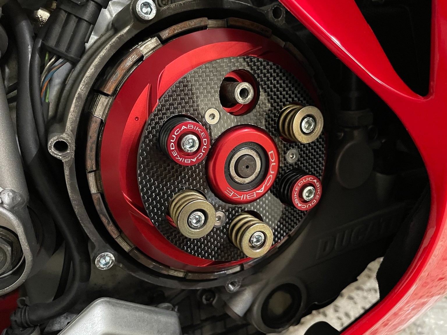

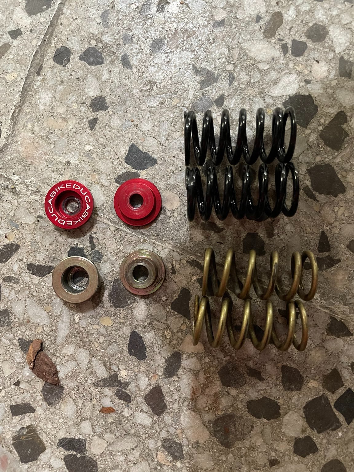

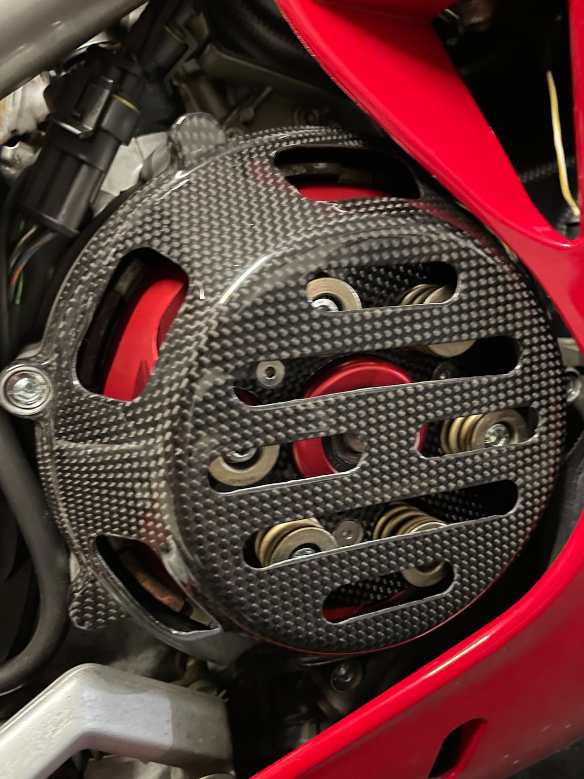

  5. Replaced the existing clutch pressure plate with a "vented" Ducabike part. The vented bit is in carbon and the plate in anodized red.
    Ended up having to move back to my previous heavy duty springs because Ducabike springs would compress so much that they started to bind and wouldn't allow pressure plate do disengage. Could be (and was) sorted using spacers but it reduced the pressure plate force on the clutch pack.
    The heavy duty springs are thicker and require different spring caps with narrower inserts:
    Kind of like the look of the heavy duty ones on the Ducabike plate:
    Looks nice me thinks :)
  6. Not seen a pressure plate like that before.
  7. Its just a regular pressure plate made to Ducati Performance specs which has an add-on (in carbon) thats supposed to vent the clutch as the whole pressure plate spins.
    More details on the Ducabike website.

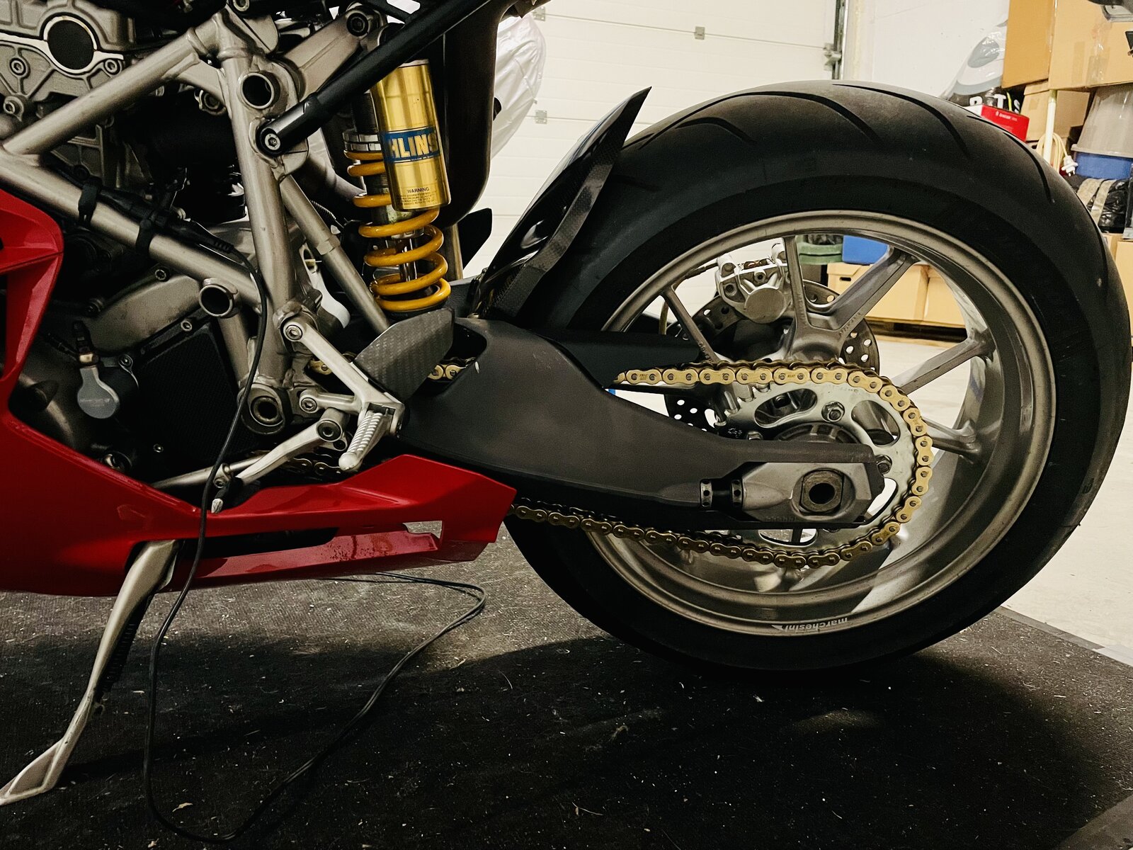

    Also changed the final drive ratio to 15/39 (up from 15/36) and gone with a gold on gold chain because well, we all know gold makes everything better! :joy:
    The rear steel JT sprocket is temporary as it weighs almost as much as the bloody chain and due to damned Brexit, getting parts from the UK (B&C Express) means import duties at customs.
    When the opportunity arises it will get replaced by a Renthal of Afam hard anodized rear sprocket.

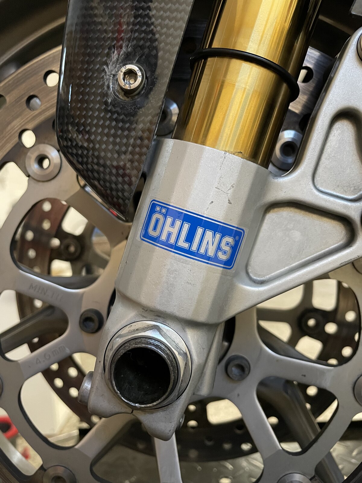

  14. I had to replace both Ohlins stickers on the forks because one was missing and I never managed to get anything off eBay that matched the OEM darker blue, it was always the more modern lighter blue Ohlins logo.
    As I like to do things right I never gave up looking and I recently came across a place in Germany (mcet.de) that sells the earlier darker blue logo. Looks right now:

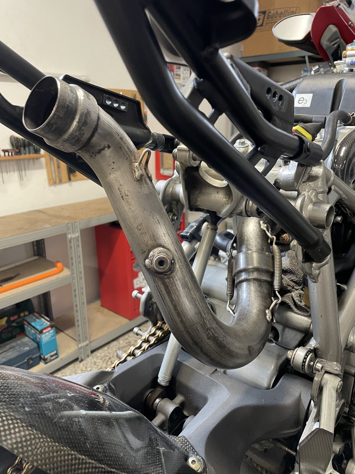

    Also went to town on the headers with some Harpic and as a matter of course also replaced all the exhaust manifold gaskets and nuts. Naturally the horizontal manifold nuts were rusted on so replaced all four spigots.

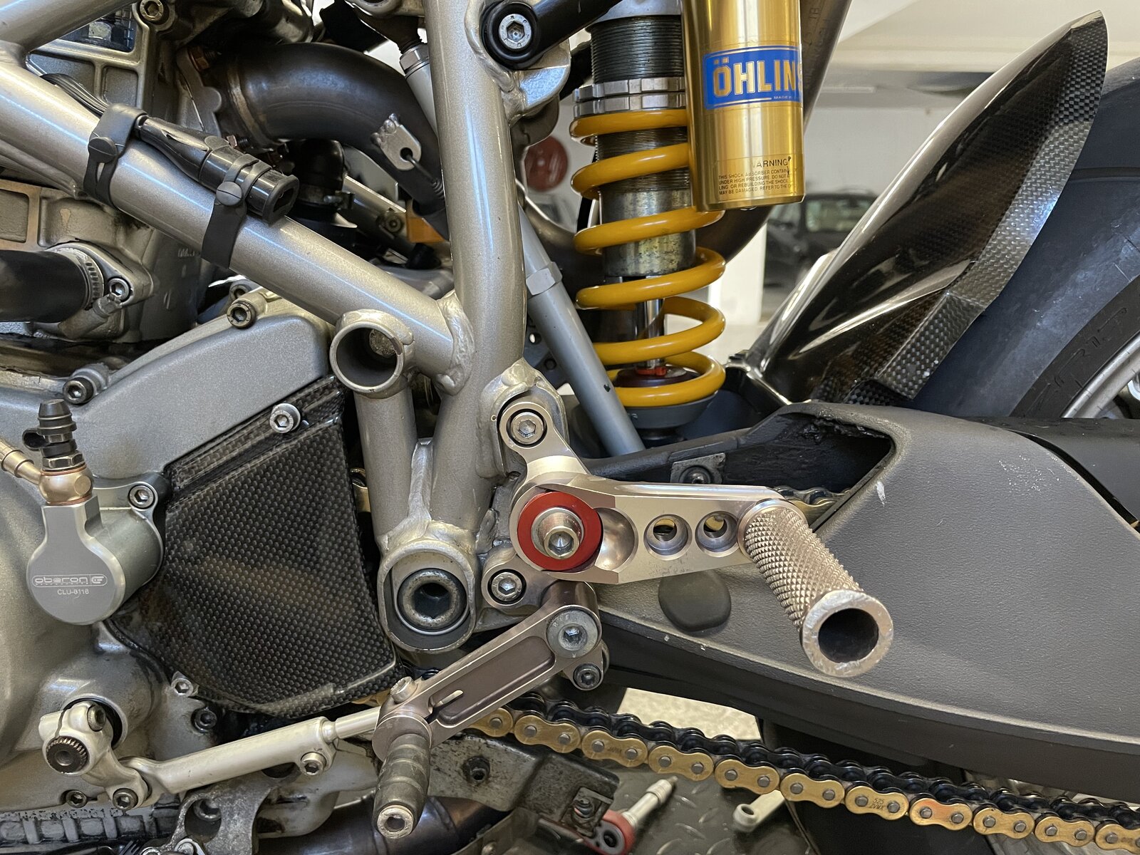

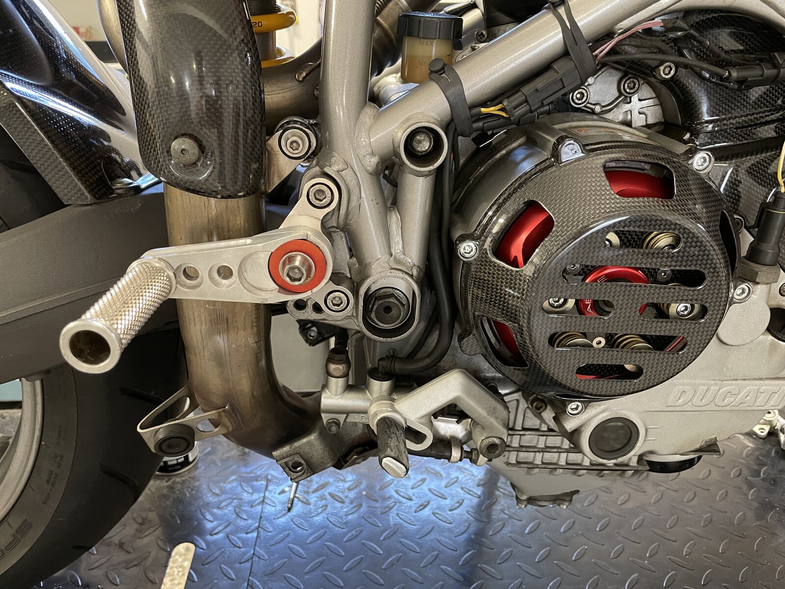

  15. Latest bit of kit is supposed 999RS style rear sets, so far much grippier than OEM

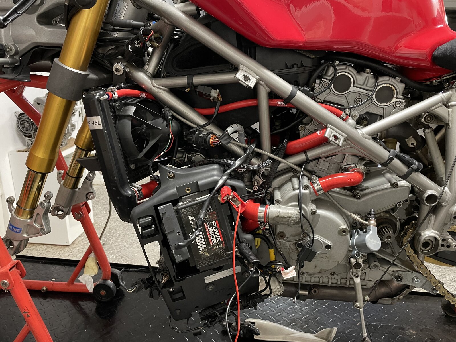

  16. Samco hoses + clips fitted!
    Those with an eagle eye will also spot the Power Commander :)
  17. Cycle Cat rearsets? They look similar… I had them on the 998S for a while and are quality kit.

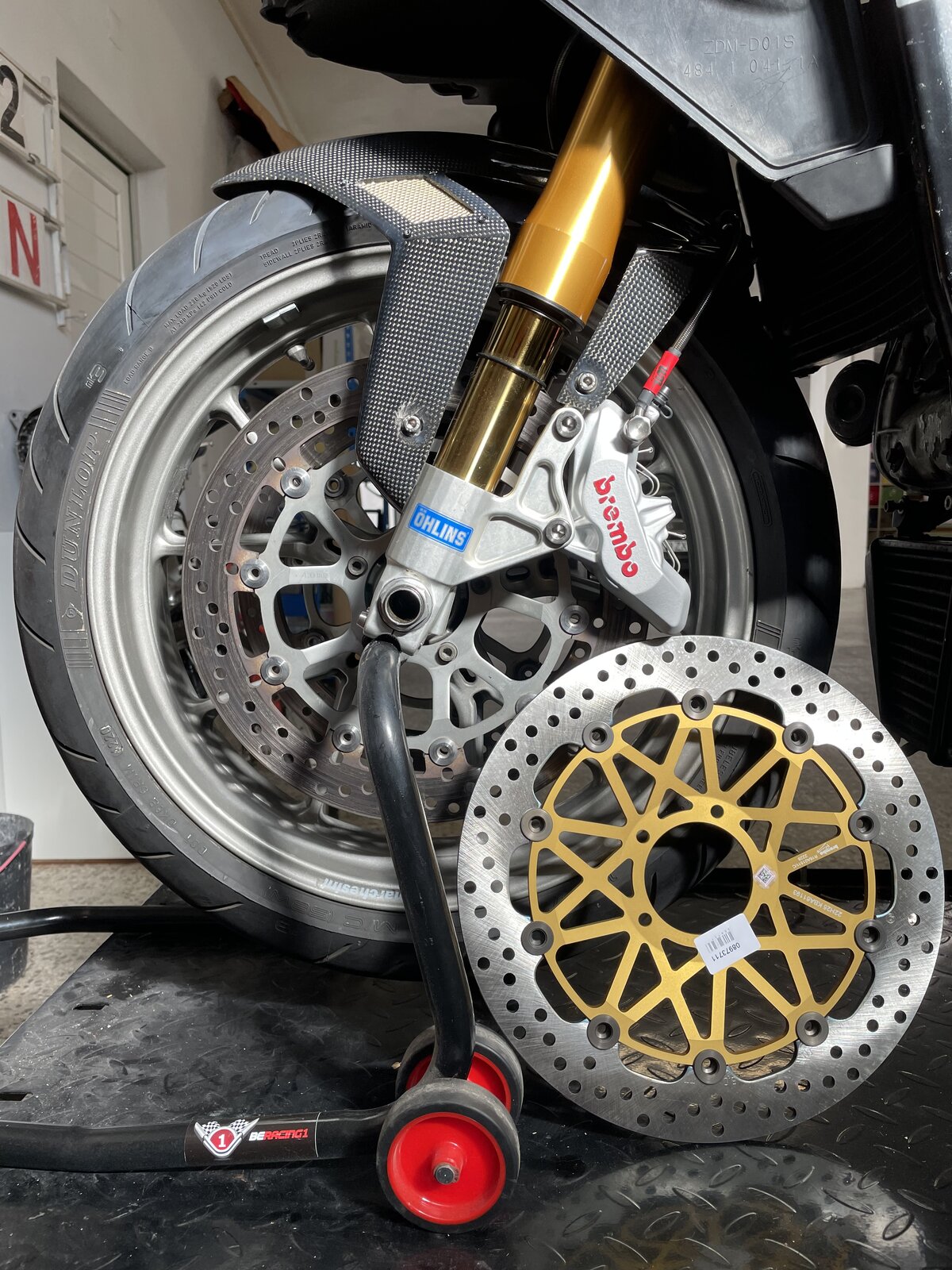

  18. Cerakoted callipers in Titanium colour with red Brembo letters, looks awesome!
    Will look even better once the Marchesini M10RS arrive in gloss black and I can fit the Brembo super sport floaters in gold!
  19. Loving the discs!
