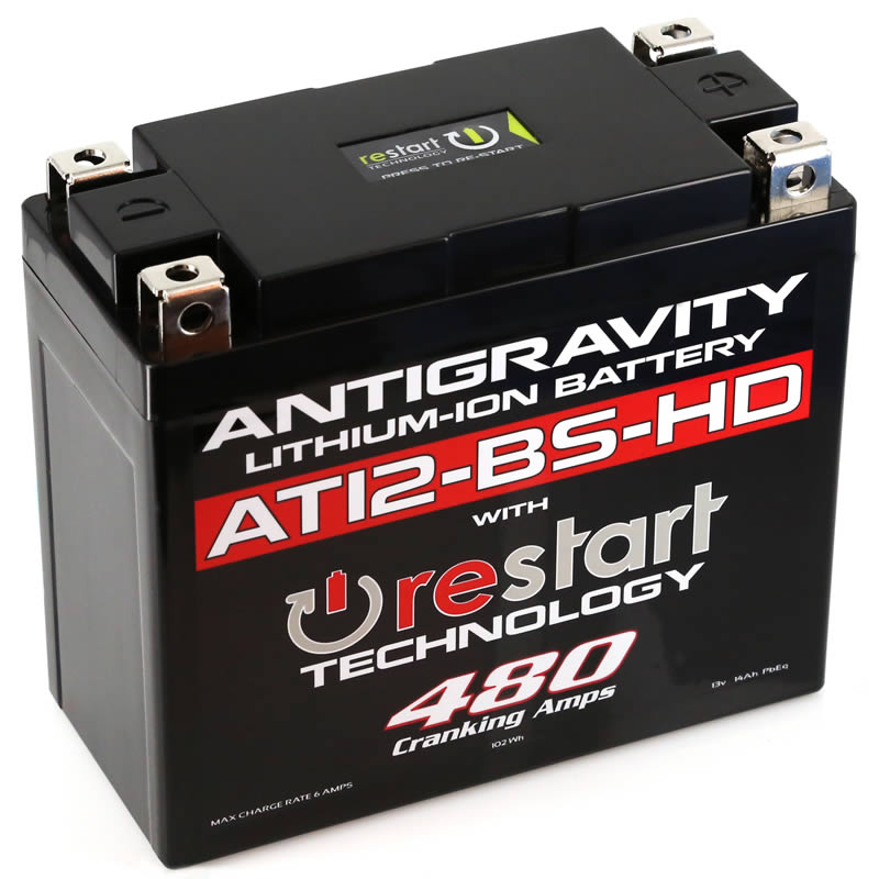

    just my 2p
  5. Thread moved
  6. Fucking hell...here we go again....
    • Funny Funny x 5
  7. And you can get higher than standard cranking amp Yuasa batteries now too...
  8. Not even considered it after fitting the cable kit tbh....the difference is (as you know) night and day, its gone from "Oh God please start" to full confidence it WILL start....:)
  9. Oi - less of it you!
    • Lock Thread Lock Thread x 1
  10. Got a link to the cable kit?
  11. I bought a Lithium Battery for my KR1000 Replica :bucktooth:
    • Face Palm Face Palm x 2
  12. And?
  13. I will be building the electrics to cope with it, unlike some earlier Ducati's that can self combust :bomb:
  14. o_O :bomb: :skull:
  15. Pro's:
    Double the Cranking Amps
    6~7 lbs (or aprox 3kg) weight savings....located at the top of the bike!
    Conserves power longer
    Longer life
    Con's:
    Cost more (offset by longer life)
    You'll need a new Lithium Tender
    Cold start issue is a non-issue. Even without a wake up, the big 480 CA that fits the Multi (AT12-BS-HD) starts it immediately at 1°C.
    However, at that low temperature, you should have the lights on for a minute or two prior to pushing the start button. You don't have to do this for the remainder of the day.
    Bought one for the Panigale. One for the Multistrada and looking at getting another to replace the OEM Yuasa for the Monster.
    It's a no brainier. Just get a Lithium when the time comes to replace your battery.
    There are many good brands out there but knowing that I ride in our cold weather Fall season, I particularly chose this one for its low voltage reserve.
