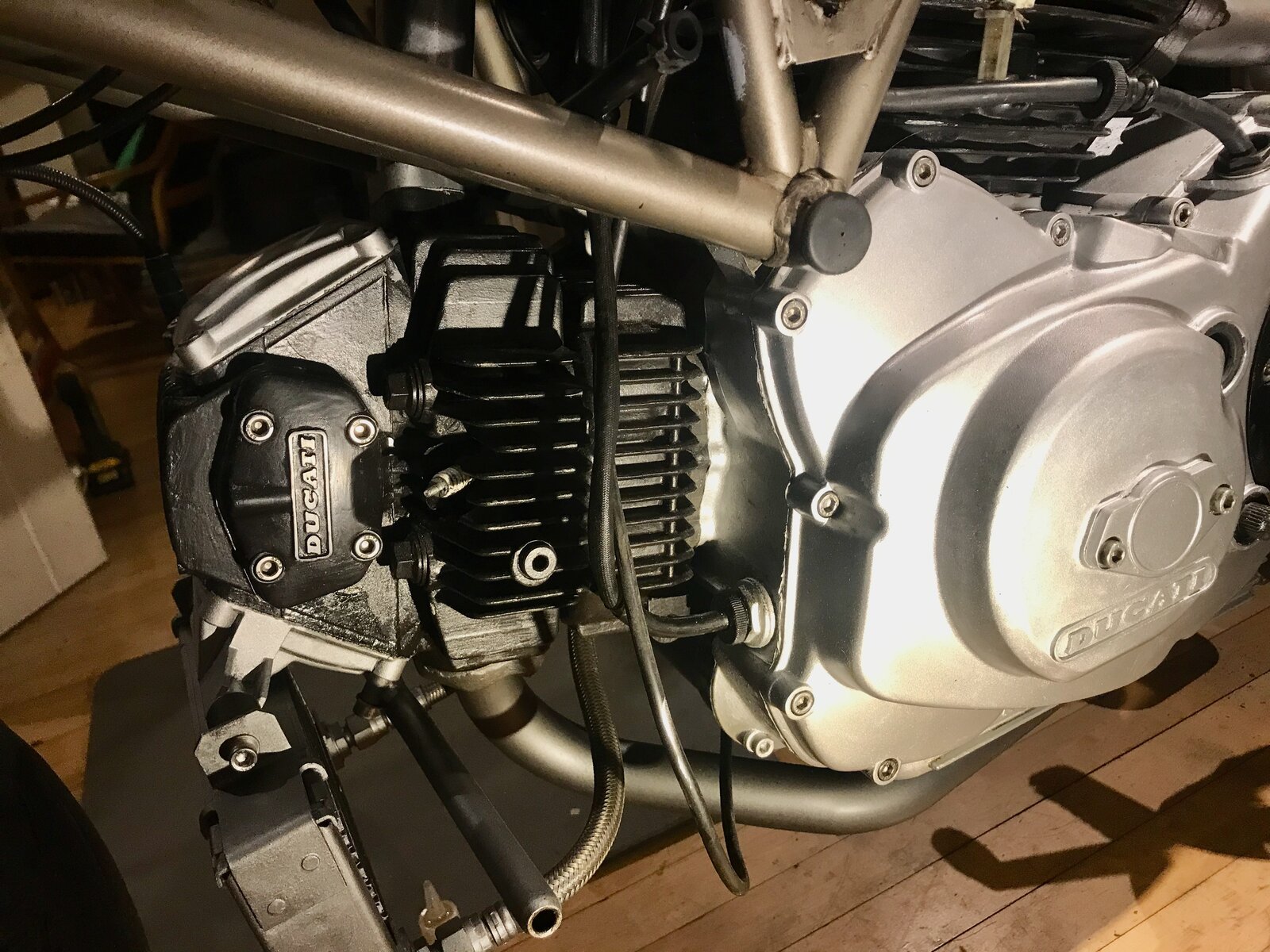

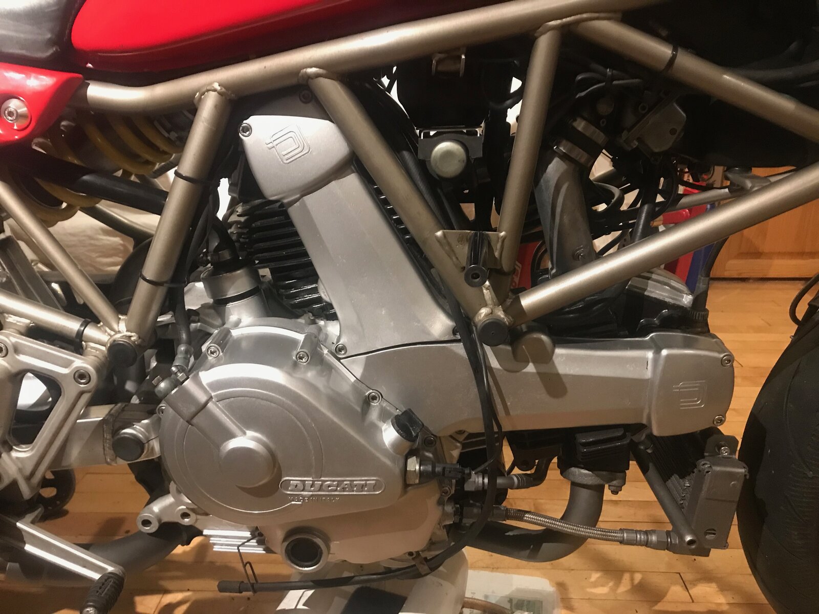

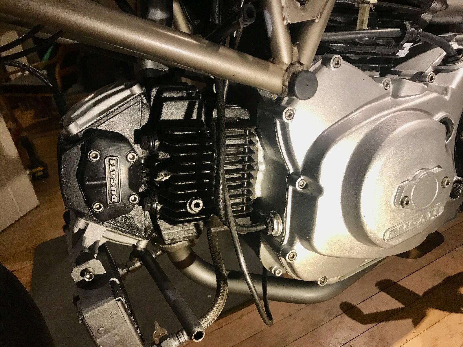

  14. Just restored my 750SS engine as the poor finish had been annoying me ever since I bought it. Problems with flaking paint and light corrosion.
    Degreased engine, then cleaned everything up with wire brush, stainless steel pot-scourer, and sandpaper/wet and dry paper. It took many hours! The side casings and cylinder fins were the worst. I didn't get all the paint off as this is almost impossible to clean the nooks and crannies without blast-cleaning, but you do need a sound base to work on.
    I left the engine in-situ, but removed everything around it, including carbs and exhaust, and took off the clutch and alternator casings, plus cam and cambelt covers, cleaning these up on the bench.
    Paints used as follows:
    Crankcases brush painted with Car Plan Silver Engine Lacquer
    Cylinder barrels and heads brush painted with Granville Satin cylinder black.
    Side casings and cam covers rattle-can sprayed with Simoniz Steel Acrylic Wheel paint and lacquered with U-Pol Gloss lacquer
    EDIT: Please DO NOT use U Pol lacquer over any acrylic paint! When tested, it seemed to cover fine without reacting. But only for a few days. Give it a week or two and it starts crazing over. I had to sand down and re-paint both side casings.
    Exhaust and oil cooler painted with rattle can E-Tech Graphite VHT.
    Came out pretty well, but I may repaint the cambelt covers in a dark grey as I'm not sure about the silver finish.

    #16 Wheelnut, Nov 22, 2020
  15. Forgot to mention, all the allen bolt fasteners were replaced with stainless. Cheap and easy to do.
  16. Looks good, think you’re right about the belt covers.
