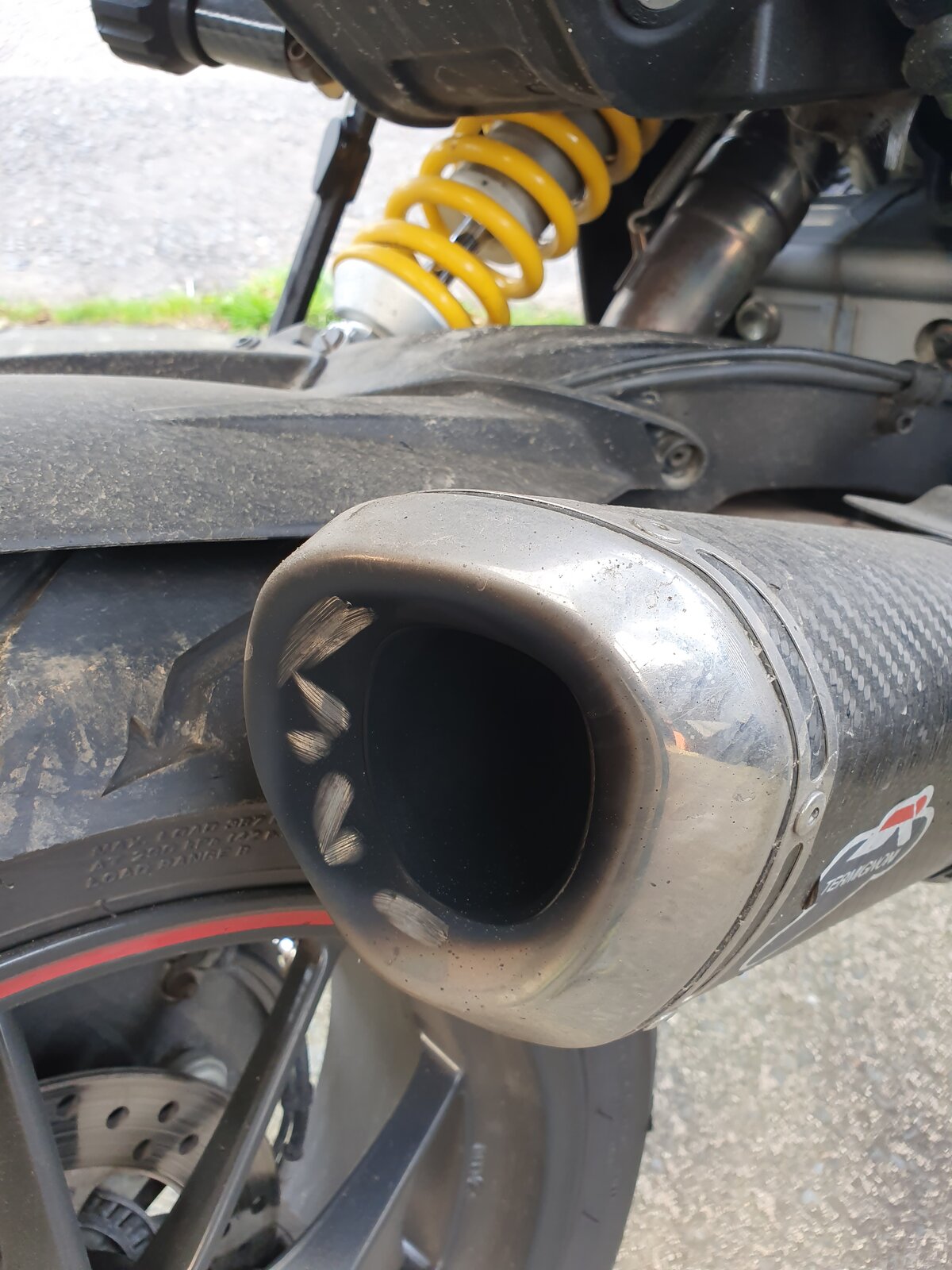

  1. Hi guys/gals, have recently returned from a trip to France where the bike was experiencing fuelling issues; intermittent jerkiness at constant throttle motorway speeds, hesitation when accelerating, significantly reduced fuel range, and difficulty starting on the final day. Noticed a sootiness on the exhaust tip when I got home (as per pic). I assumed bad spark plug or coil.
    I changed the fuel filter last week when waiting for replacement plugs as I had the bike stripped and low and behold it wouldn't start afterwards. Then changed the spark plugs and still no luck getting it to start. Tested both spark plugs and they are sparking so doesn't appear to be ignition related. Battery is fully charged and I boosted it with a jump starter kit when cranking just to be sure. Have checked fuel lines and connections. Fuel pump appears to be priming. Bike cranks but doesn't catch. At my wits end and have no idea why it isn't starting!

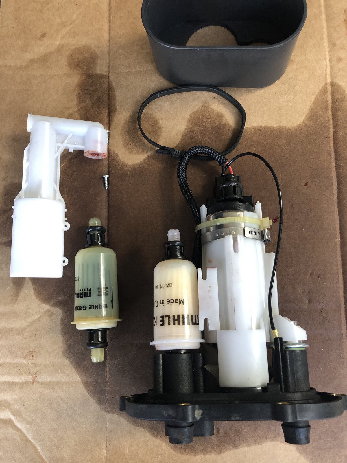

  13. Just because it's priming, doesn't mean it's reaching its destination. You have spark, you have air... No fuel
  14. Apologies I should have closed thread.
    Problem was caused by a small rubber seal not seating correctly causing a blockage in the fuel flow.
