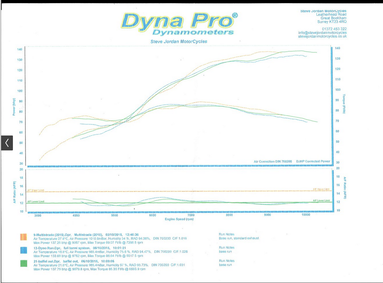

  7. The slip-on is eye candy only as the sound is dictated by the mid-section box. As for the full system, the question becomes, do you want a loud bike for touring?
    Moreover, the UP-Map is known to add marginal power in the mid-range at the expense of detracting max power.
    Dyno Chart:
    Screenshot from 2020-02-18 07:28:45.png
    Topic thread:
    https://www.ducatiforum.co.uk/threads/dyno-comparison-standard-v-termi-exhaust.37412/
    What you're getting with the Termi are decibels and weight savings.
