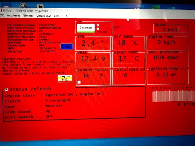

  7. I've connected the Lonelec cables to the ECU and the software seems to be functioning ok. Unfortunately, the software won't allow me to copy the ecu details.
    I take it that all i now need to do to complete a TPS reset is to press the TPS reset button in the tests/reset dropdown menu? My current TPS value is 2.3 - 2.4.
    What should I expect it to be after the TPS reset process is concluded?
  8. PM me the serial number of the ECU (looks like 5F+F3FU3G in your picture?) and an email address so I can send a licence.
