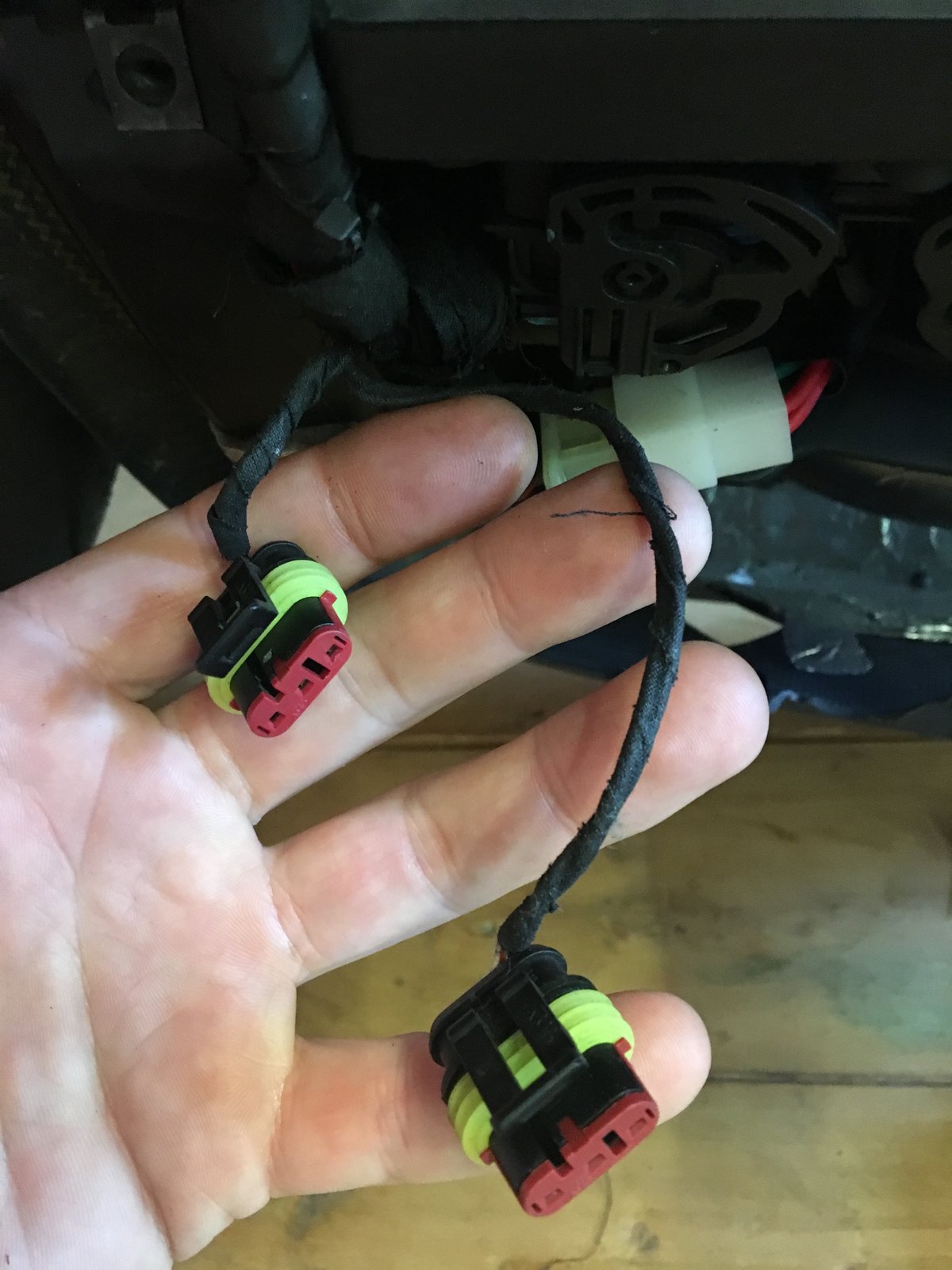

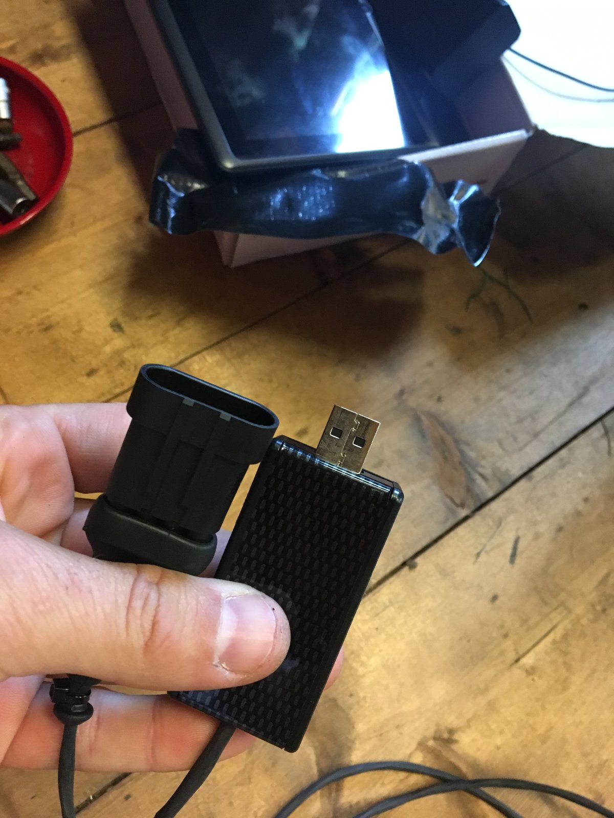

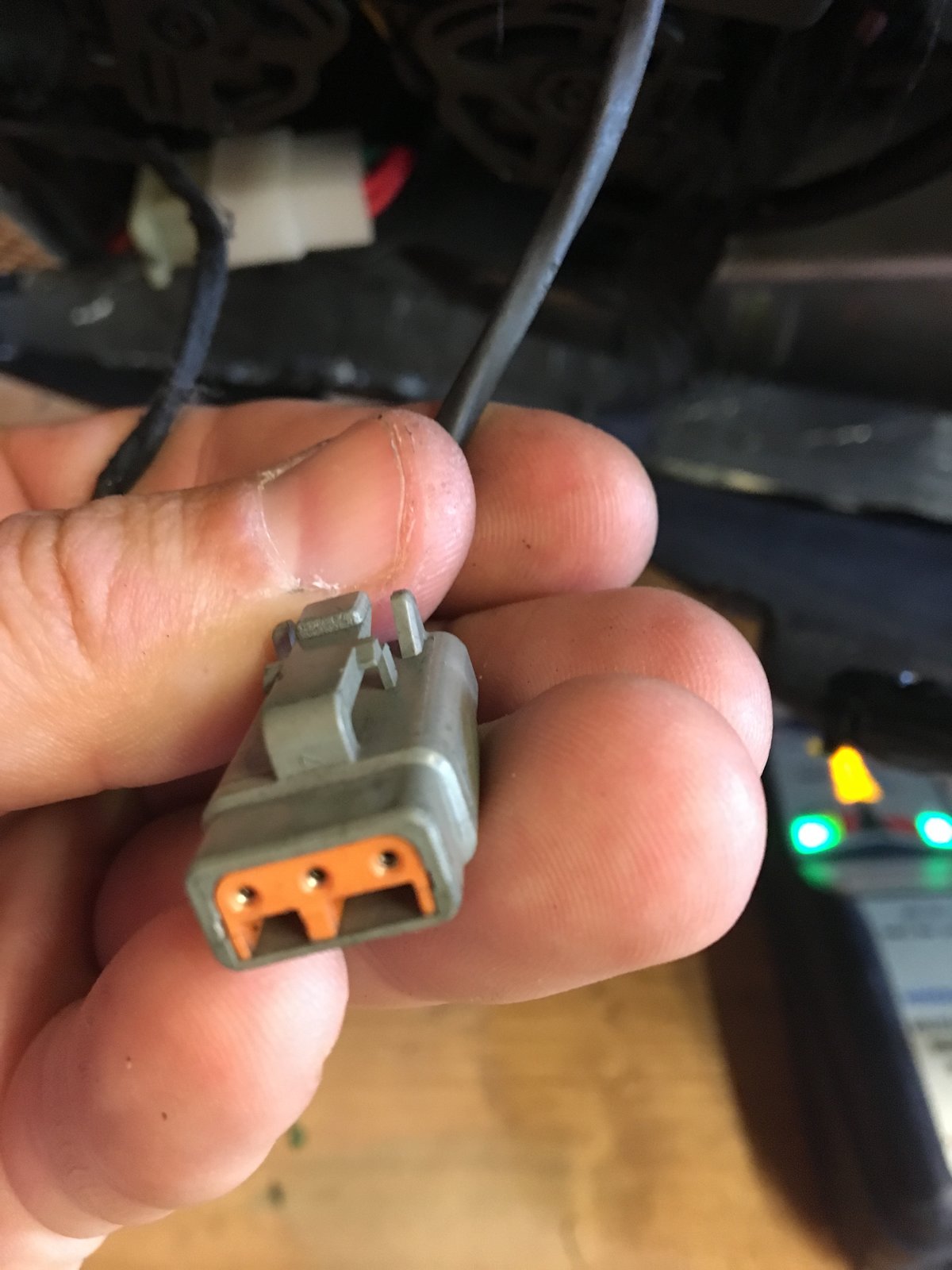

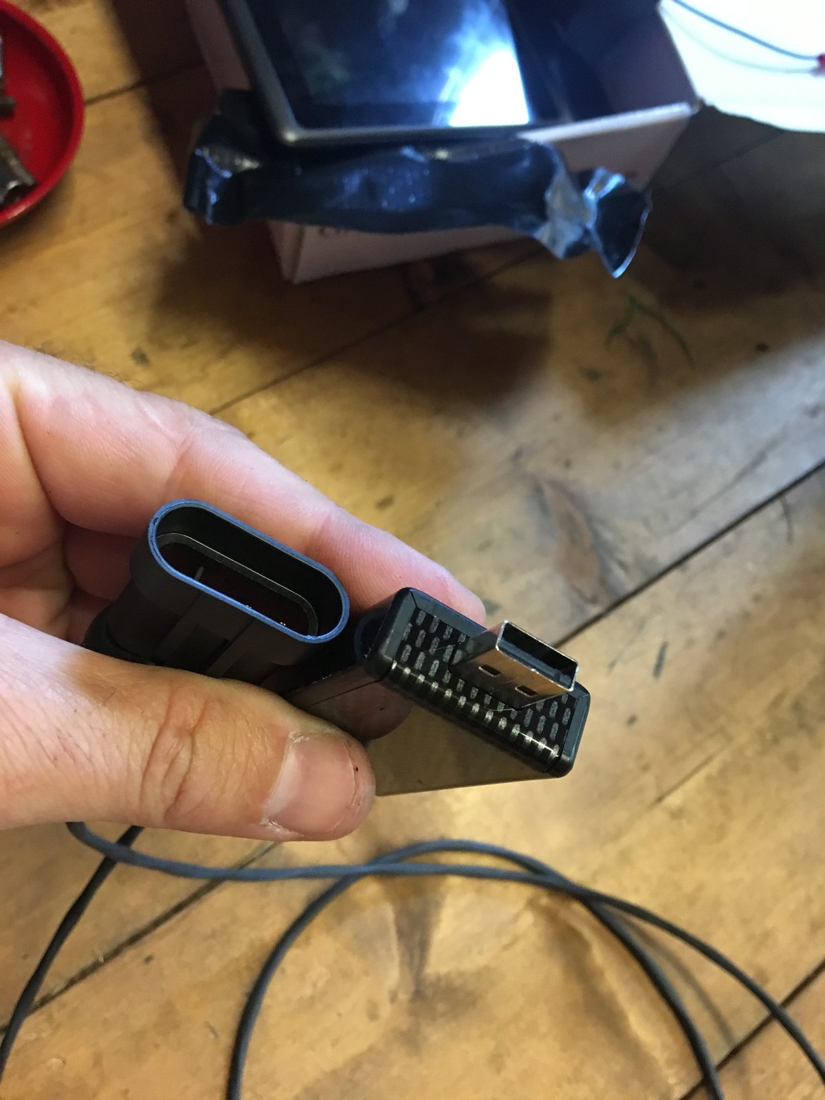

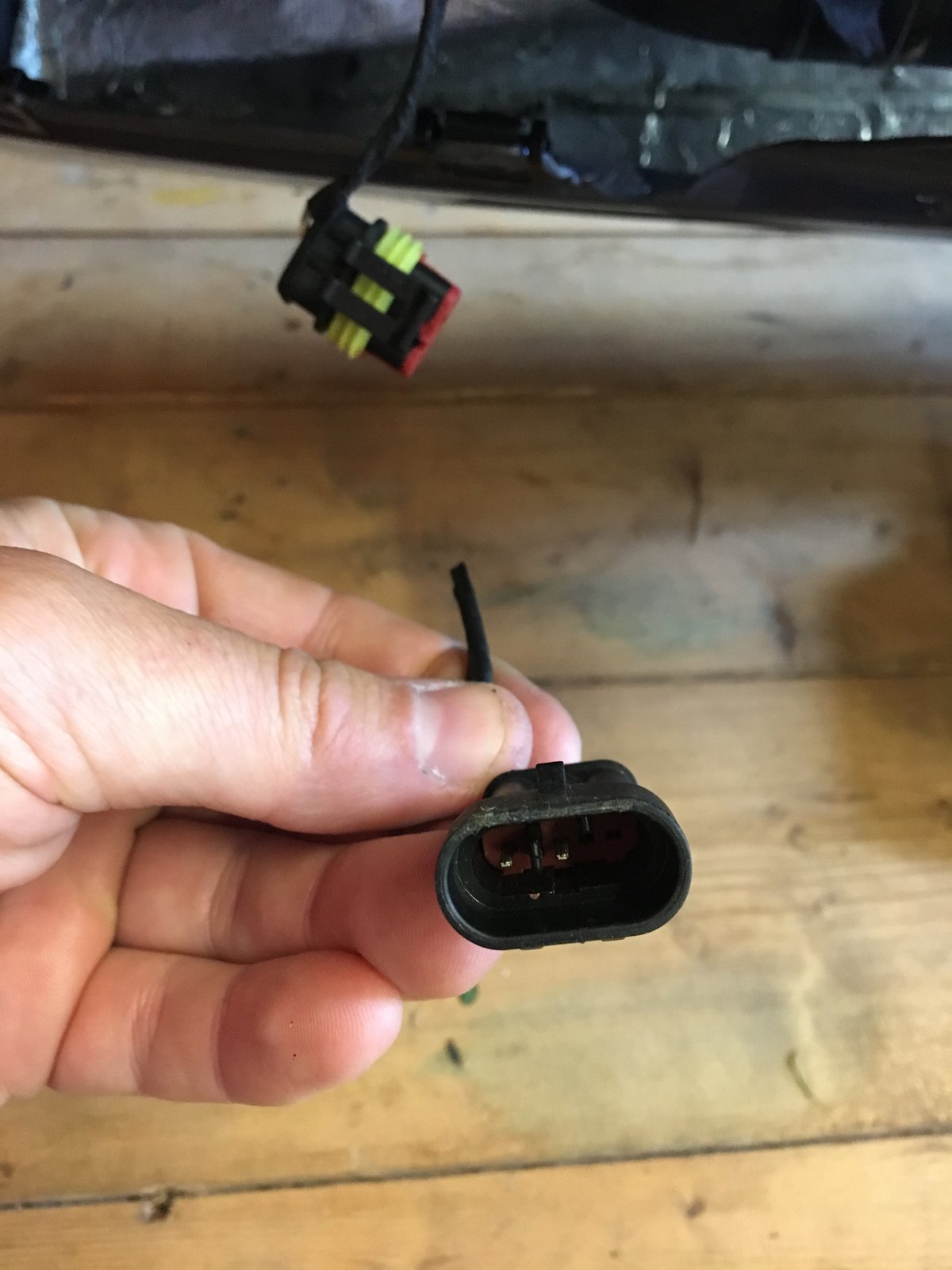

  3. So, anyone know how to talk to my Ecu, please? What am I doing wrong?
  4. The USB lead with the 3 way male Superseal connector is the programming lead for the TCS

  8. I've managed to get hold of a cable but I cannot for the life of me seem to get hold of the ECU software. Everywhere has the TCS software, but not the ECU one (including a couple of people who list it as available). Does anyone here have a copy they could share/ upload/ something else I could have in return for some lovely gratitude and or sweets or cash or oh I don't know whatever you'd like? Please?
