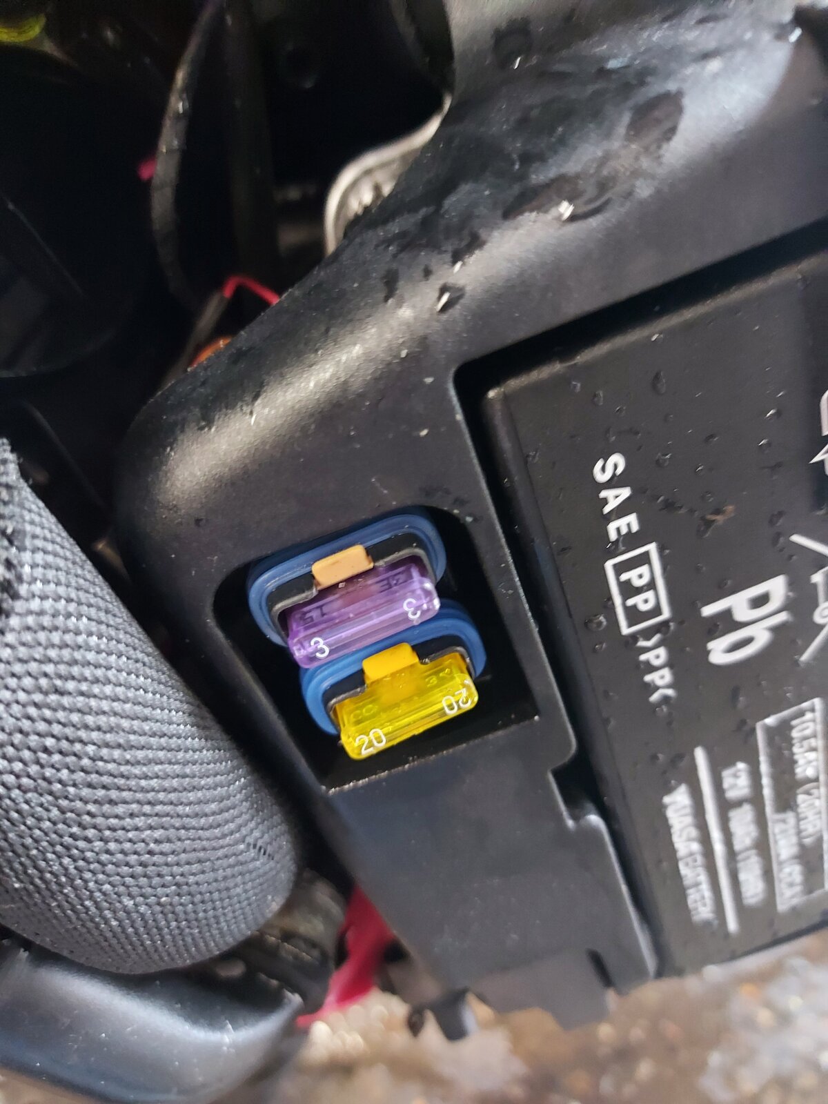

  7. What dies the yello fuse do as that replicates the problem if I Pull it
  8. The 3 amp protects the ECU
    The 20 amp protects the injector/coil/pump relay (the one in the battery box)

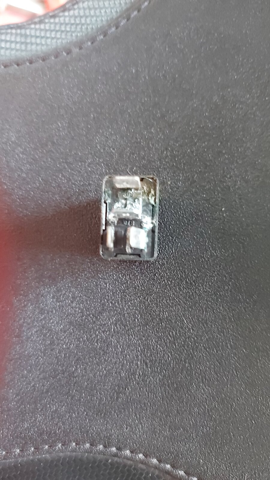

  10. So pulling that is the same as the relay failing? See pic above looks toasted to me? fingers crossed

  11. Common problem covered multiple times on forum. A 3 quid part that causes no end of problems. Buy some spares and make replacement part of servicing schedule. The relay can be relocated to the top left of battery box. There is even a rubber fixing for it to go into.
  12. Seems good so far!
  13. Thanks for the help and taking the time to answer people much appreciated
  14. So, does it start now?
  15. Yes been out seems fine, it started when I got ihome to be fair, but if I pull the relay it acts just like it did so fingers crossed that relay was the issue
