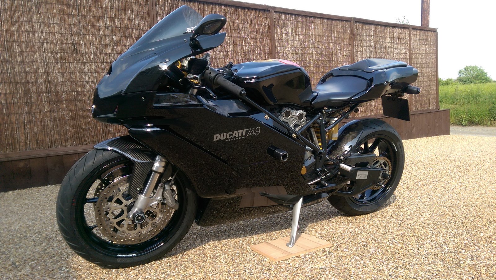

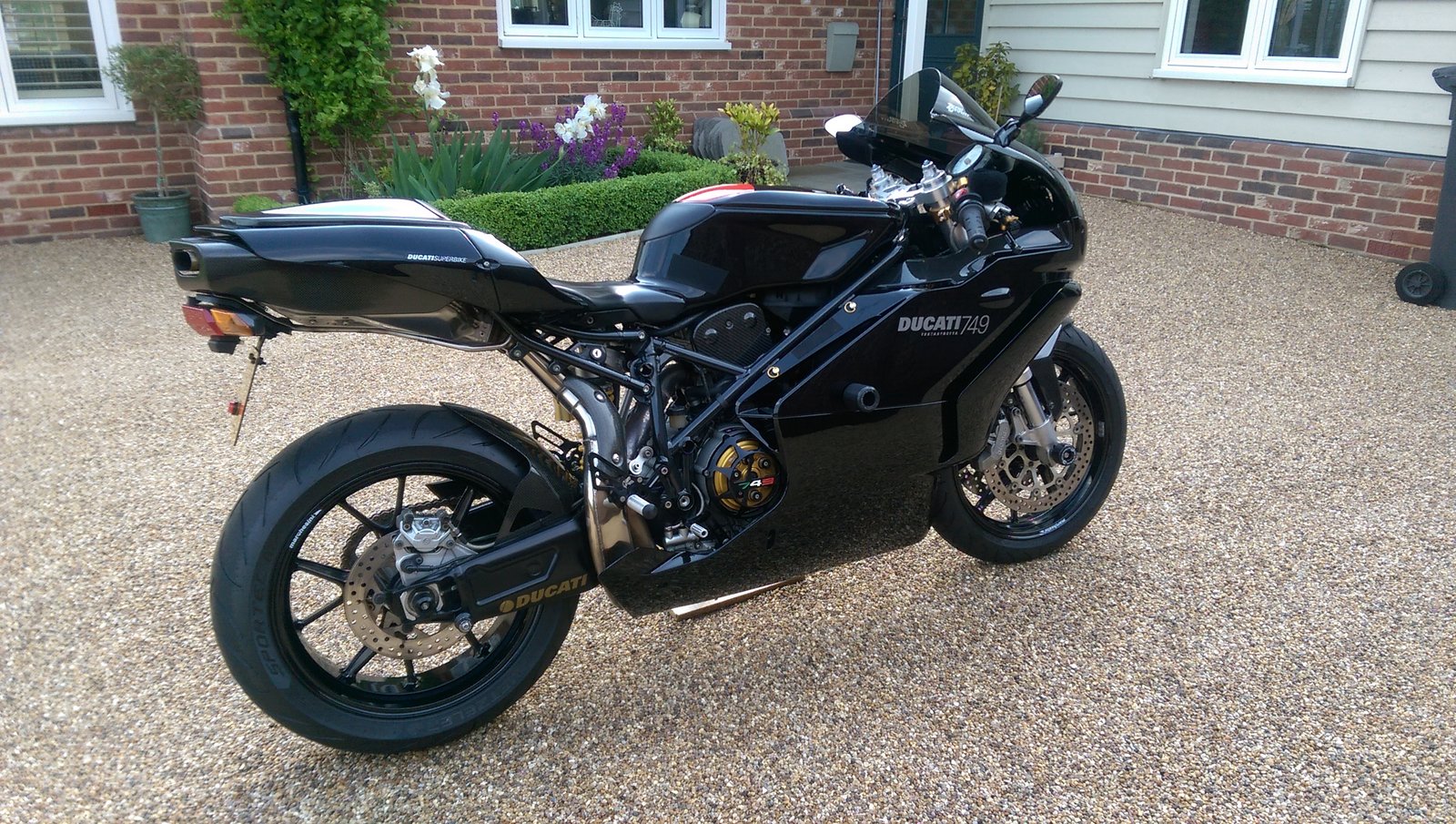

  1. I'm very torn on this - my gloss black, 2006 @ 18.5k mint 749 is totally sorted, carbon everything (pretty much), levers, screen, mirrors, full r& IMAG0793.jpg IMAG0788.jpg IMAG0793.jpg IMAG0788.jpg g's, hugger, rear sets, full termi, translogic quick shifter, qr filler cap, new tyres etc...but, it is starting to make me ache somewhat after riding!!
    So, an inkling is in my mind to sell, although after all the effort (and cost) of getting the bike as is, it's not an easy decision to make. Pics added to help - any ideas of what a fair price would be?
