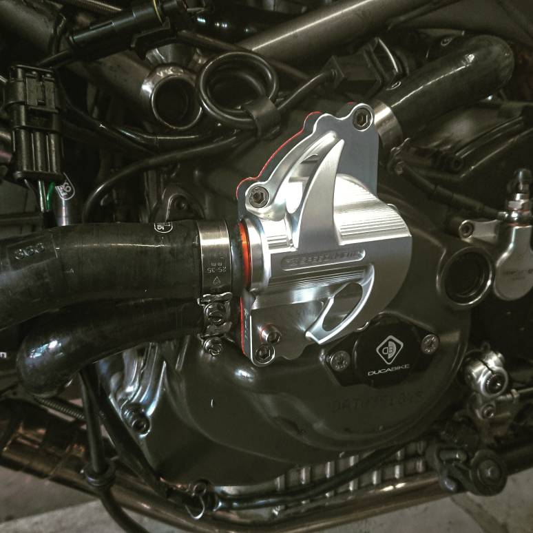

    Fitted a new billet water pump, increase the flow and efficiency of your cooling system, Acts as a heat sink, netting up to 10% cooler running temperatures compared to the stock housing, similar to R&G its designed to provide protection incase of a spill, not a bad thing to have on track

  9. Looking good mate! Bike looks superb as always!
    Out of interest, where is the billet water pump from? It’s got to be worth a consideration
  10. Thanks
    You have two options SSR or mine , speedy moto
    I choose mine based on design over SSR nó other reason
    The bike does run cooler now especially in traffic
  11. Lovely bike (needs an 853 engine though ;)) but I struggle to understand how a water pump can spin and so cool water, any quicker when the engine still turns the pump at the same speed. Is the pump section bigger?
  12. It's bigger
  13. Have you got an oil cooler fitted??
  14. Nope it's a S not a R model
  15. I still struggle to understand how the pump cools quicker. The coolant channels are no bigger in volume and the pump still spins at the same speed. Not being argumentative, i would just like to understand how it works as the idea of better cooling sounds perfect for mine too.

  17. it acts as a heatsink, will also aid in cooling , not too sure if it is more efficient at flowing the coolant but it definitely does not run as hot, I am sure the fresh coolant and maybe my water pump was tired, might also be a factor
